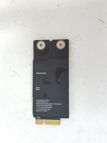

Have installed part number 607-8968 but its not detected in Big Sur.
should the WiFi element still be detected even without the usb d+/- cable connected to the BT port?
rechecked all connections, and everything was ok, maybe I’ve got a dud card
That's what I've got too. WiFi works fine, Bluetooth is absent. There's no indication where the problem might be.
I bought a slightly different card with higher AC speed and it is detected fine, just need to attach the Bluetooth antenna extension now. New one is 653-0014
In the end the old one wasn’t a dud card however, as I tested it in my 2012 rMBP.

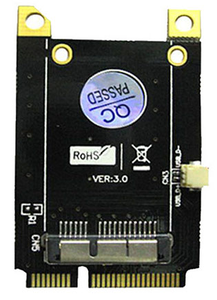

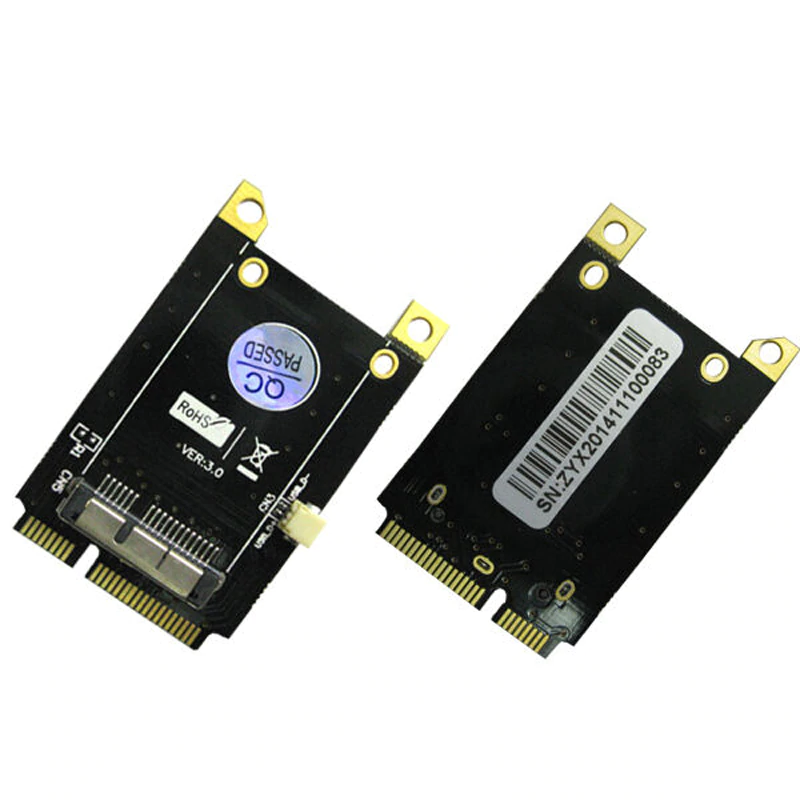

Hi,
I bought this adapter because it looks like the one being used on a handoff/continuity upgrade youtube video.
My question is, does this one works with the Broadcom BCM943602CDP card, even with the usb pins on the other side?
Also, the one that arrived is labeled version 4
RoyL,
I am sure you know by now, but this card doesn't quite work with BCM943602CDP. The convenient white bluetooth power plug prevents the BCM943602CDP from fully seating and laying down properly as it is a full width card and does not have the little inset "chin" of its older brother, the BCM94360CD. I had to remove the white plug with some careful soldering and pliers.

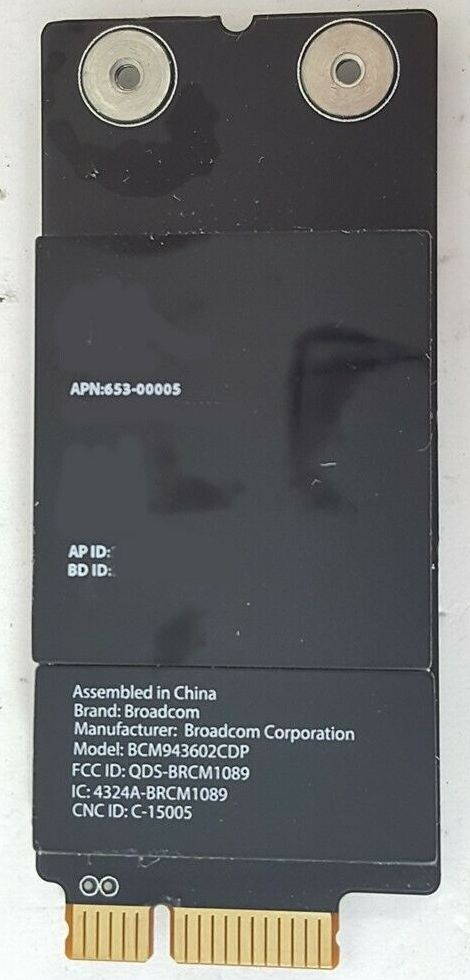

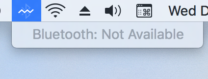

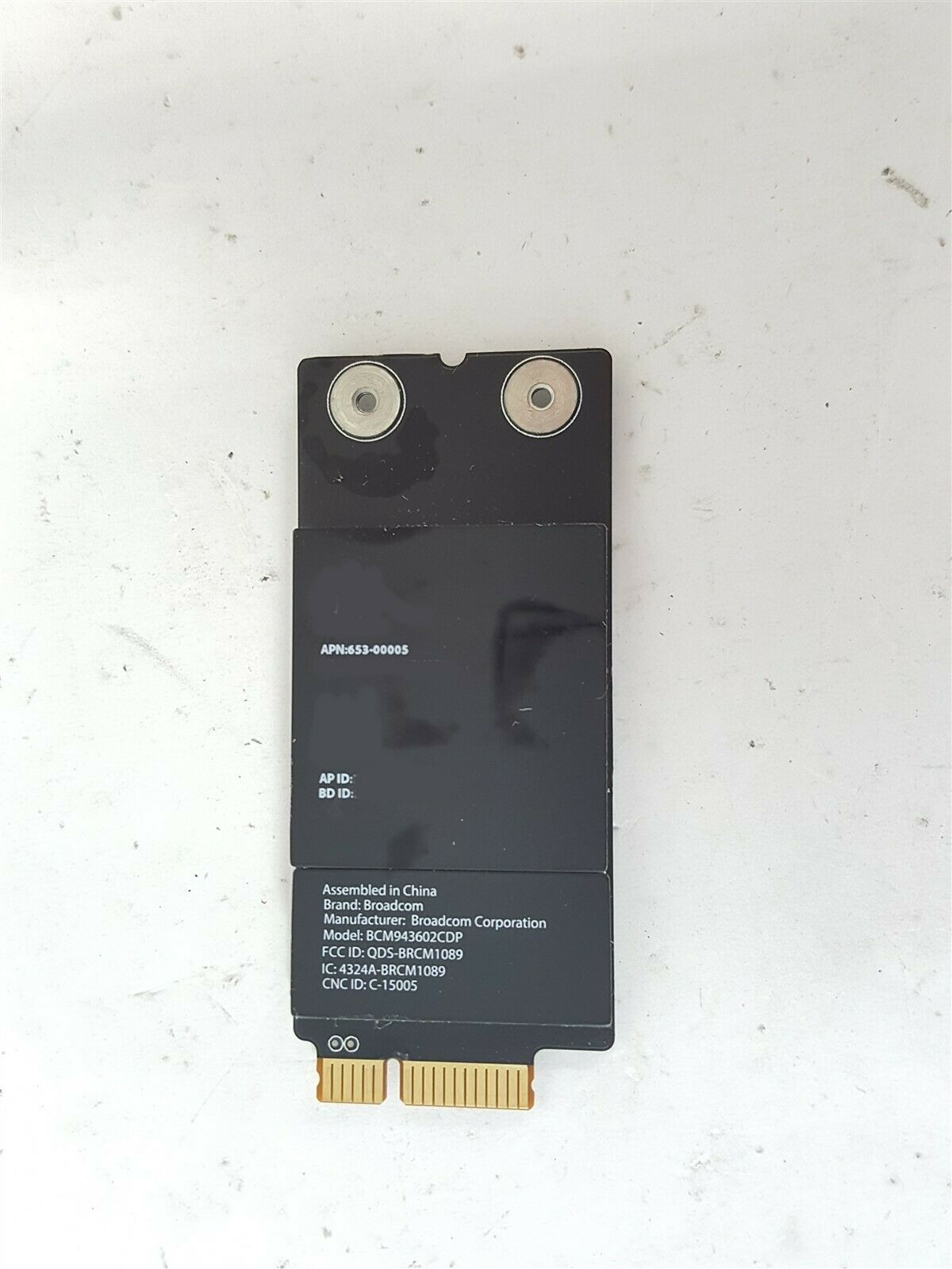

Hi all,
Need your help! I have the BCM943602CDP installed in my 2009 Mac Pro.
Everything works great, but when the Mac Pro wakes from sleep the Bluetooth shows available for a minute and then stops working and becomes unavailable.
If I restart, Bluetooth comes back and works fine. I removed all devices and reset the module, I also deleted all the old plist files. Not sure what I should do, but it's a bit of an annoyance. Thanks for your help.

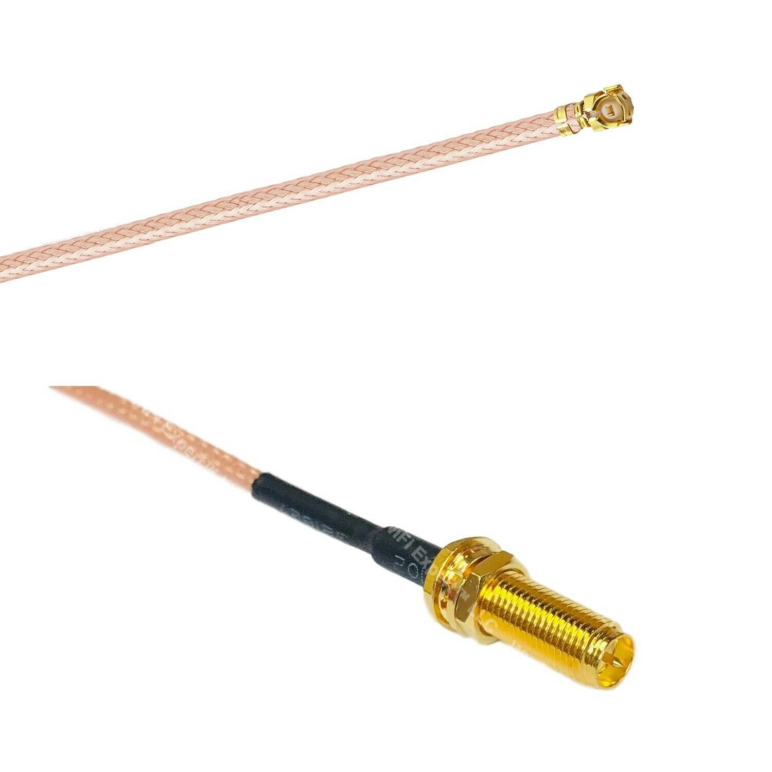

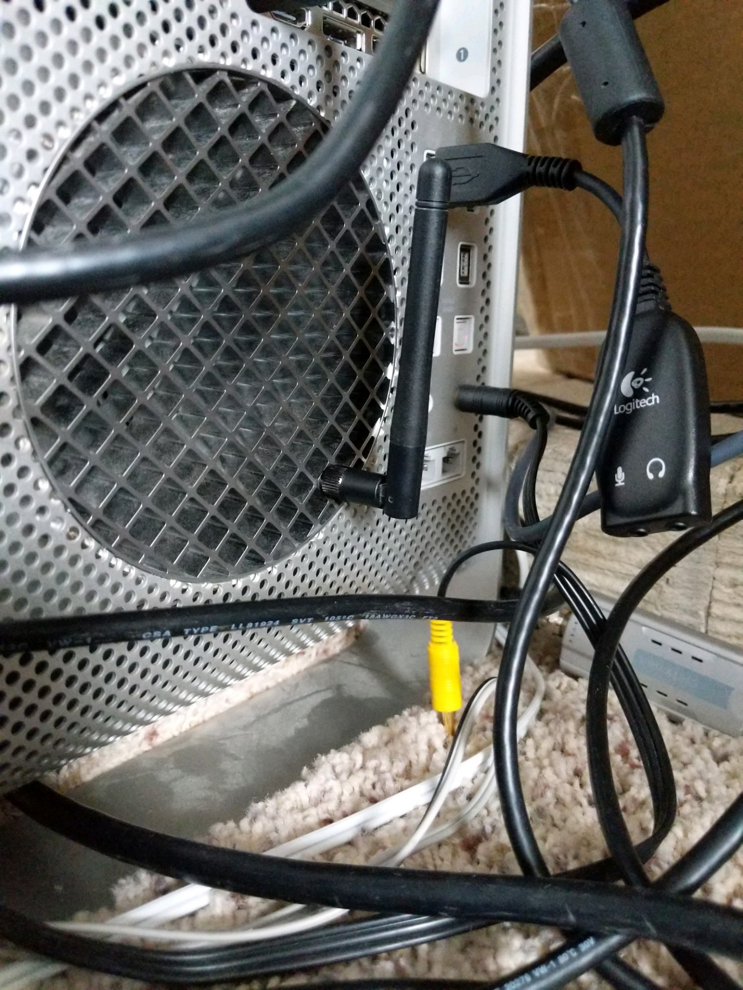

(BTW, I have a neat antenna solution by running a RG178 IPX U.FL to RP-SMA Female to the back of my case through the fan grate!)
Yes, crazy, I know! However, I am getting great signal and range by using this method.
Note: I did have to unclip the exhaust fan and push the top of it in a bit towards the CPU heatsink as the fan would hit the wire sticking into the case.
I used the carrier card below thinking it would be simple. However, the white plug for Bluetooth power prevents the BCM943602CDP from seating and resting properly as it is a wider card. I tried to force it, but ended up having to remove the white plug and solder the wires on instead, (so much for convenience, lol!).
My solder job is not the greatest, but, if everything works when I restart, I wouldn't think that would be the issue.
Can I solder to the R1 pins on this board? If so, which pads are D- and D+?
The reason I ask is, maybe I need to redo my solder job because the pads I am currently soldered to may be a bit compromised from my removal of the white plug???
The screws that came with the kit did not fit into the BCM943602CDP so it is literally just being held in by the tension of the socket and the antennas.
P.S. I left the old Bluetooth card in the machine and unplugged the power/data cable so it shouldn't be affecting anything, right?

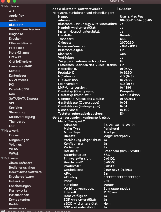

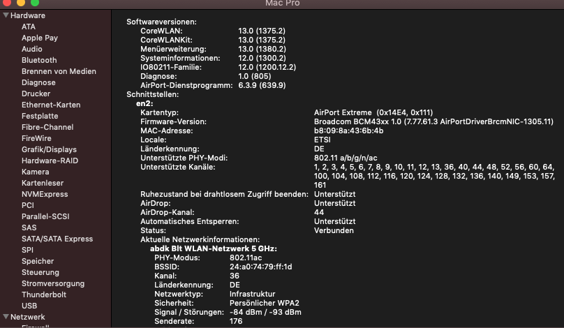

Hi. i have all it do it what i can. installed and i have function with my trackpad and keyboard. but airdrop and hand off doesnt function.
mac pro 5.1 2010 mojave
look at my screenshots. Who can help me please ?
