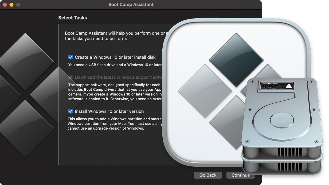

Hey, just found out that the OWC SSD that I have ordered doesn't support bootcamp on 18,3.
Is there any particular reason that this happens? It's still on delivery so I can cancel anytime. Is there a known-supported BootCamp blade available that you guys are aware of?
Yeah, that seems possible per this very detailed how-to video from our rivals friends at 9to5Mac. So no big deal, but I'm really curious as to why only original NVMEs seem to work with BootCamp. My main purpose for BootCamp is to run Yuzu (a Nintedo Switch emulator) and that's not possible as Parallels uses System Memory as graphics (yikes!)
This article may also be of assistance:
