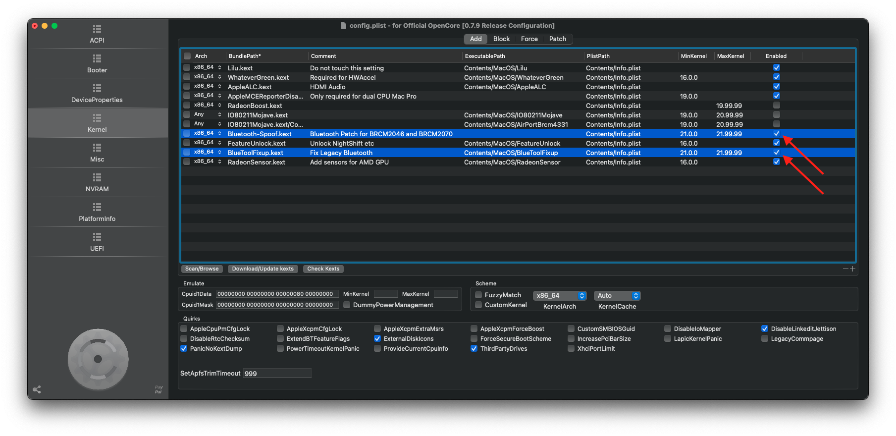

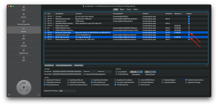

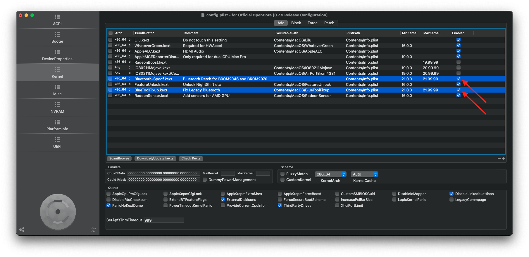

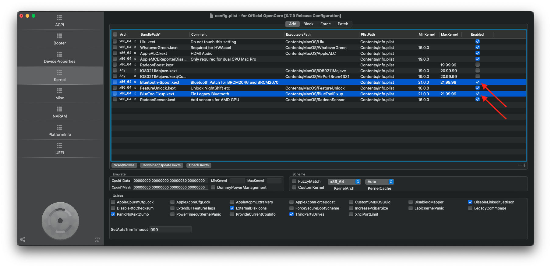

For Bluetooth to work with my USB dongle I have to enable Bluetooth-Spoof.kext and BlueToolFixup.kext
Easy to do with OpenCore Configurator after having opened the config.plist with it:
