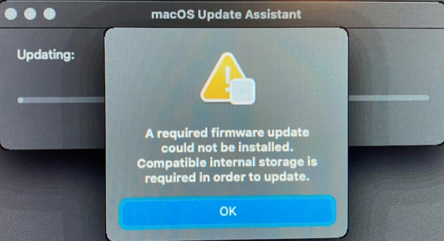

The OC Boot runs fine, it allows me to run the Monterey installer, it gets through it's first reboot (although I had to power it down and pack "macOSInstaller" from OC) and it continued to 2nd reboot. At this point it reboots, partially showing the progress bar, then the progress bar resets and the circle with a slash comes up.
I did a cold power, picked the installer from the OC menu, and then it comes up and says it needs a firmware update.
Now prior to this I watched the "Catalina / Monterey" video about how to turn on VMM Flag and switch off SMBIOS spoofing, but the video didn't have the usual closed captions on what to exactly set and the video is so blurry and moves so fast there's no way to tell what exactly to do, so I am just running your stock build at this point.
Any way to get past this?

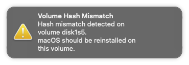

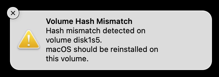

Just got this notification in Monterey 12.2 for my macOS drive:
Anyone recognize it?
Not sure if it was a conicence, but it came up at the exact same time as when I removed the cable from my wireless Apple keyboard which I usually use via Bluetooth. This has been working reliably via Bluetooth when switching between Windows 10 and macOS Monterey, but as of late I have to remove and re-pair the keyboard when going from one operating system to the other. Not sure why.
Found these articles on the topic:
For some other users, the error message appears if they’re running macOS Monterey on an officially unsupported Mac.
Yeah I've had this too, twice. Also use a wireless pro keyboard with numberpad (iMac Pro version), but haven't done anything unusual with that. Updated to 12.3 from 12.2 to see if it would fix the issue, but now my Mac won't boot. No hum...
Damn it! Same here after updating to 12.3. Or rather, I managed to update after changing "Cpuid1Mask" to "on" to check for (find) and install the update. I could then boot into 12.3 fine, but then I switched back the "Cpuid1Mask" to "off" and restarted the computer -- after this I cannot get back into MacOS. Stalls or crashes and restarts during startup. OC 0.7.8.
Tried with the VMM flag set, as some people had success with this. Occasionally it gets to the desktop, but the keyboard doesn't work, so can't log in! Even using a regular RF keyboard.
Might try removing cdf's additions, but keep the VMM flag.
Also tried going back to OC 0.7.7, with and without VMM on, but that didn't work.
Edit: even with just Martin's stock OF 0.7.8 .plist with just the CPUID and SMBIOS stuff spoofed, it's still hanging at boot.
