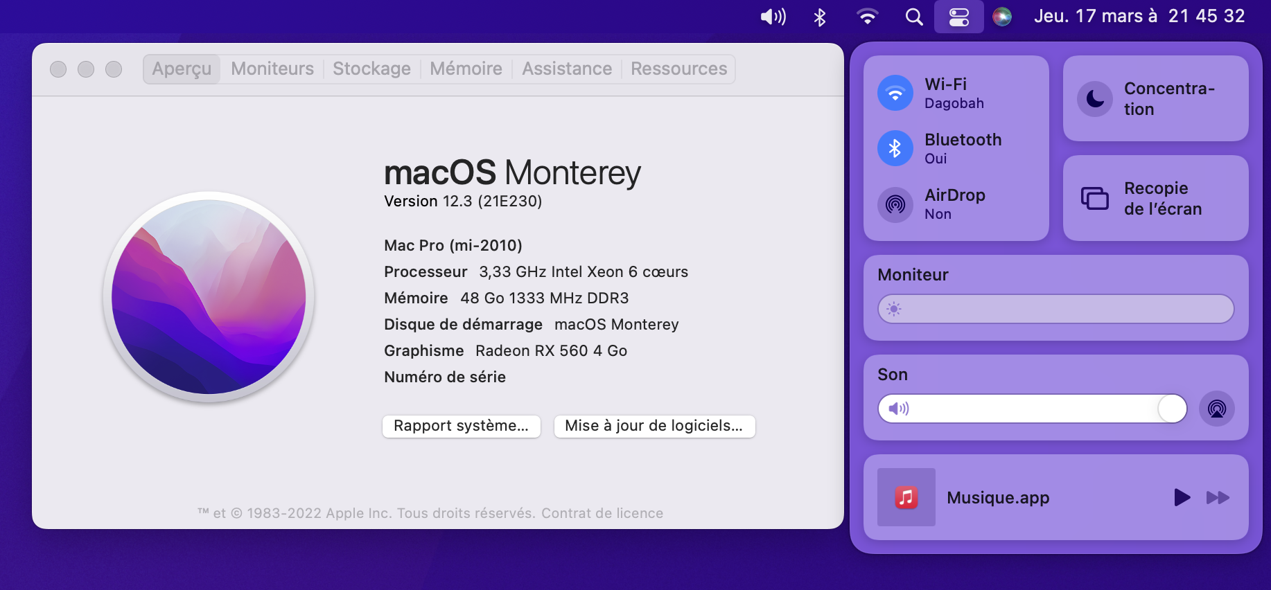

I succeeded to install Monterey on my Mac Pro 5.1 (mid2010) Monoprocessor 3.33GHz 48GB RX 560 4GB using OpenCore Legacy Patcher to create a working EFI boot. I also have upgraded the Wifi BT 4.0 module so that everything work fine with Monterey.
I have correctly installed Monterey with OCLP on NVMe SSD Samsung 980 as a clean installed AND also installed Monterey from Catalina 10.15.7 with the update program :
See :
