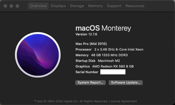

I have installed Martin Lo's OC pkg and it works great - except that my mouse and keyboard both freeze at the boot picker, so I can't choose a different OS. Is there a way to fix this? Been looking all over here but no luck. Also, is there a way to remove the boot picker timeout so it doesn't just load whichever OS it's set to after 10 seconds? Maybe a config file that can be edited? Any help appreciated.
Reactions: Melbourne Park
Are your mouse and keyboard plugged into native USB 2.0 and not a PCIe card? If plugged into PCIe card, they will not work until OS is loaded.

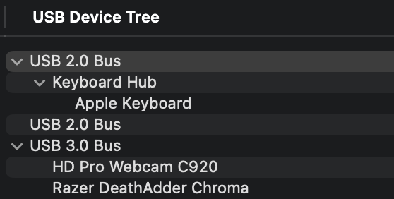

Ok, now for some reason the mouse and kyb don't work in the USB 2.0 slots on the back of the 5,1 cMP. Plugged in a USB 2.0 adapter which got them working, but I remember reading about an issue (Monterey installation?) where the system loses the USB 2.0 kexts in Monterey and only works as 1.1. Sorry if I'm mixing things up, but it's been a while. Is this an issue with Martin Lo's pkg?
Also here:
I Have MLOC Monterey with original Apple aluminum keyboard plugged into native USB 2.0 port and I have no issues. All my other peripherals are USB 3.0

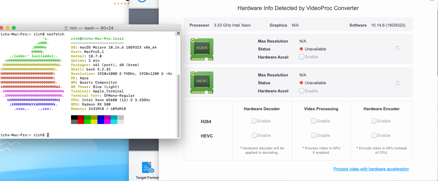

What's the latest strategy for enabling Hardware Acceleration on Mojave? There seems to be a lot of haziness on that subject. The solution seems to be fairly straightforward now on more modern OS's, but I want to do it on Mojave on my 5,1.
@aaronhead14, about the latest strategy tons know,
however I do have Mojave installed on both computers
and just checked with videoproc app, if both have acceleration:
pc1 is 2009/2010 and HAS OC installed with Mojave latest version and metal GPU > Hardware info detected with Hardware Acceleration for both H264 and HEVC
pc2 is 2010 has no OC just plain simple Mojave and metal GPU > Hardware info detached give no acceleration status;
so my conclusion is most probably you need next to compatible GPU also OpenCore in place; maybe someone can correct here; got mine via MartinLO which is very straightforward via his Videos on how to do it.
