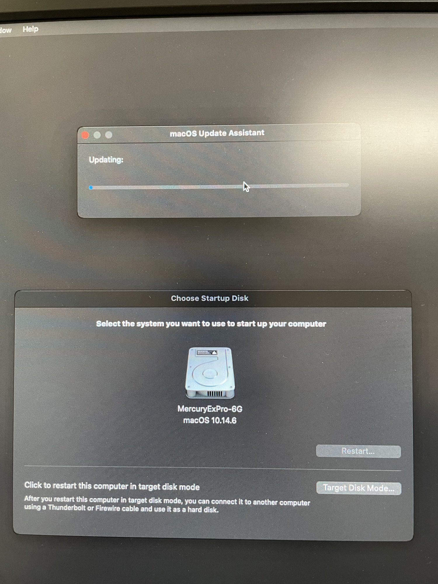

Why would I get a macOS update assistant window pop up while installing Monterey?
I am fairly experienced at the steps involved with Martins installers.
Using version 0.9.8.
The MacPro had already been running Mojave and Monterey via OC but the PCIe SSD kept having random crashes while running Monterey so in an effort to trouble shoot I have taken that PCIe SSD out and reinstalled Mojave on an OWC SSD in bay #1.
Now while attemtping to install Monterey i get this...
It was installing just fine and I walked away to com back to that?

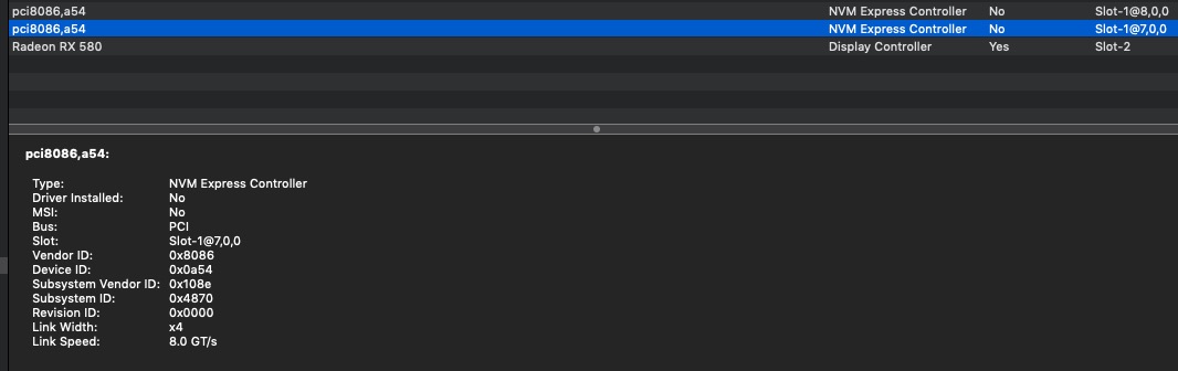

Because you know if there might be a way or there is no hope at all:
Is there a way to use an Intel SSD DC P4608 6.4TB
on the PCIe-bus of a Mac 5.1?
As there is no driver - where can I get a working driver for this SSD?
Thank you for your time!
