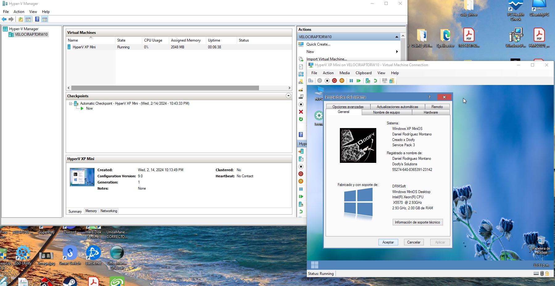

to all the effort work done to keep the updates I was waiting for this one. Confirm that HypeV and sanbox is working under Windows 10 22H2 Great job!!

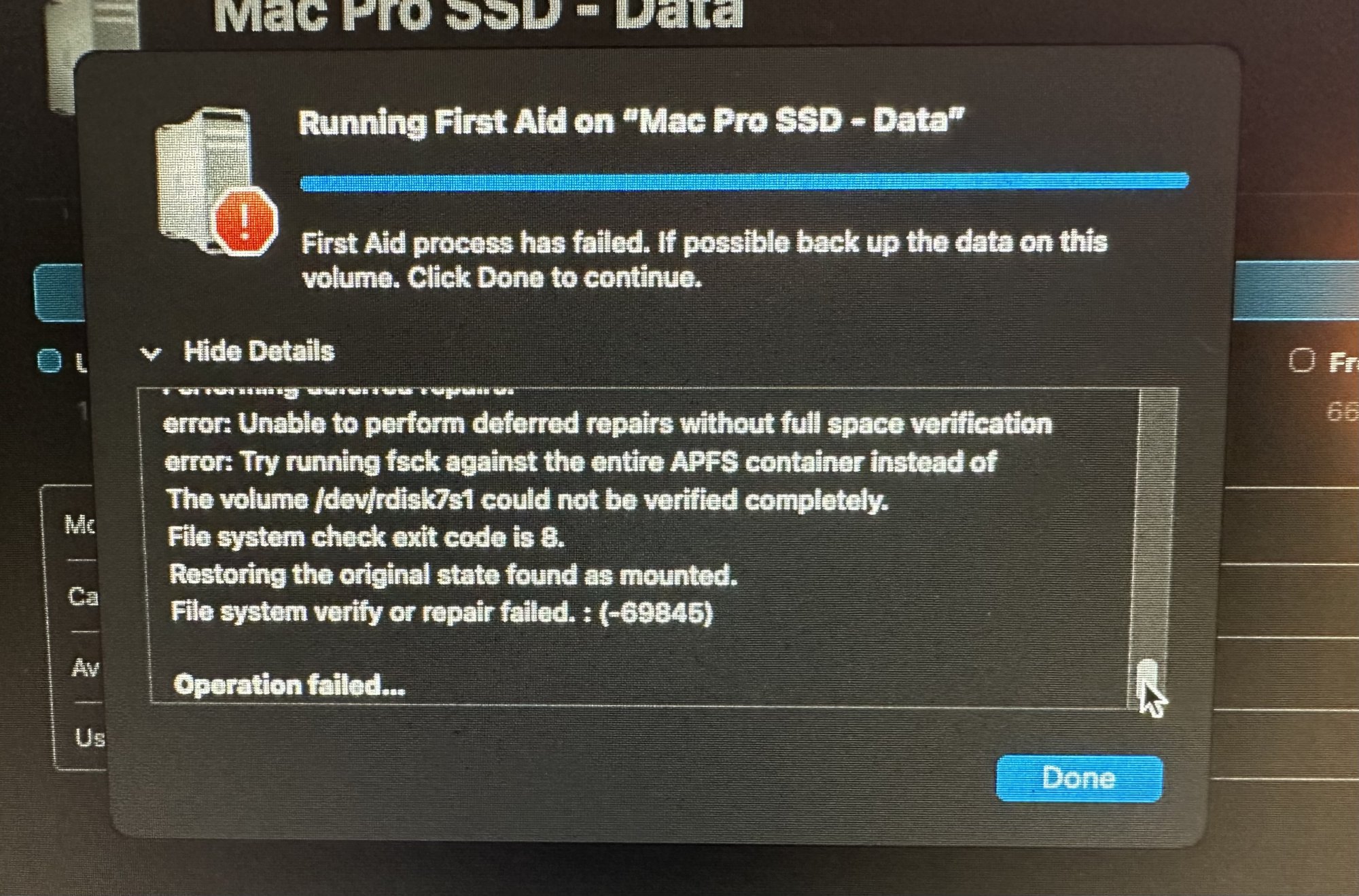

I noticed I started having a series of hangs recently. I’m running the latest Monterey OS.
When I boot it into recovery disc, First Aid stated I need to run FSCK. When I booted into single user mode, I was not able to choose the correct disk.
Is there any other options to attempt to repair this hard drive?
