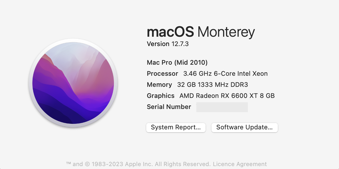

I did that to get 12.7.3 installed now using 0.9.7.

Where u get 12.7.3?

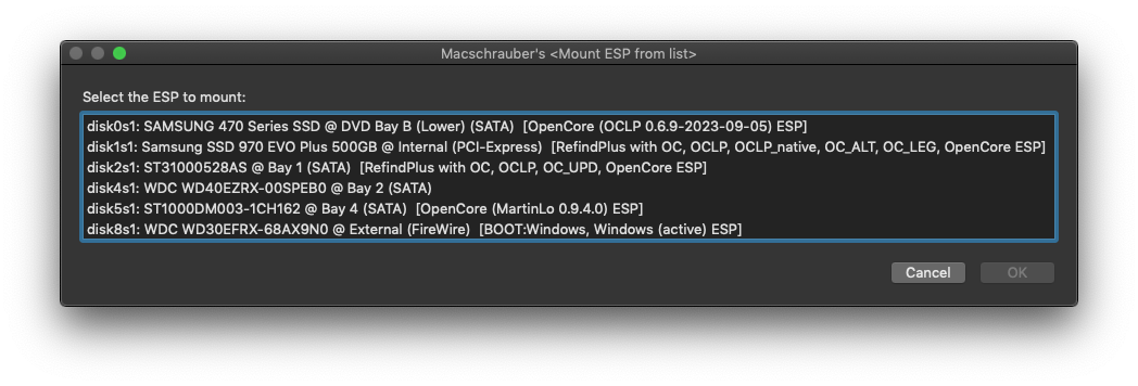

Have you used my mount from list script to check if you are doing the correct ESP?

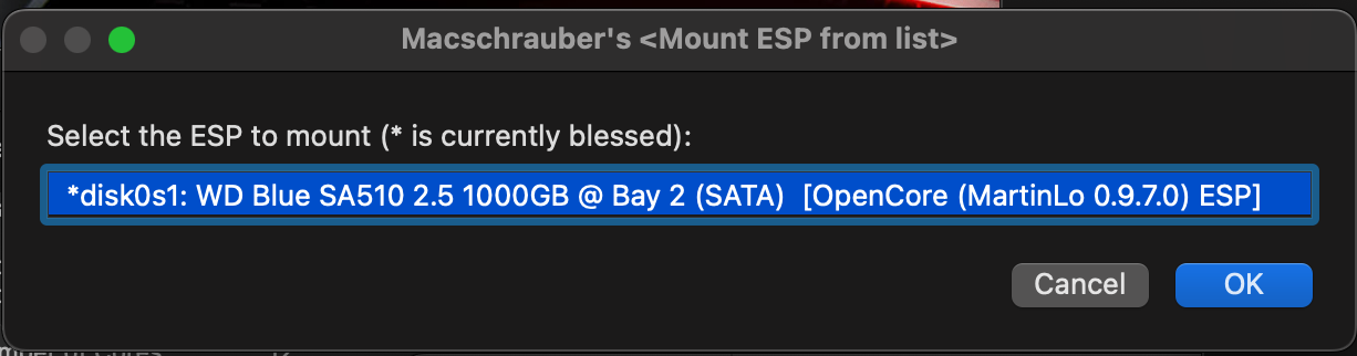

Yes I have and it shows that it is blessed. I get the Opencore bootloader appear correctly as well.
Also you can see Opencore is loaded through this:

I did the reset procedure and ran your tool with this:
blessed this mounted bootloader successfully:
1: EFI ⁨EFI⁩ 209.7 MB disk0s1
WD Blue SA510 2.5 1000GB
Bay 2 (SATA)
The mount efi partition tool shows this:

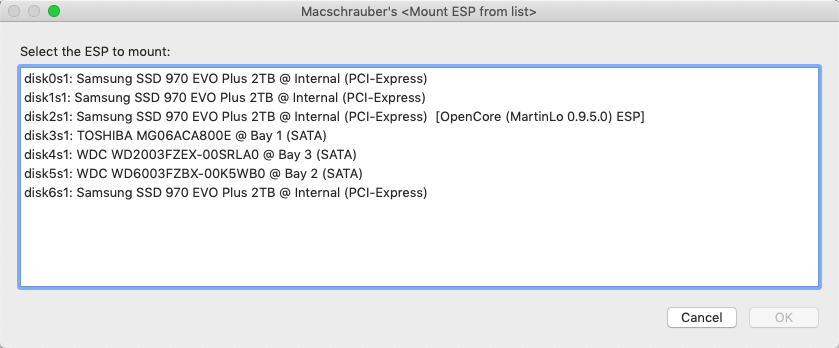

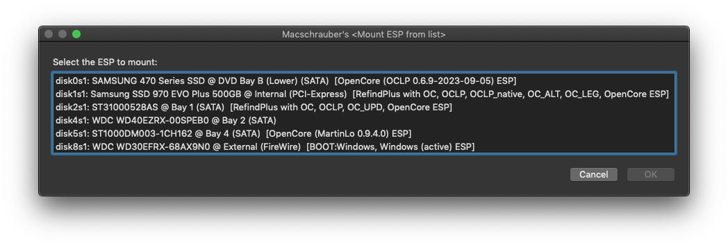

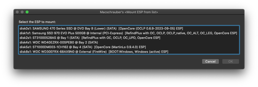

OC/OCLP is probably loading before you can get the native boot picker, or worse, you have multiple disks with OC/OCLP, you need to check each ESP.
Sounds like a good idea. How DO you check a disk to see of OC is installed--and how do you determine the version?
Mount and inspect each disk ESP, look for the OpenCore files. Version is not relevant, but you can always know the version opening the config.plist.
Keep OC installed to just one disk.
Using Macschrauber's tools it looks like I'm ok -- OC only shows up on one disk 🙂

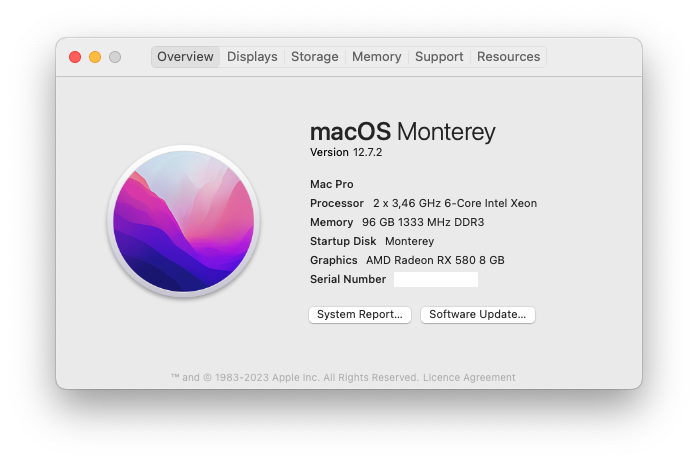

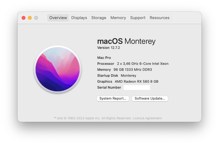

Hello!
I got a problem. I did not approved a update of the system but my Monterey 12.7.2 did that automatically. I did not change config.plist from the last update. So the problem is that Monterey downloaded something and I couldn´t stop the update. So now I have a Installer in my OC Bootscreen (Martins 0.97).
Q: How do I get rid or exit the newly downloaded Mac OS/Update installer? I can´t see it diskutility and I tried to show hidden files with Onyx. I want to unmount it because the system seams to want to boot into the installer all the time. Can not get to recovery either threw OC?

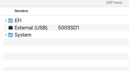

@Macschrauber Used your Copy ESP tool for the first time. Can you tell me what is that file created? Thanks
