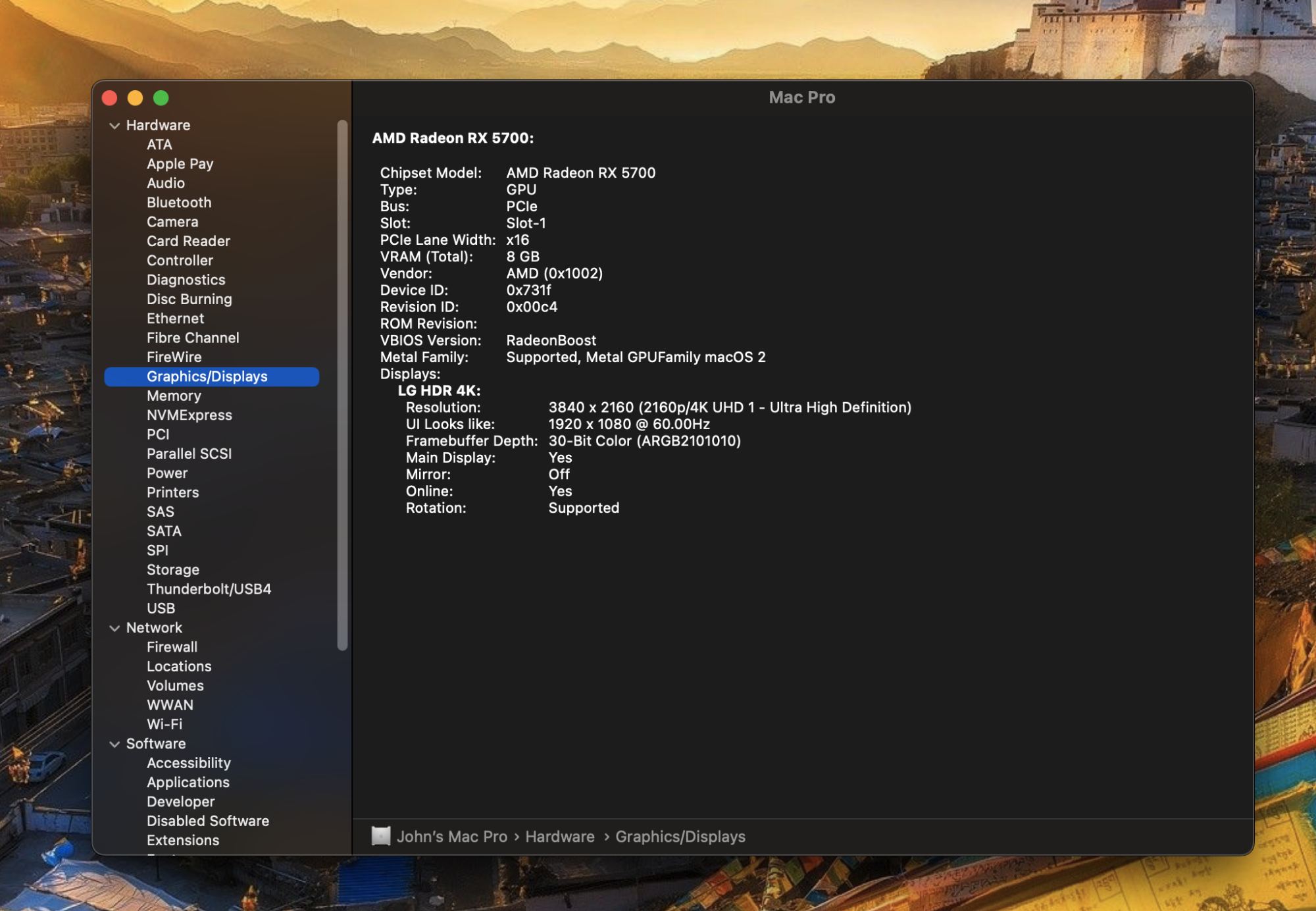

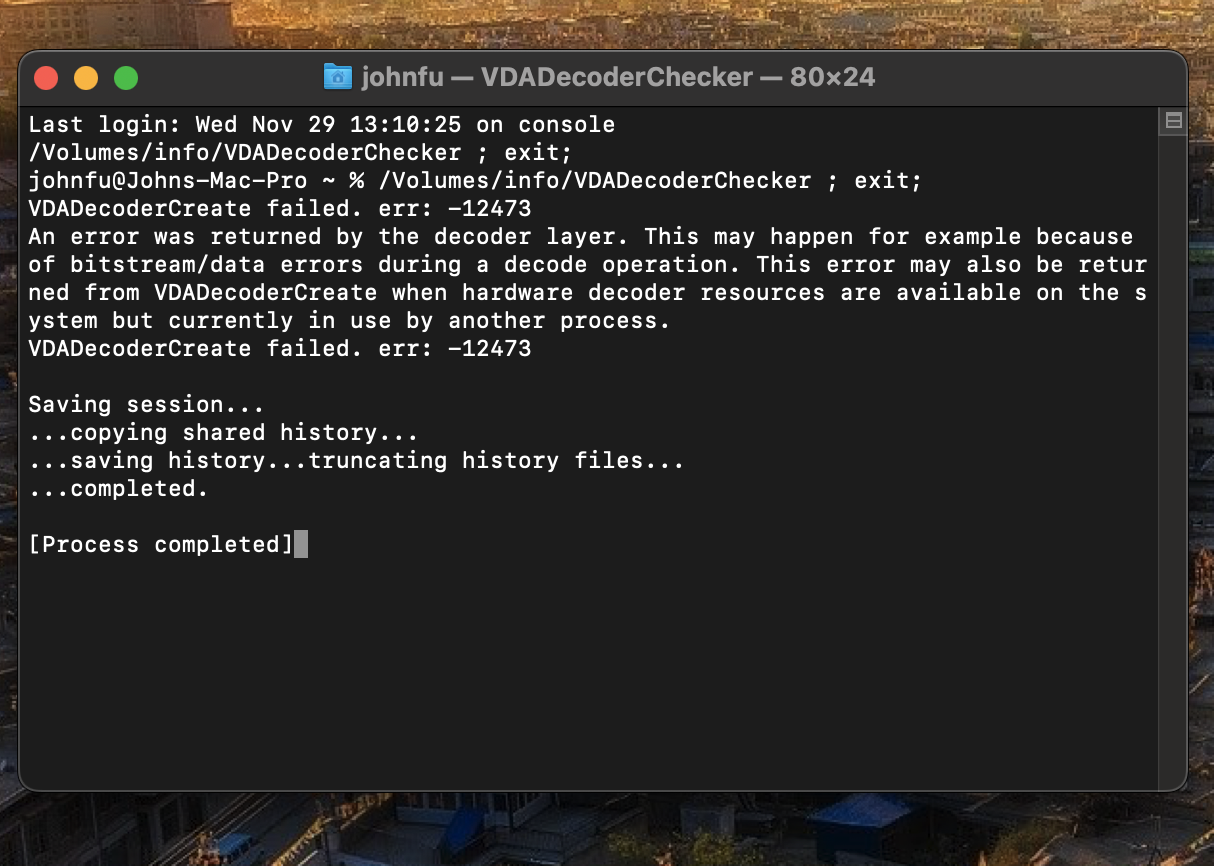

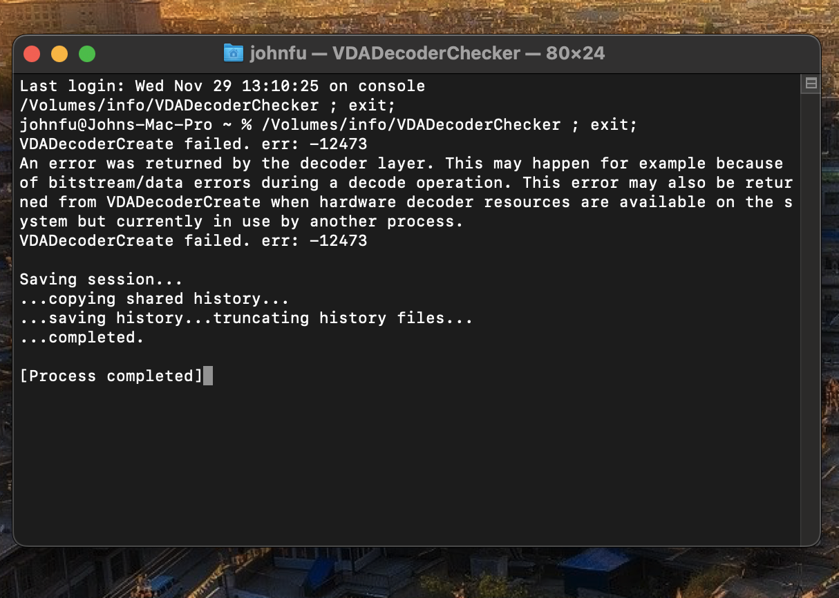

Hello All,

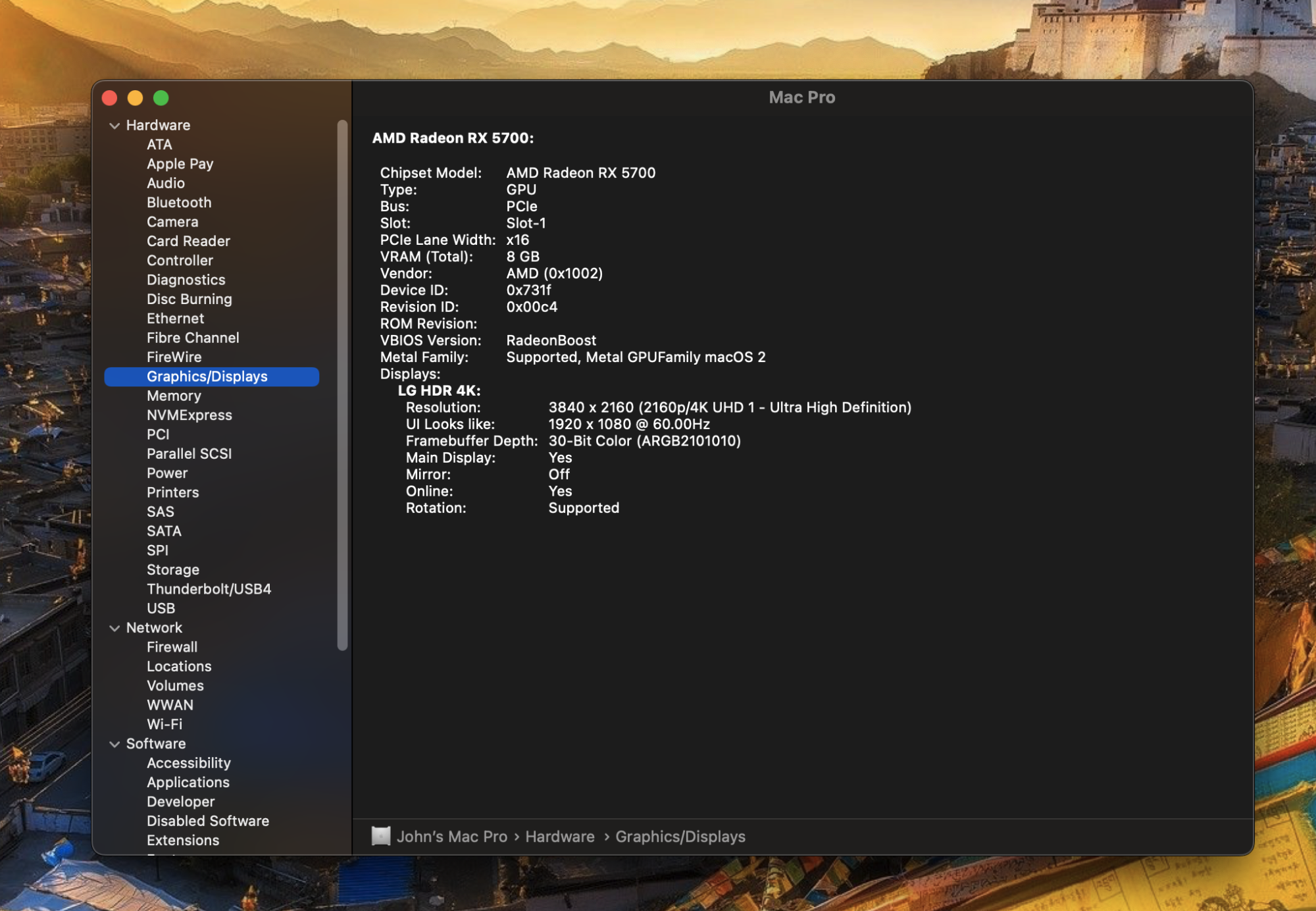

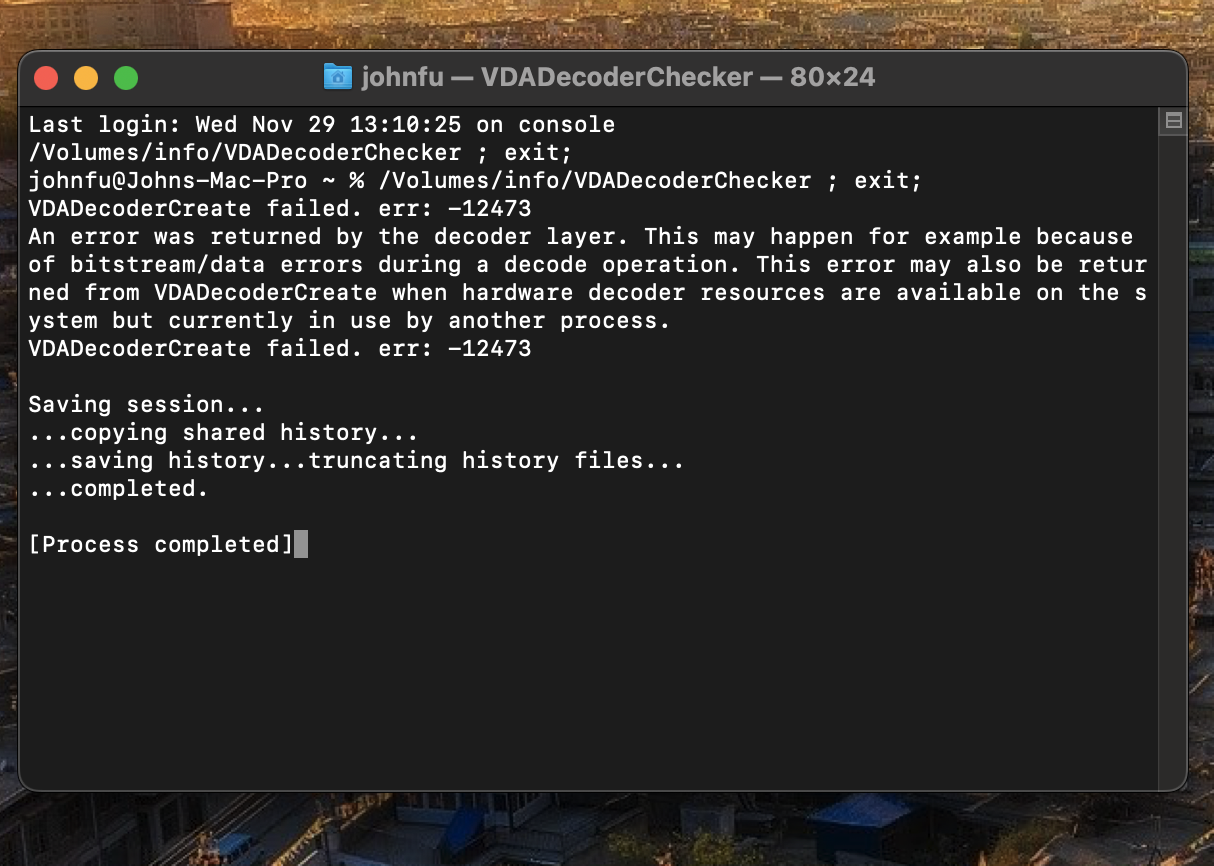

I am hoping someone can help me to let my RX5700 work, I was trying to get it done, but after I tried both @ h9826790 and OCLP, the system was installed successfully, but the HW acceleration still failed, Any idea?
Please see the photo in detail!
Thank you

Hello All,
Thank you

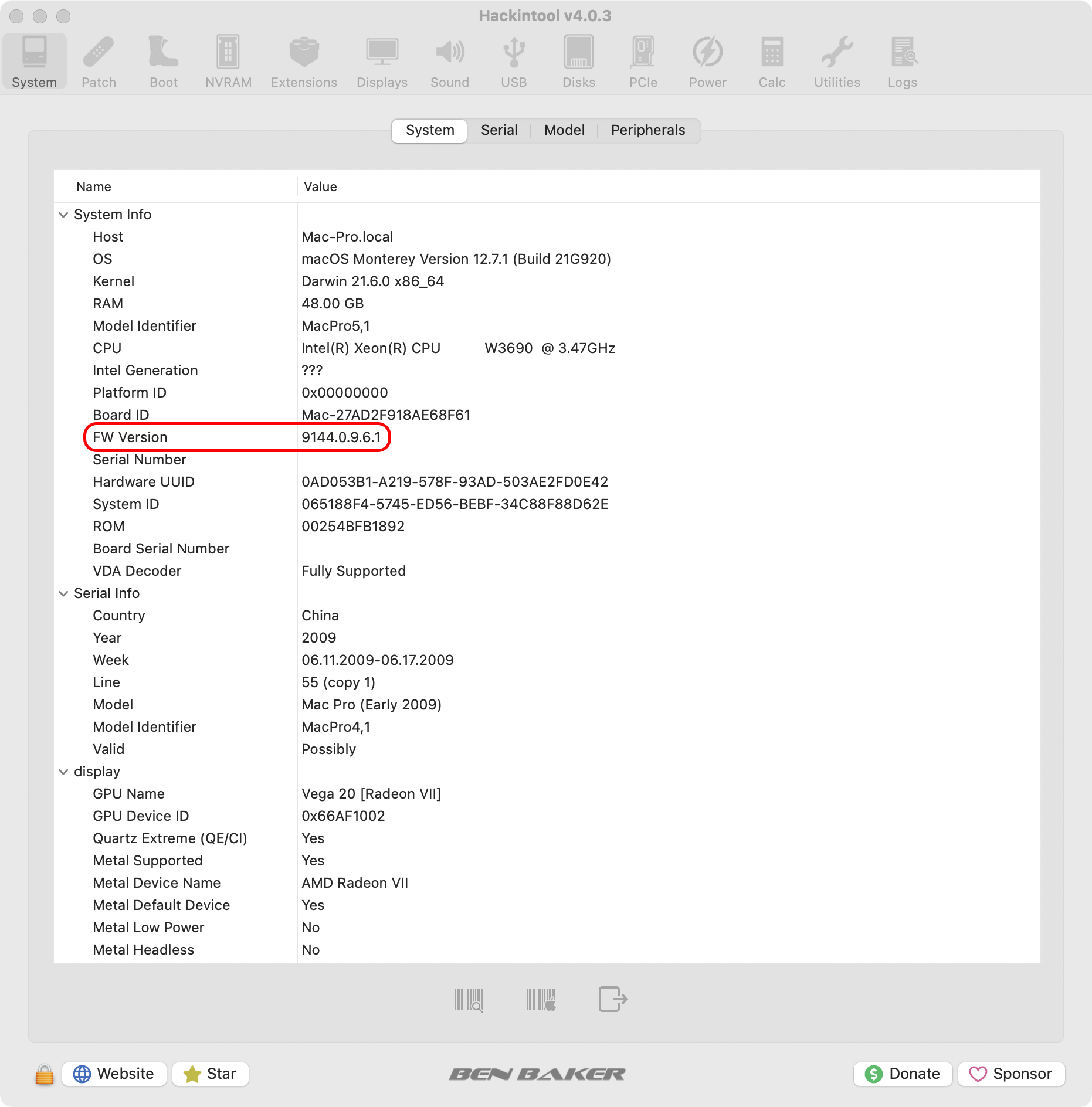

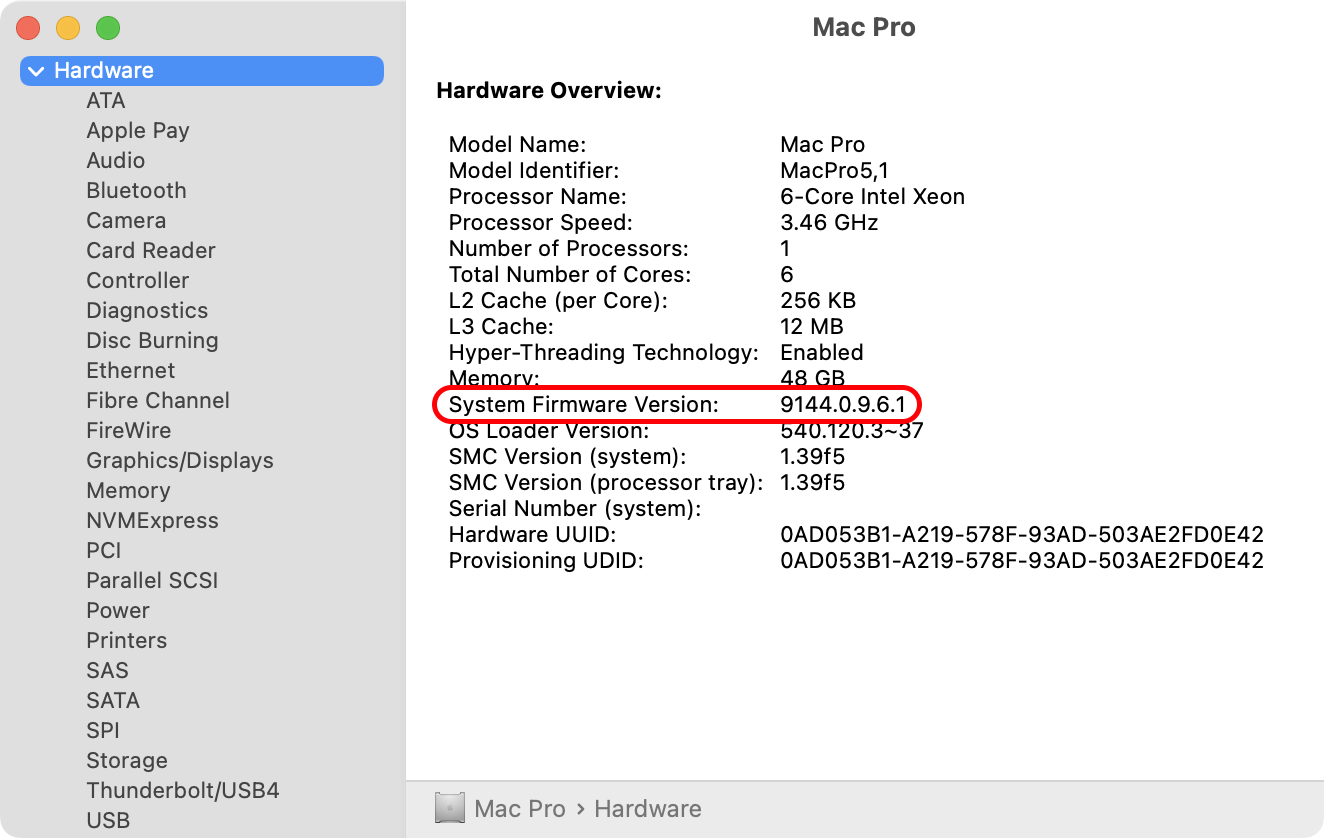

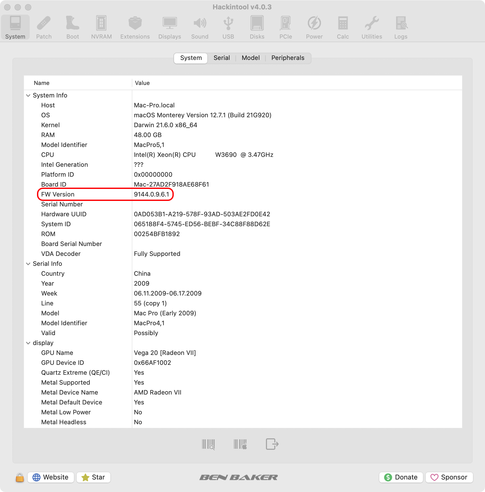

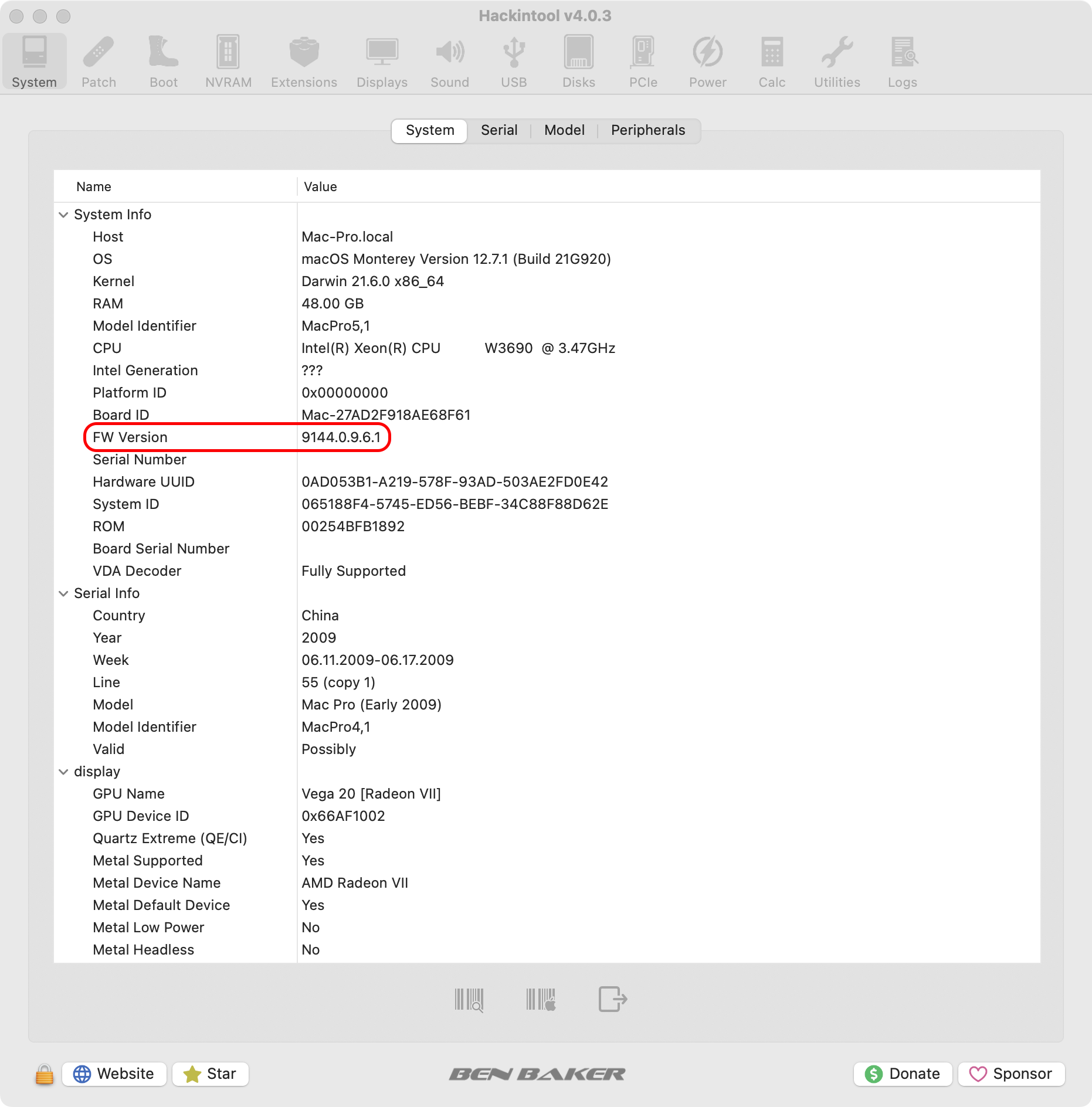

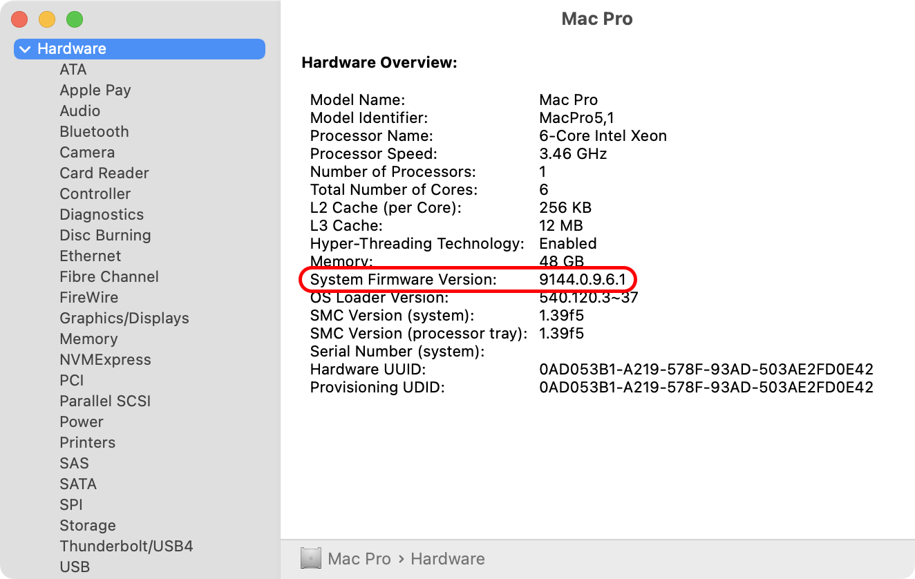

Please replace the whole EFI folder by my latest package (assuming your system files are NOT patched by OCLP), your screen capture suggest you haven't done the steps correctly.
Of course, you have to turn on the 32GB DIMM support for your memory config.
If you did everything right, both System Info and Hackintool should show 9144.x.x.x.x in the BootROM version, but not 144.0.0.0.0 (assuming you are using my package).
I will do it and report back to you, Thank you

Remove/Mask your serial number in the hardware overview image. Someone may use it to spoof your machine for apple services.
