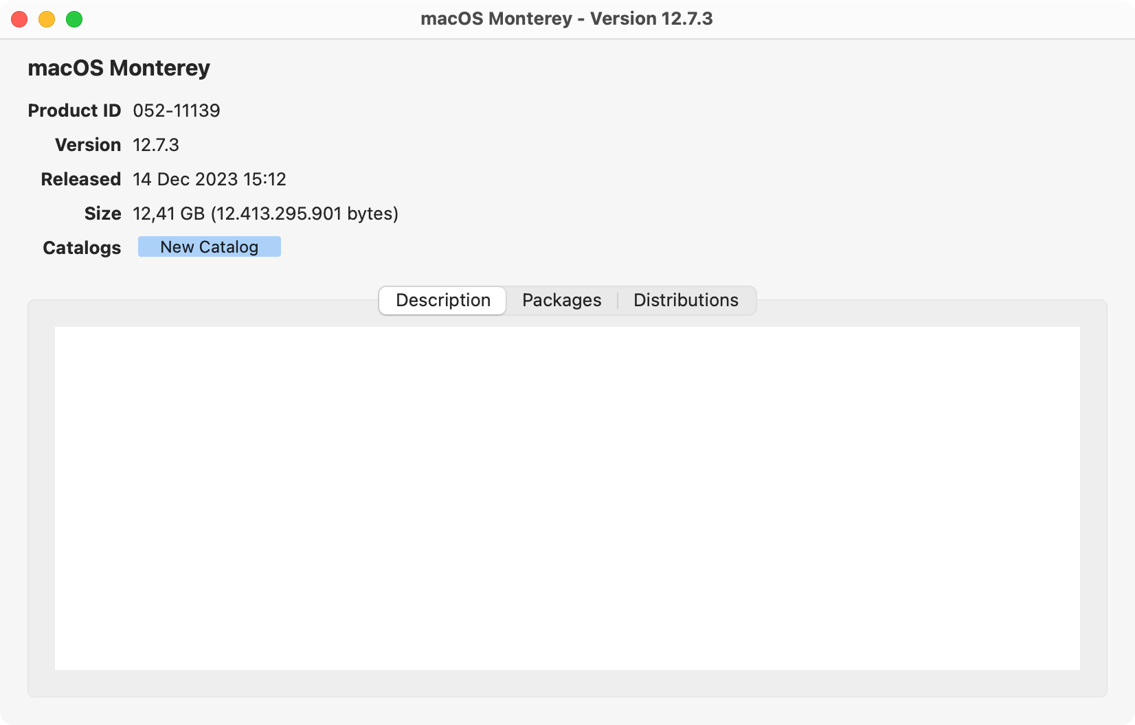

Updated to 12.7.2, no prblemo.
Hint for those who don't see the updates via Software Update: you have to edit following in the OC config.plis:
<key>Cpuid1Mask</key>
<data>AAAAAAAAAAAAAAAAAAAAAA==</data>
change data to:
<data>AAAAAAAAAAAAAACAAAAAAA==</data>
And:
<key>UpdateSMBIOS</key>
<true/>
change data to:
<false/>
After this change, reboot and look for the updates again. After successfull update, change config.plis values to previous ones.

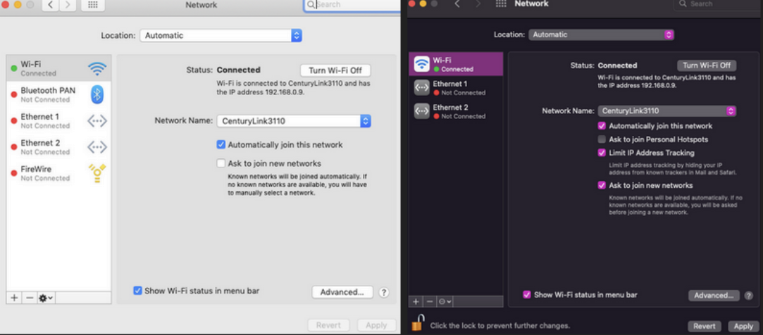

Can you add kext to see the firewire in the network tab ? Monterey does not populate the firewire icon on the network page.
