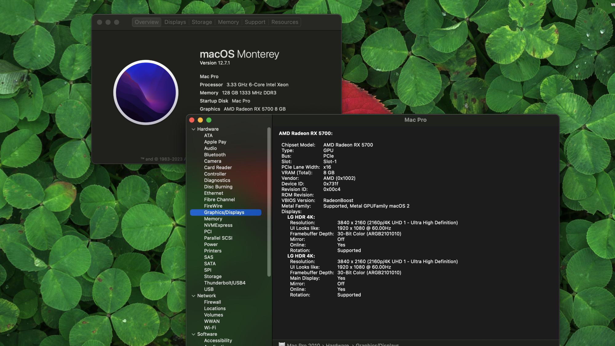

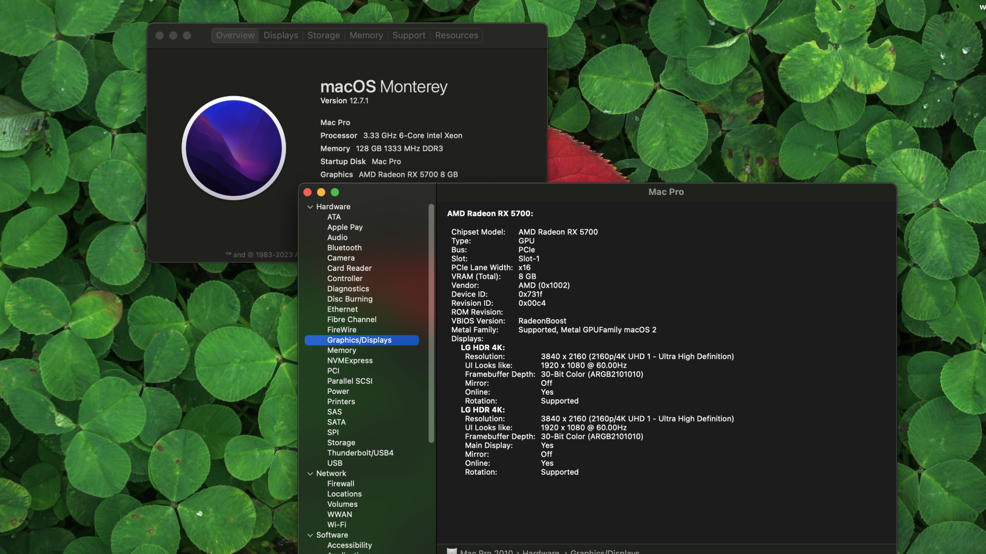

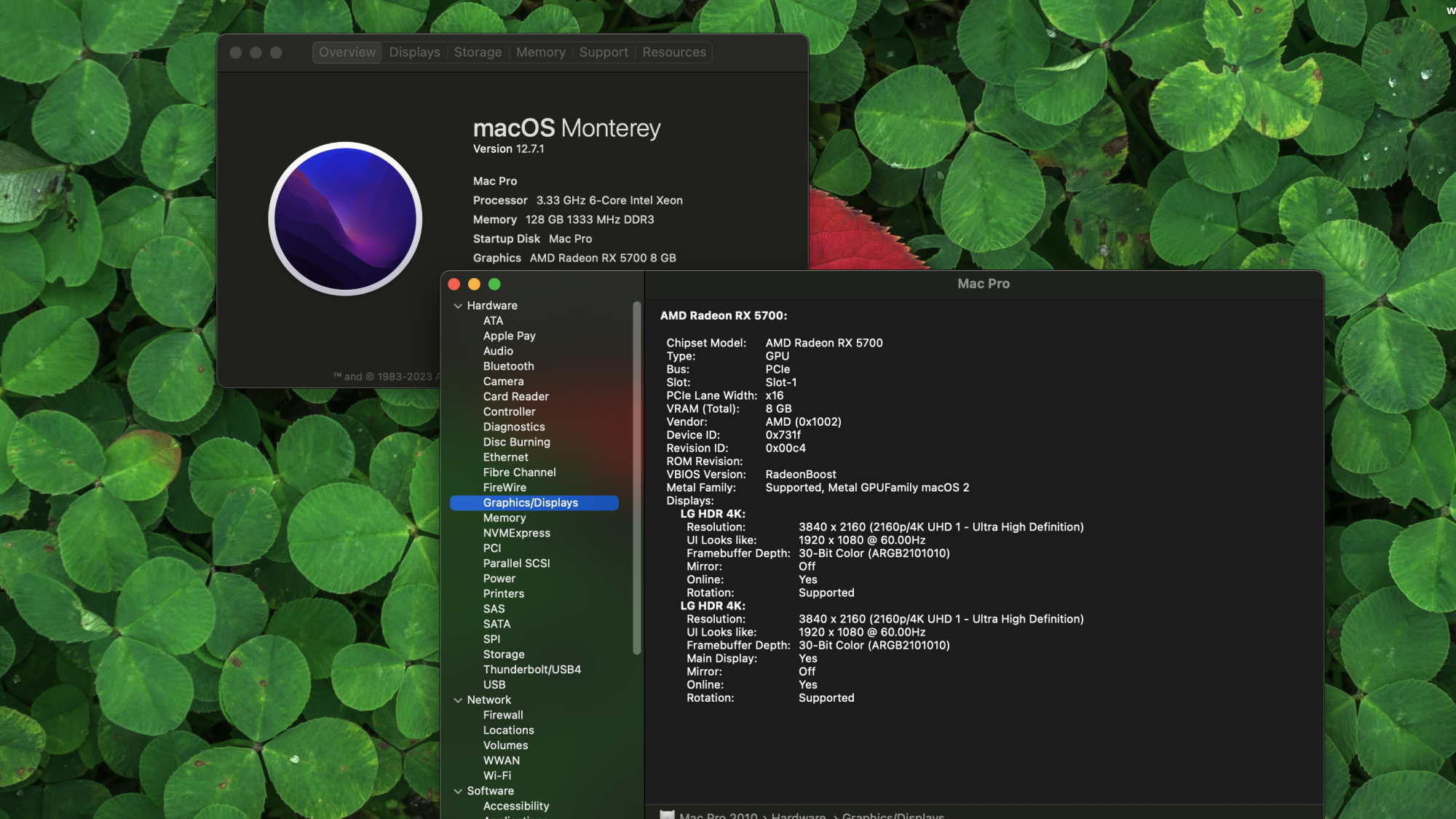

Thanks for the message, Just wonder how I can enable the HW acceleration. I know you did before, could you share it with us? because on page 1, it only shows it works in Mojave.
Thank you
Thank you
That's at post #1314.
If you are using my package, that should be enabled by default.
