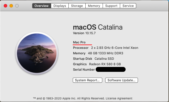

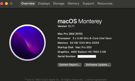

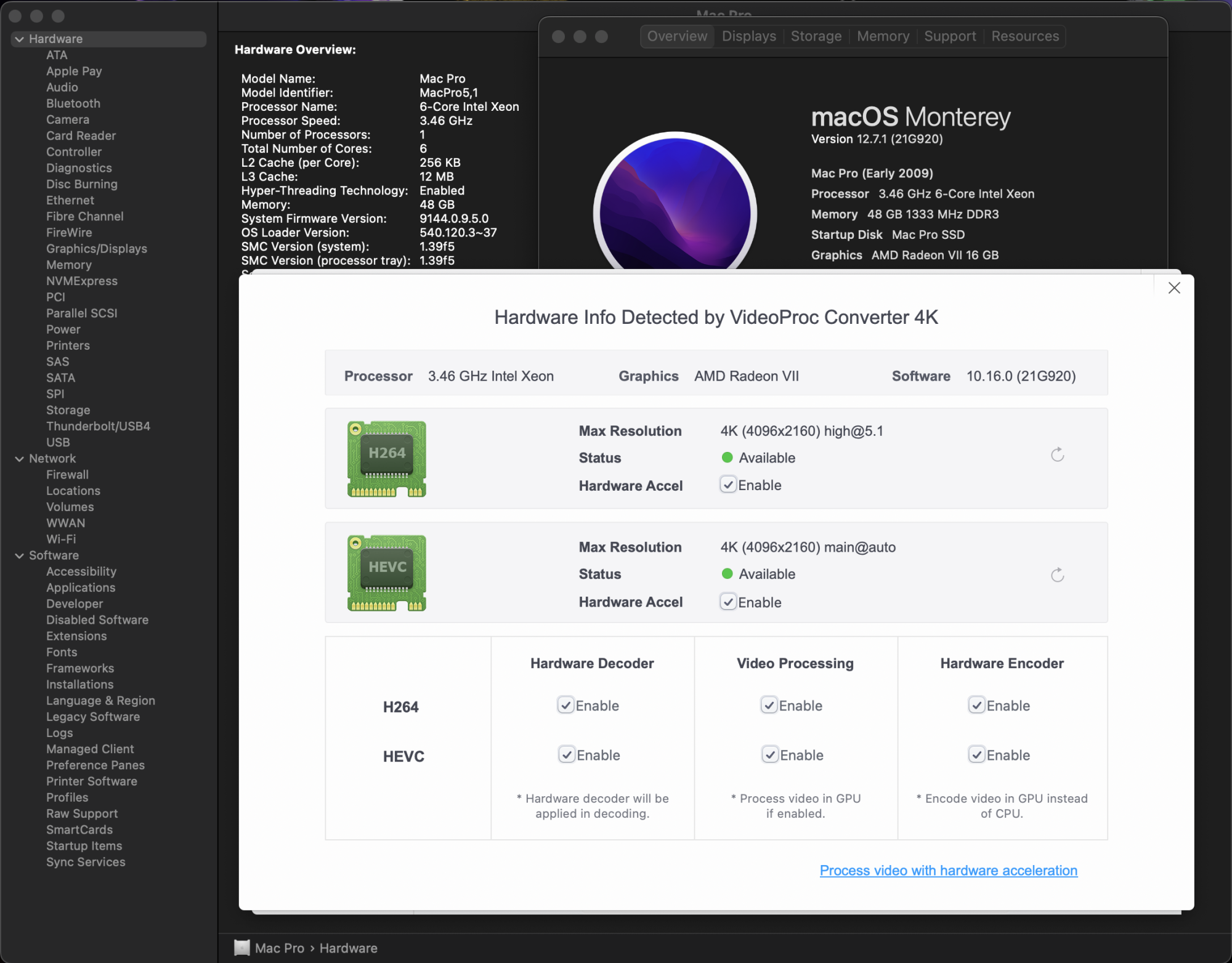

Also noticed something since Mojave. The About This Mac window is only showing Mac Pro and not Mac Pro (early 2009) or even 2010 since BootRom was upgraded. Is this expected? Not that it matters much but I am curious.

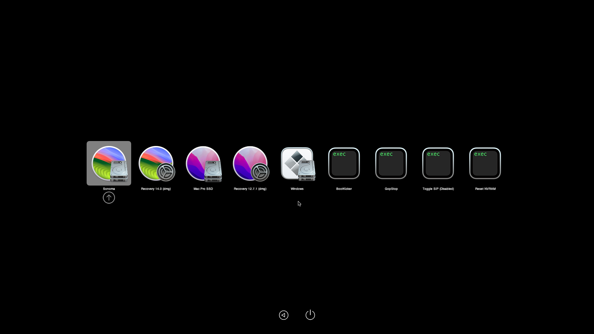

Finally when booting, I see in the Bootpicker the name of the drive which I am booting from. Weird thing is that it is showing the previous name I had. For instance the drive was called Mojave SSD and I renamed it Catalina SSD (as you can see above) but it is still showing Mojave SSD during boot on the Bootpicker.
AFAIK, this is cosmetic, and this behaviour base on the Apple server side's response. Not user's error.

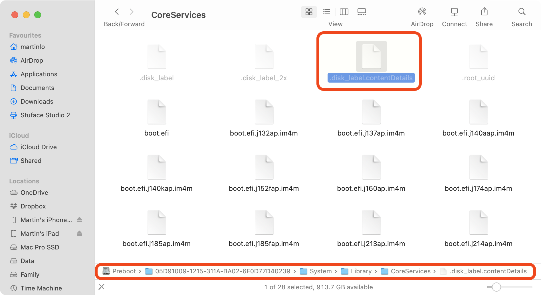

There are few ways to change the disk label in boot picker. What I found the most reliable way is as follow (it's a bit complicated, but works well for me).

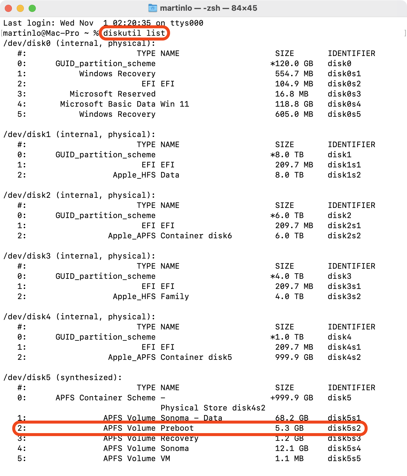

1) Open Terminal, and enter diskutil list, then look for the disk ident of the Preboot volume of the disk that you want to update the label. e.g. In your case, you should see something like APFS Volume Catalina SSD - Data, then one line below it, you should see that Preboot volume's disk ident. In the below example, the Preboot volume ident is disk5s2

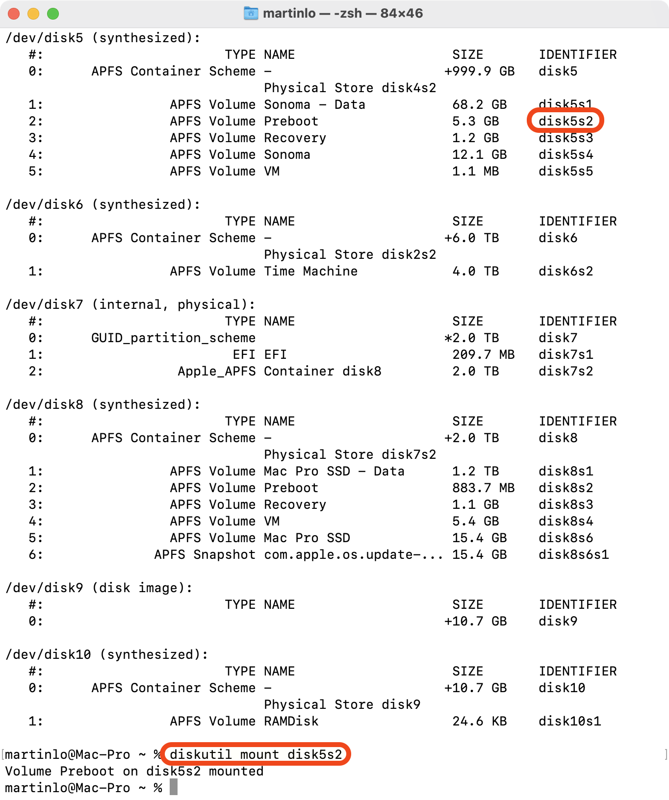

2) In terminal, enter diskutil mount diskXs2 (replace the X with your own disk ident), in my example, that will be disk5s2

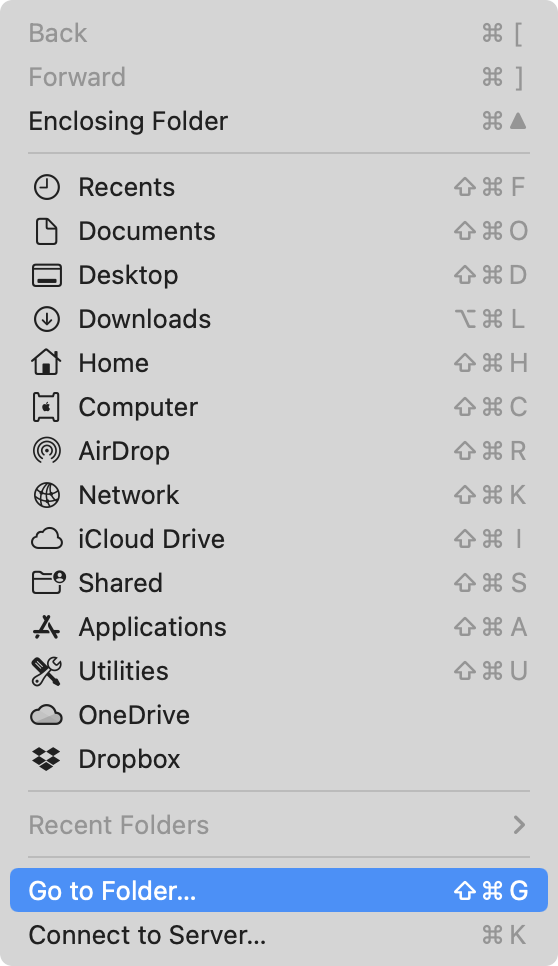

3) In Finder, go to the top left menu bar, select Go
4) Select Go to Folder

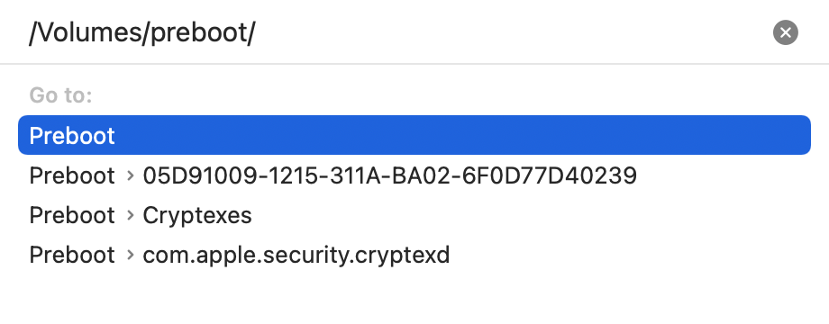

5) Enter /Volumes/preboot/, then press Enter

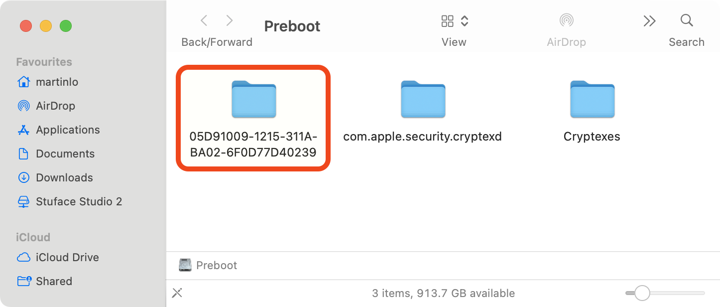

6) One of the folder will be named with UUID, go into that one
7) Further go to /System/Library/CoreServices/ then press Command + Shift + . (Command + Shift + dot) to show the hidden files. Then copy the .disk_label.contentDetails to your desktop

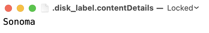

8) Open this file with TextEdit, and change the content inside to the label you want. e.g. In your case, you may use Catalina. Then save change, and copy this file back to the Preboot volume to replace the original file.
9) Press Command + Shift + . again to hide the hidden files.
And now, when you reboot, the OpenCore boot picker should show you the disk name you want.
Ok but I see other people's 'About this mac' that says Mac Pro (early 2009). How is that possible? Can I change it manually?
Also noticed another odd thing. Today just got this usual welcome notification when you install a new OS. This said the welcome page was for imac Pro. What's up with that ?

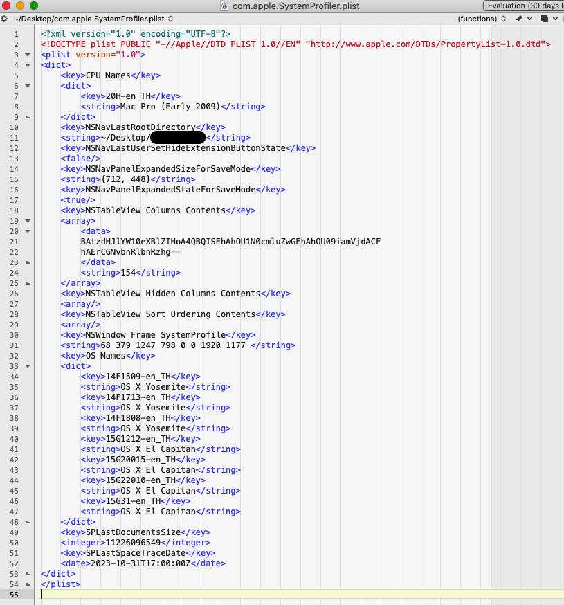

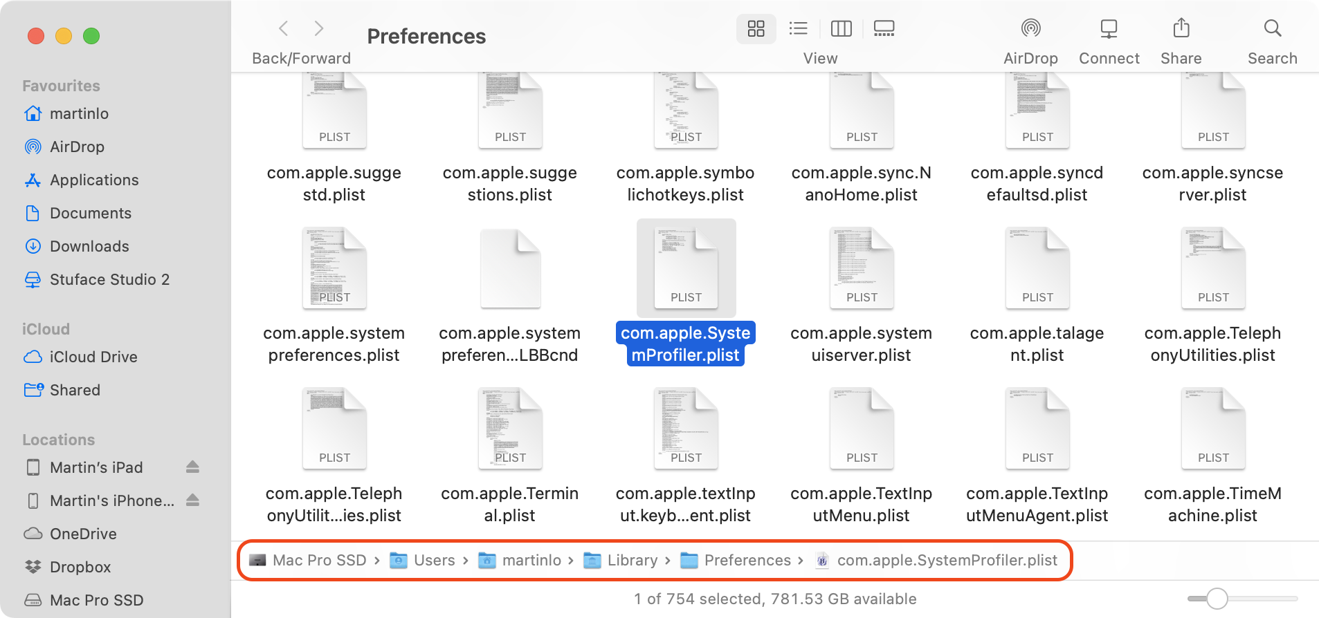

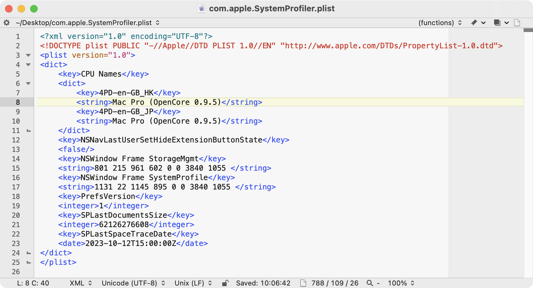

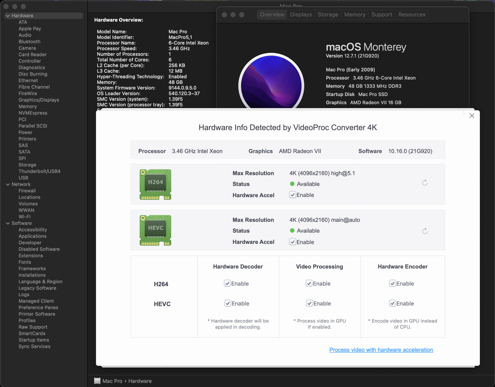

That can be changed by editing a system file. e.g. I can make that "Early 2009" become "OpenCore 0.9.5".

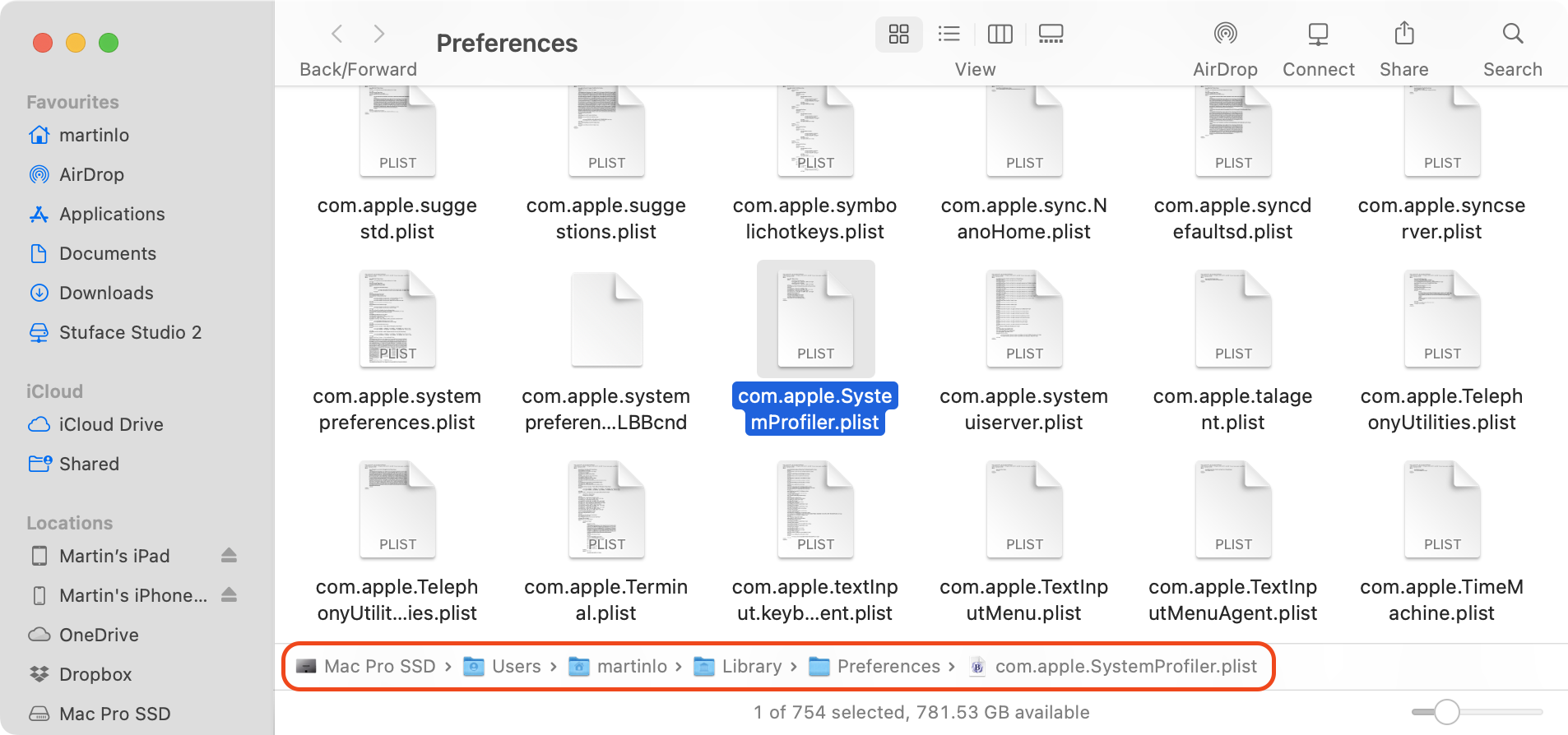

All you need to do is just copy the com.apple.SystemProfiler.plist from ~/Library/Preferences/ to your desktop.
Open it with Text Editor. Then you can manually change that "Mac Pro" entry to whatever you want.
And then put the file back into ~/Library/Preferences/ and reboot.

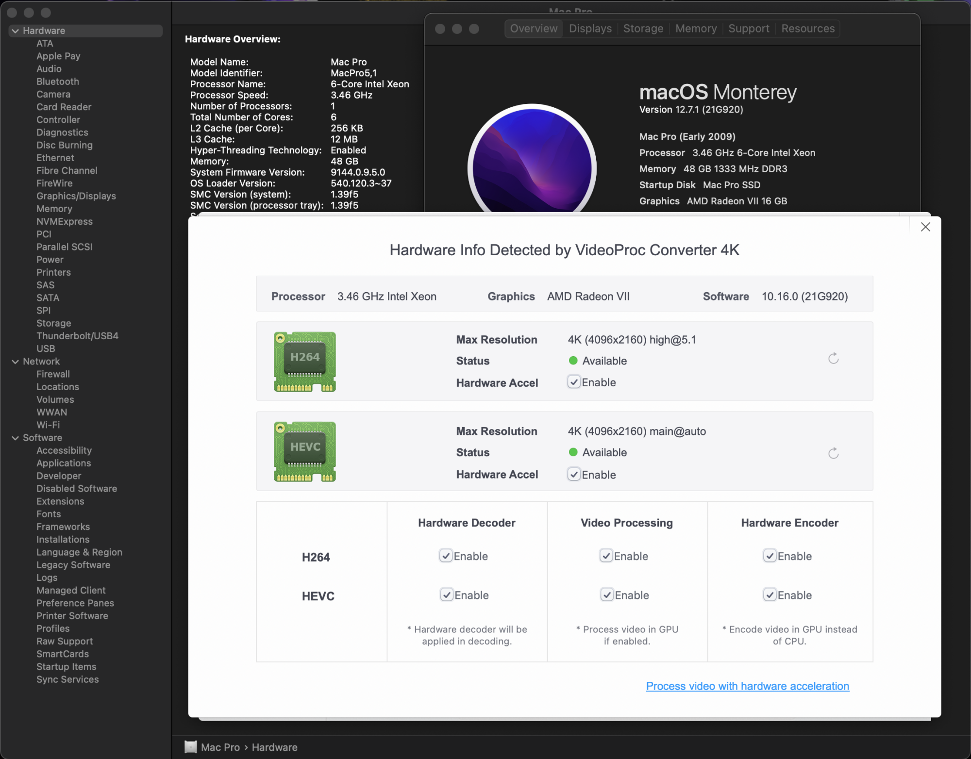

That year label is coming from the Apple server, they decode the serial number, then should make macOS show the year info in About this Mac automatically. However, for unknown reason, they suddenly stop this recently for some computer. AFAIK, no one figured out their logic yet. We only know some cMP shows the year, some others don't.

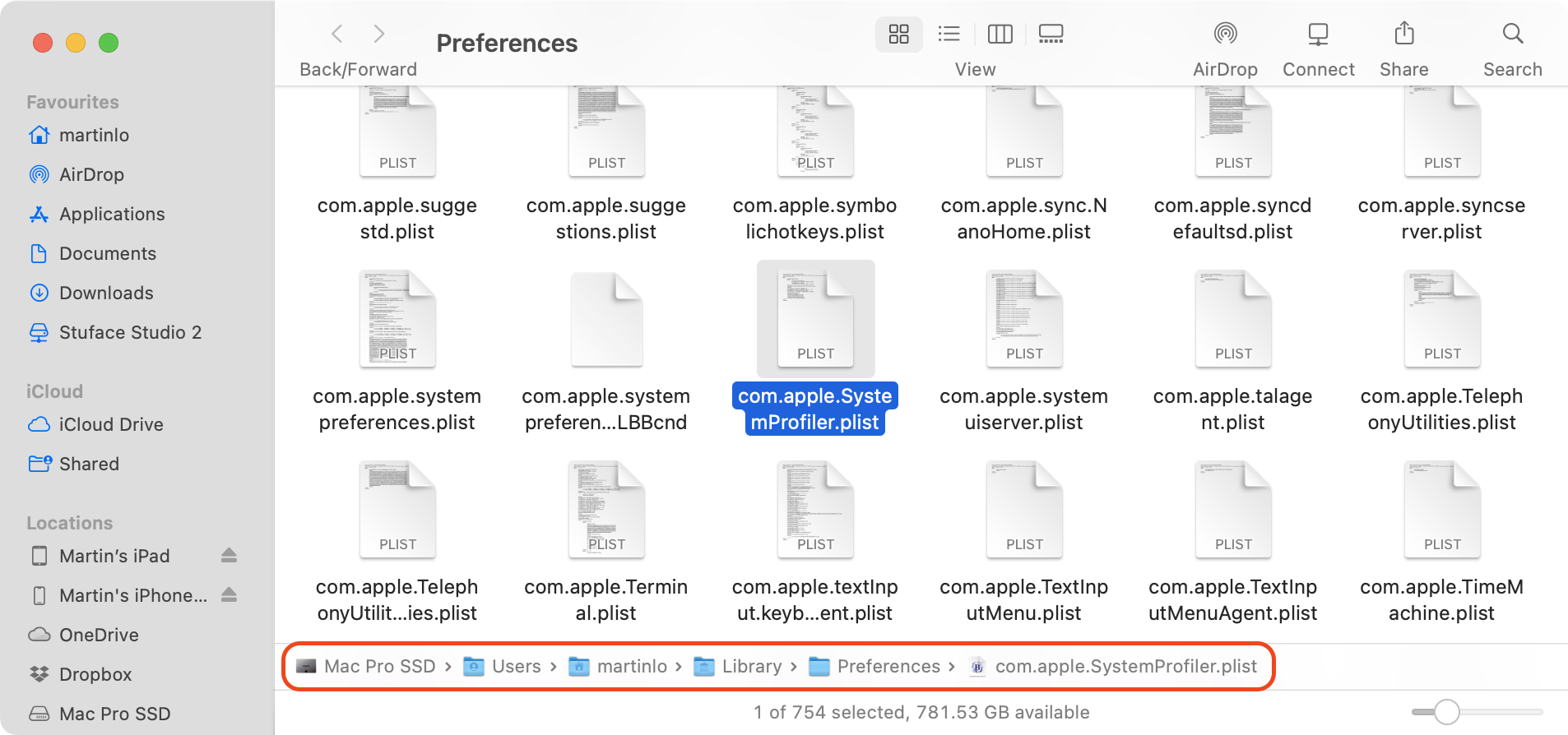

That can be changed by editing a system file. e.g. I can make that Early 2009 become OpenCore 2009.
View attachment 2305832All you need to do is just copy the com.apple.SystemProfiler.plist from ~/Library/Preferences/ to your desktop.
View attachment 2305834And then put the file back into ~/Library/Preferences/ and reboot.

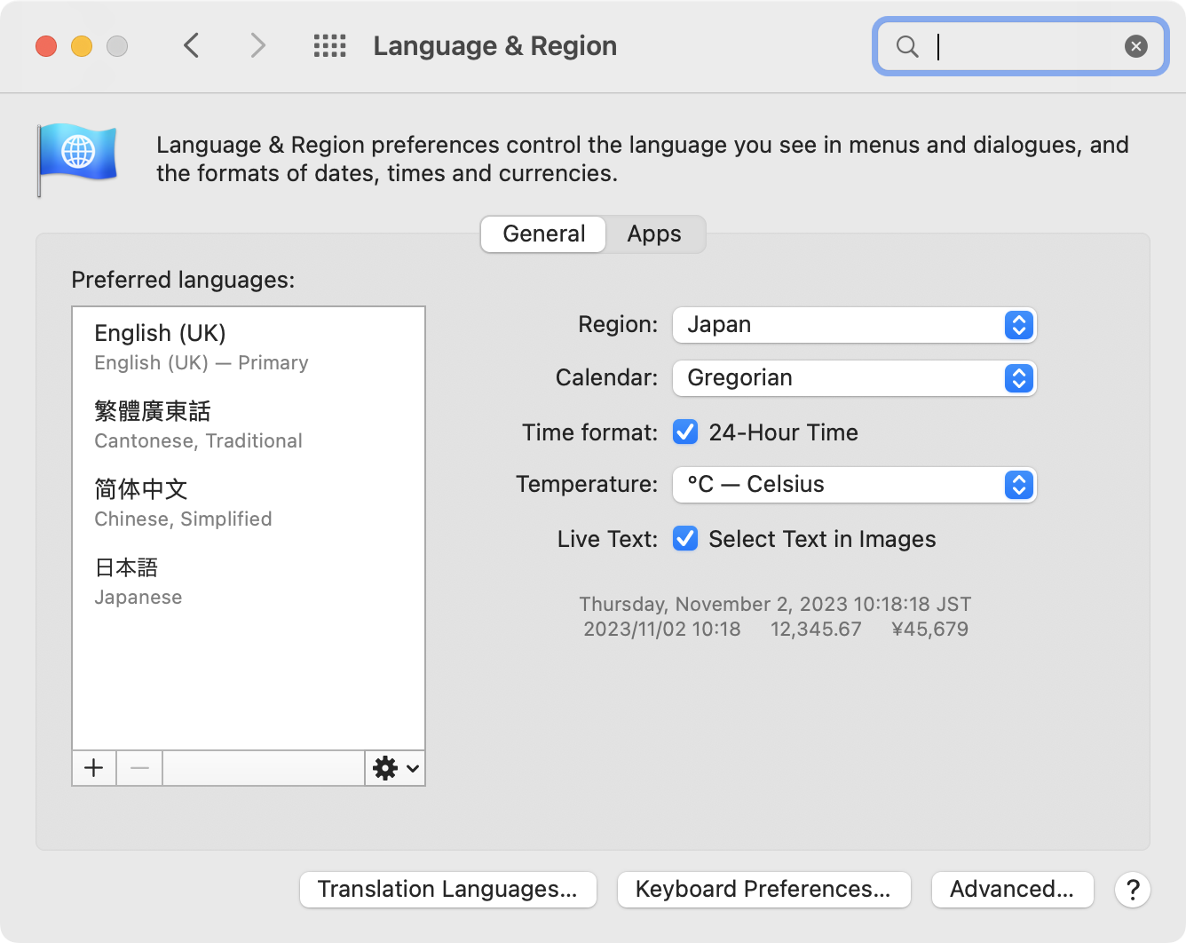

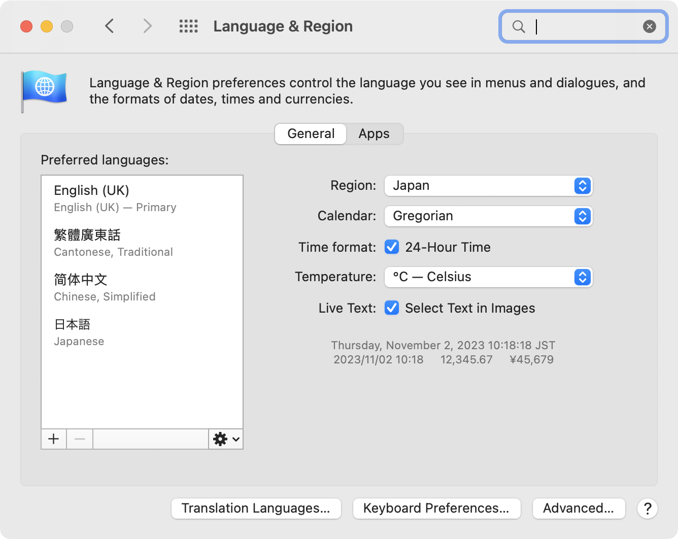

I did try that mod yesterday to no avail. It just kept saying Mac Pro. In fact the file already had Mac Pro (early 2009) written on it before I edited it.

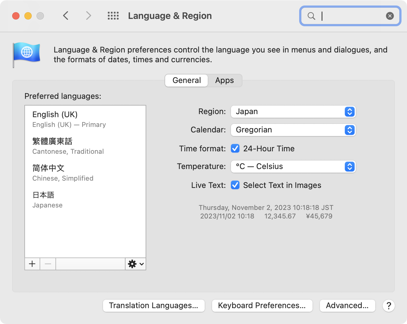

Then please try to change the region, and see if that force the cMP to make a new entry and use it.
As you can see, there are two entries in my config, because I moved from Hong Kong to Japan.
Reactions: polanskiman
Nope. File was neither updated nor recreated after the change of region. Wondering if deleting or renaming that file would force macOS to recreate it with default values.
