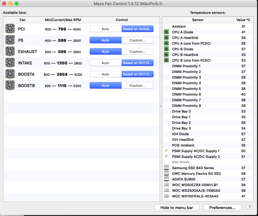

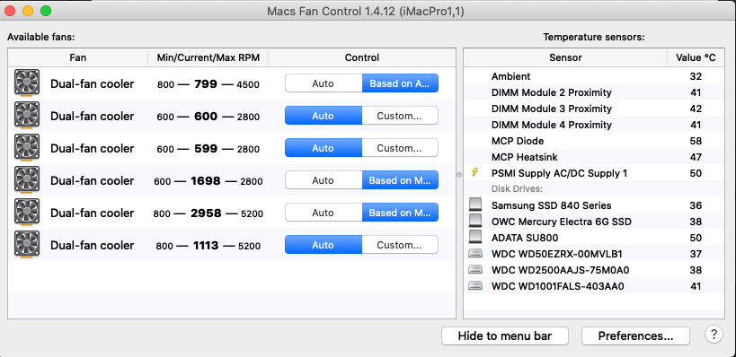

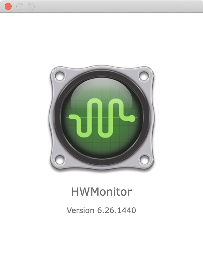

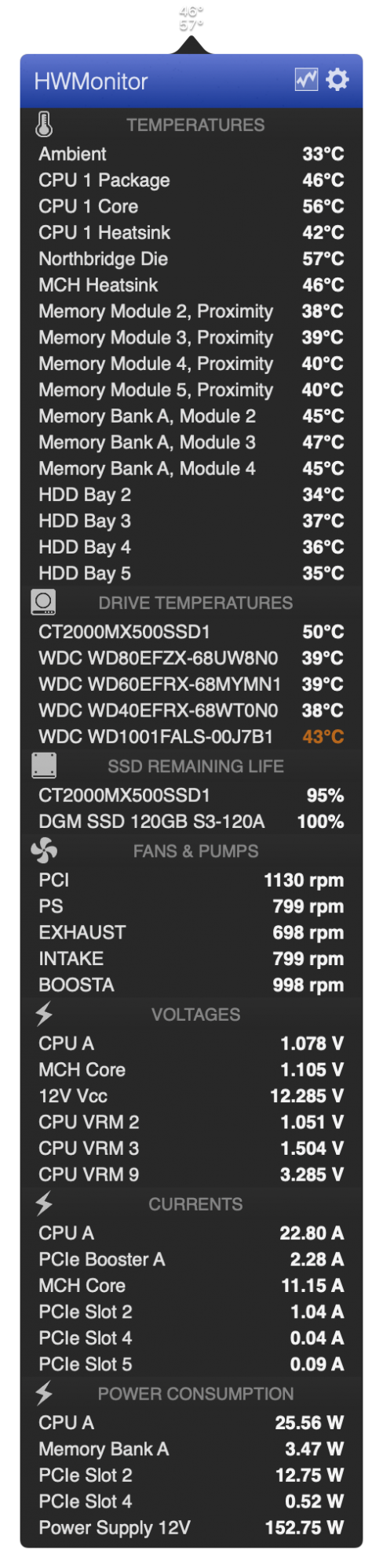

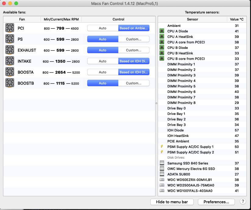

I use OC configurator and the check mark is not visible until you scroll to the right. Now I have enabled it and waiting for it to boot (I do screen sharing remotely). MFC sees the fans but the sensors are only from the board Id you inject not the cMP. Hopefully it will not overheat.
You may use Hardware Monitor to monitor the temperatures.
Also, avoid MacsFanControl now. It's not safe to use in this case. You can't set it to base on any temperature sensors. And if you manually spin up the fan. You will completely override the safety protection.
Therefore, I suggest you switch to smcFanControl. And use it to set a higher minimum fan speed. So that, the cMP will still able to run cooler than the stock fan profile, but the fans will also spin up when something warming up.
Of course, you can invest TG-Pro as well. It can see more sensors, and build fan profile according to those readings. However, it can be quite time consuming to build the fan profile properly in TG-Pro. Also, from my own test. TG-Pro can always see the sensors (after activate Hackintosh support), but not always allow users to build fan profile base on those sensors (may still stuck with the sensors that only available in non Hackintosh mode).

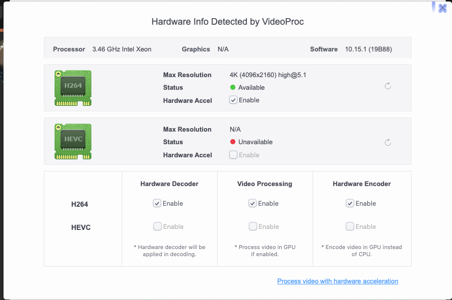

Like @startergo said, you can enable h264 hardware encoding and HEVC decoding with AppleGVA edit or Lilu/WTG methods safely, just wait on OpenCore if you don't have a MATT card or a replacement backplane on hand. Something a long the way is messing with the NVRAM area and this can cause booting problems or even bricking if you already have binary blobs inside the 1st and 2nd stores of the NVRAM volume, like the ones saved by NVIDIA drivers when using TITAN GPUs, for example.
Btw, the credits for this are all @h9826790, I just helping with things that I'm more familiar when I can.

ok for now i stay with h264 hardware encoding and HEVC decoding with AppleGVA edit.
Maybe when you think that everything is easier to use let us understand clearly .... maybe with a special topic.
So if the merit is of @h9826790 I also give many thanks and good work.
