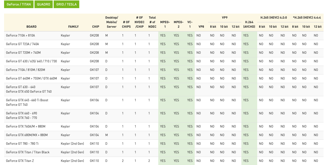

AKAIK the GTX Titan (GK110 core) is a Kepler series and none of the Kepler cores have the hardware for HEVC. Here is a grid from Nvidia which is self explanatory:
We need to find how it works then in Mojave and Catalina. It does not work in High Sierra. It may not work in Windows either.
Can you confirm that you have HEVC with the Titan on its own. Cannot really understand how it would work or what is happening as the Titan (with Kepler) physically does not have the hardware to do HEVC unlike the RX580. Some later Titans (Pascal/Turing cores) can do HEVC but Apple does not provide any drivers beyond the Kepler series for Mojave/Catalina.
I know, in fact, none of the NVENC / NVDEC should work because of this hack. That's why I asked startergo to remove all GPU but only leave the Titan in the cMP, then run the test again (to avoid false result).

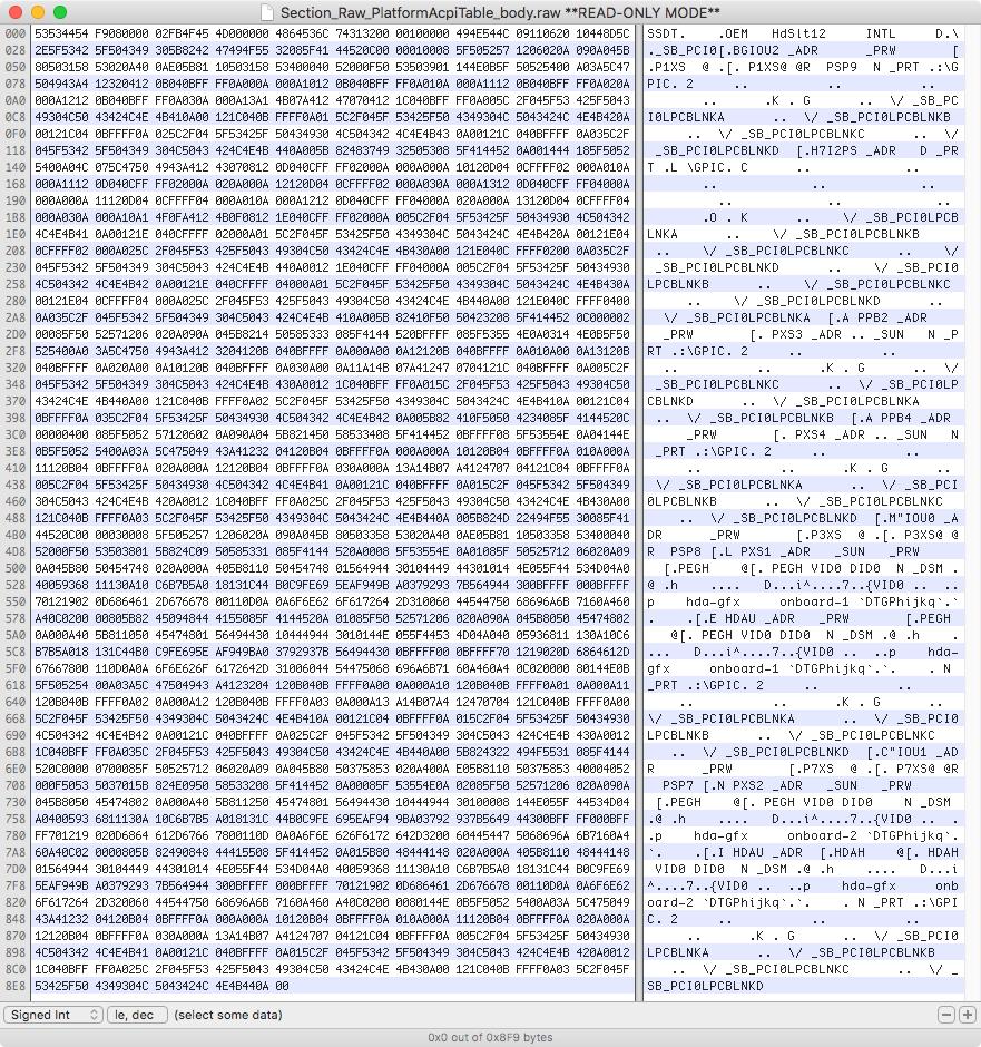

I've just found this. ?
If OpenCore devs don't help us, we can help ourselves :p PXS* to GFX0 rename inside the BootROM easy peasy.

I've just found this. ? View attachment 876510
[automerge]1573524256[/automerge]
PXS2 to GFX0 rename inside the BootROM easy peasy.
This is a good finding. Another possible (and permanent) solution for GFX0 renaming.
Now, we have to find out the very very last (hopefully) missing puzzle. Why GFX0 renaming + WEG board-id injection can’t activate HEVC encoding?
So far, I couldn’t find any hint yet. CMMChris also double checked the IOReg, also can’t spot anything missing.
Just thinking another possible way “mod the board-id / ident at the ROM level”. This of course very high risk (especially the development process), and not a good solution for general users, but it could be another possible solution.
