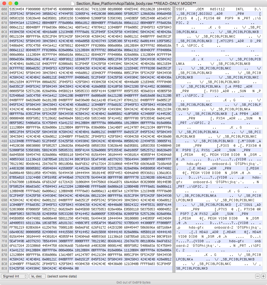

what would things behave like if we called the dGPU IGPU instead of GFX0 ... thinking have PXS1 == GFX0 and PXS2 == IGPU
then perhaps both could leverage acceleration

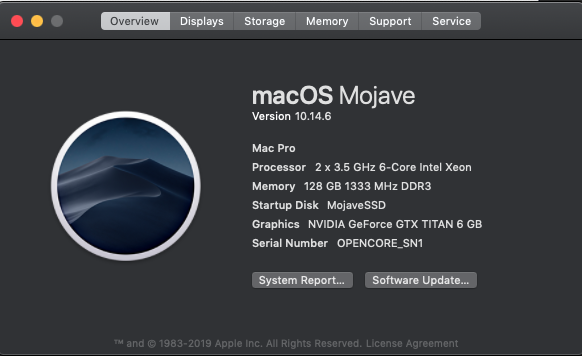

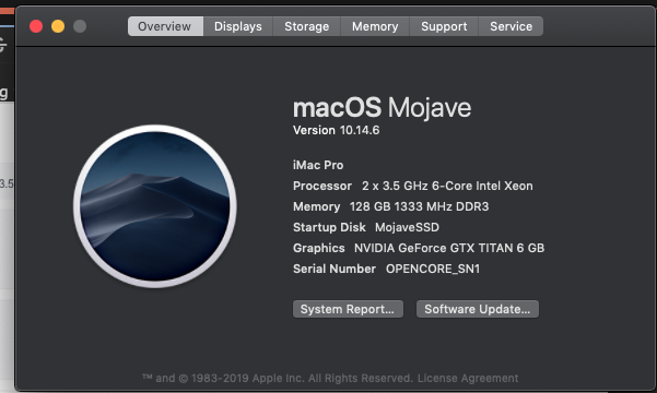

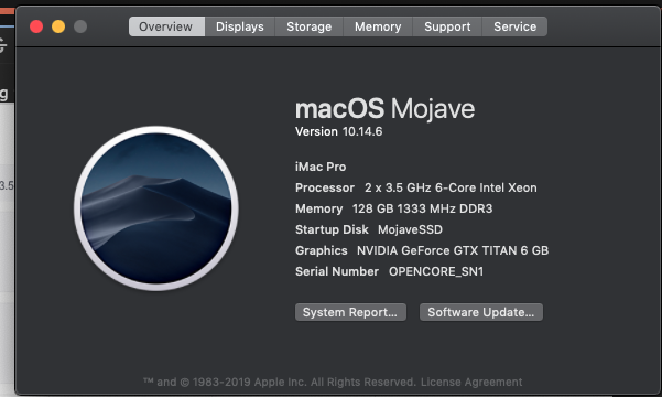

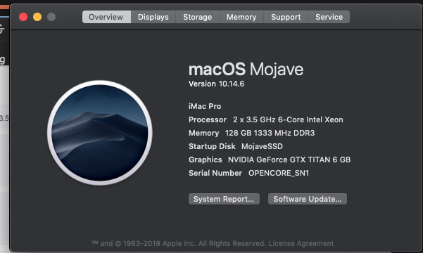

Did you removed the Polaris GPU? Did you tested if the acceleration is really working?Ok. So only changing the product name to iMacPro1,1 and updating only SMBIOS gets all acceleration:
Unfortunately :
Everything screwed up.

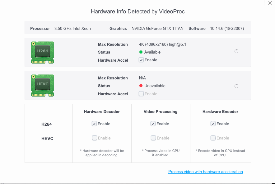

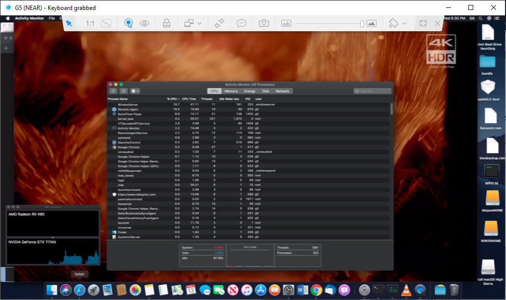

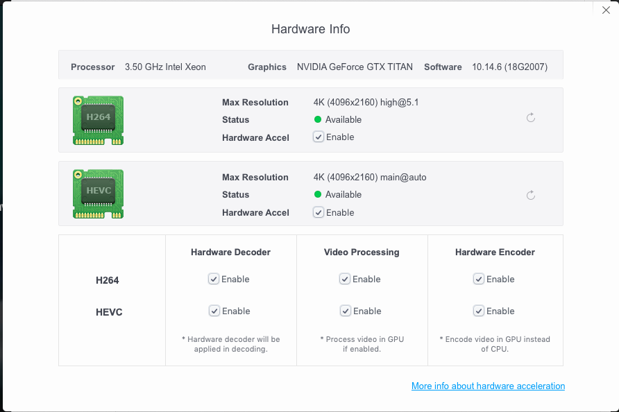

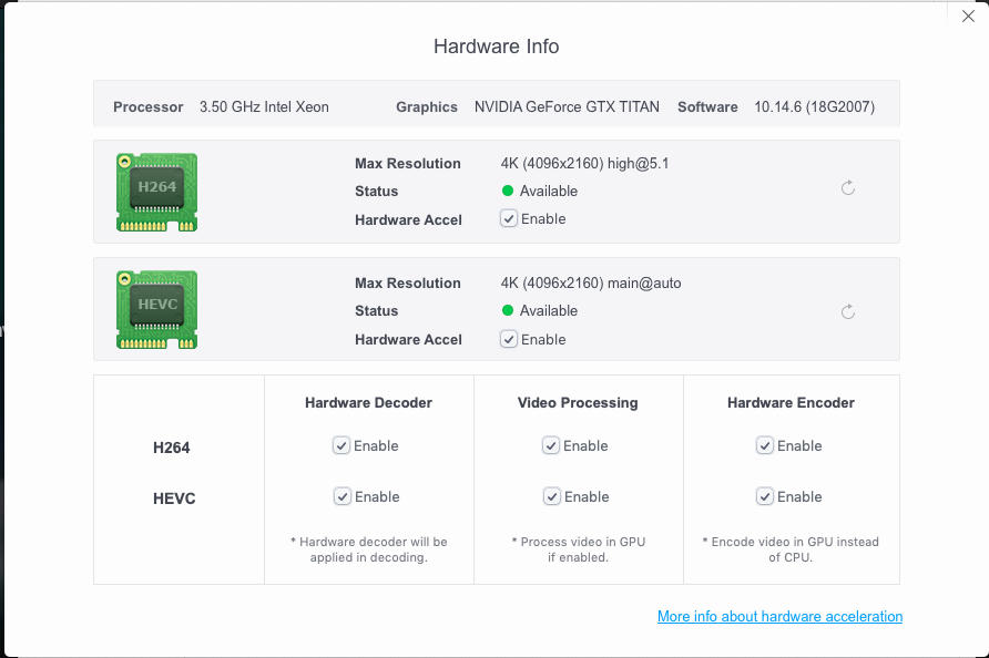

Unfortunately I am not in front of my PC ( i will remove the cards when I have physical access). I do all the tests remotely. The only indication for me is the NO CPU usage and no stuttering when playing the Swordsmith video.Did you removed the Polaris GPU? Did you tested if the acceleration is really working?
Kepler GPUs don’t have any way of HEVC hardware acceleration, NVIDIA started with Maxwell for partial acceleration. I bet that it’s using the Polaris GPU for acceleration and it’s not reporting correctly.Unfortunately I am not in front of my PC ( i will remove the cards when I have physical access). I do all the tests remotely. The only indication for me is the NO CPU usage and no stuttering when playing the Swordsmith video.
I was thinking about it, but here is the deal:I bet that it’s using the Polaris GPU for acceleration and it’s not reporting correctly.

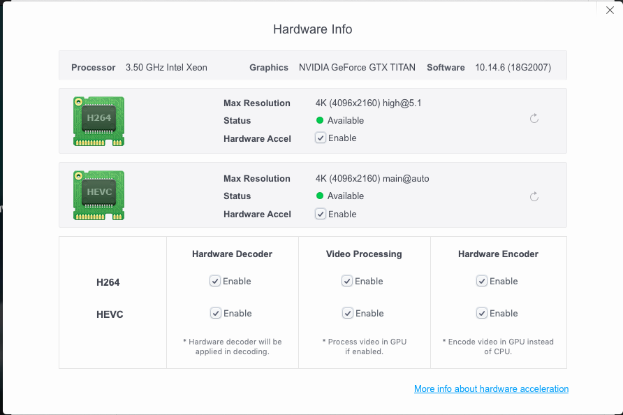

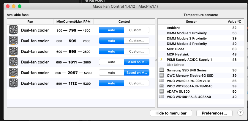

When the video was playing on the Titan or RX-580 I get around 40% Usage on the GPU,
But playing video on the GT-640 goes to 80% usage, so I don't think it is using the AMD. I may look at the GPU temperatures. What is a reliable software Istat?
I already tested that. Unfortunately my setup is odd. I have an expansion chassis in the second slot and when there is nothing in the first slot no accel.pull all but the Titan.

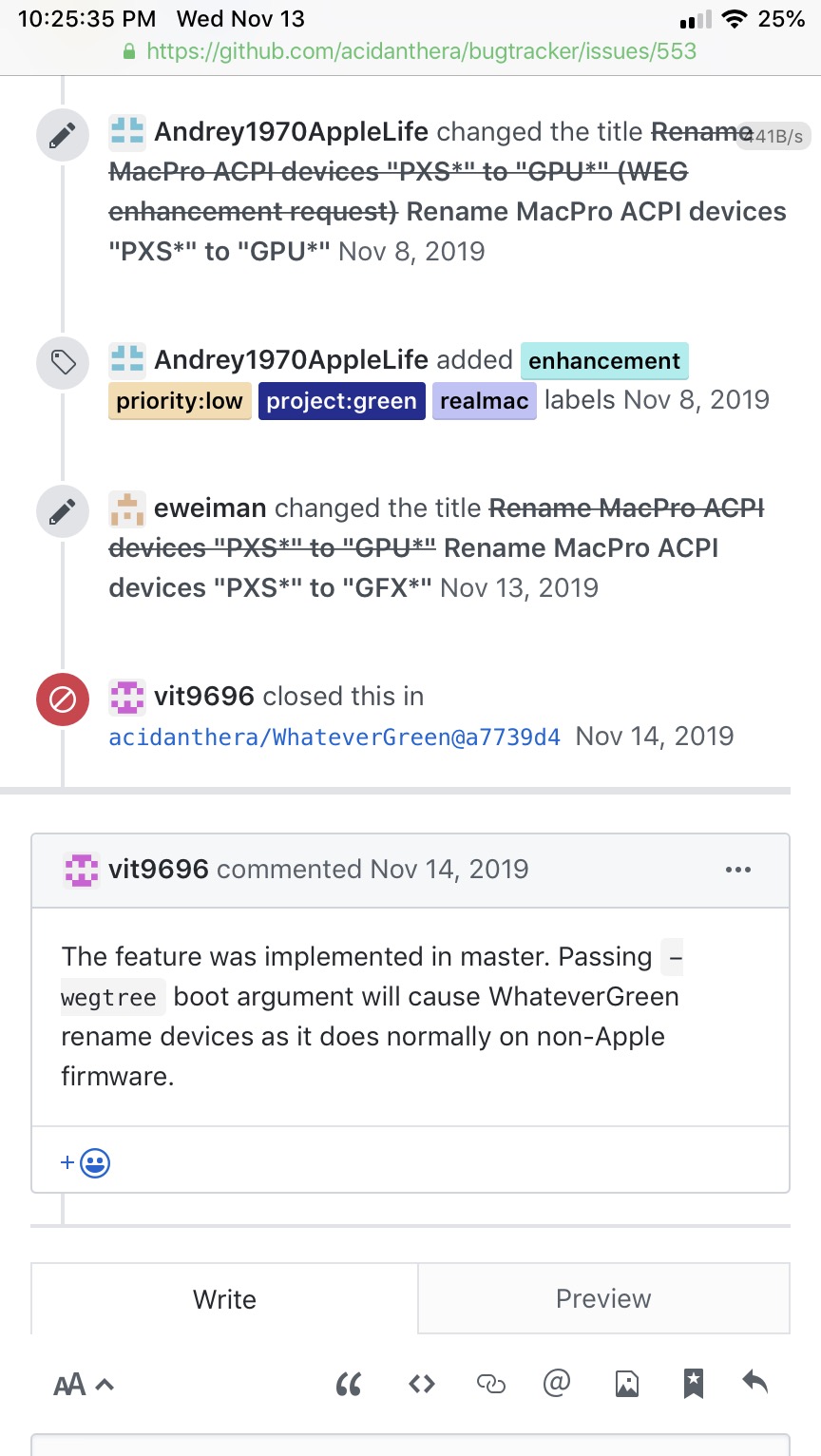

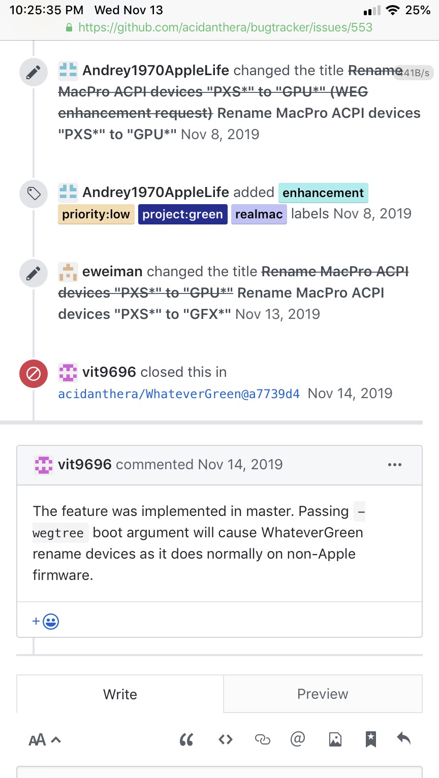

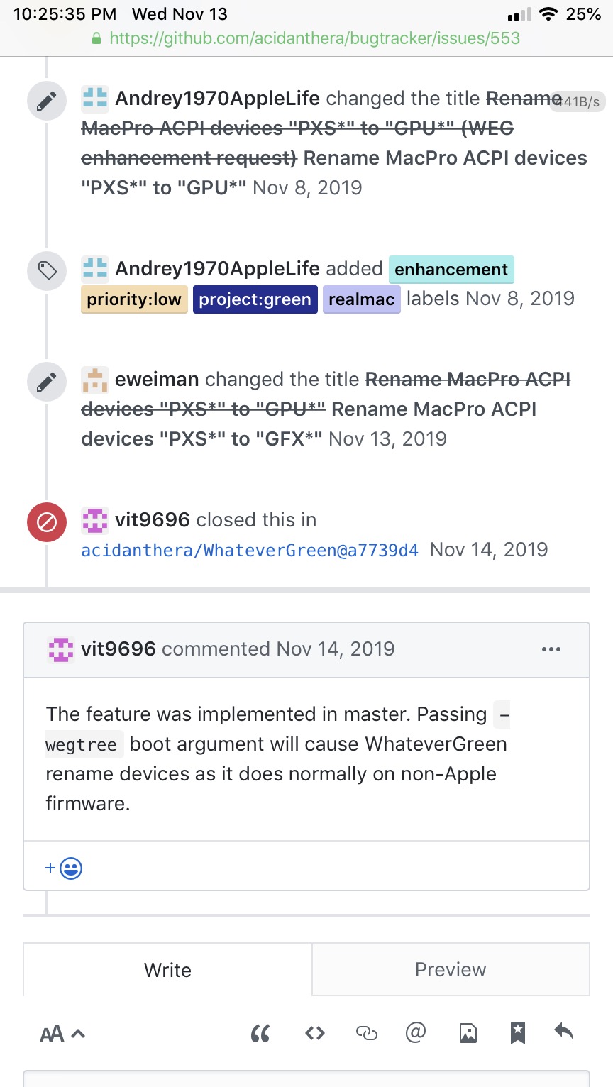

Well it looks like they did something.I've just found this. 😍View attachment 876510

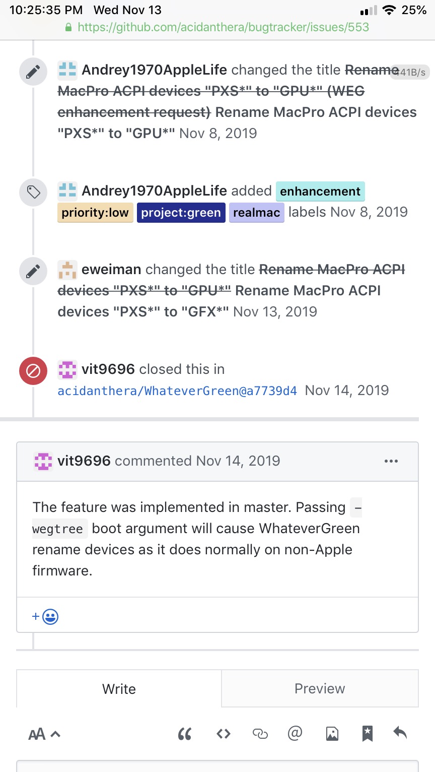

If OpenCore devs don't help us, we can help ourselvesPXS* to GFX0 rename inside the BootROM easy peasy.
Yes, I read the patch. One thing of note, maybe this helped and disturbed at the same time, since they removed shikigva that we need too.Well it looks like they did something.
Not exactly what we were thought we were looking for but maybe it will do what we need.
Maybe we will need to enable gvaForceAMDAVCDecode now.
