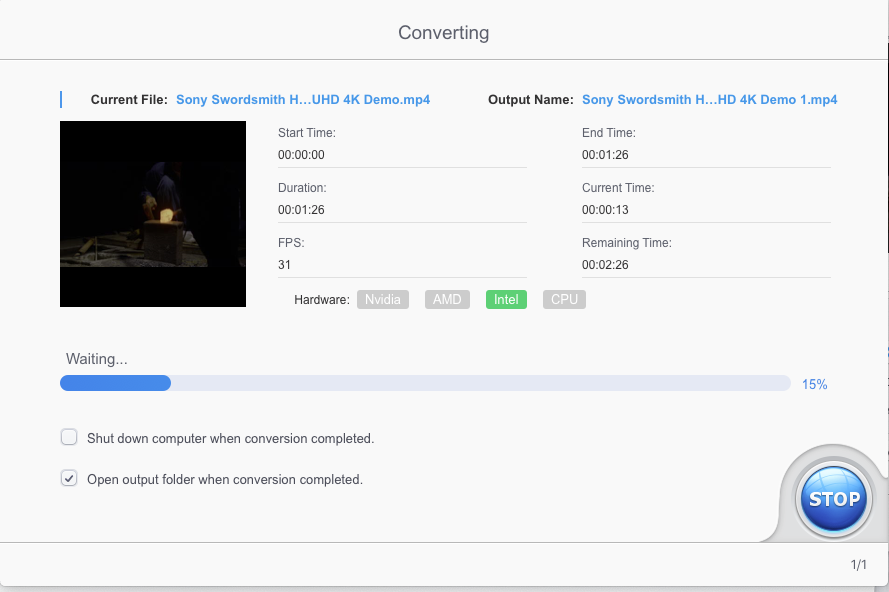

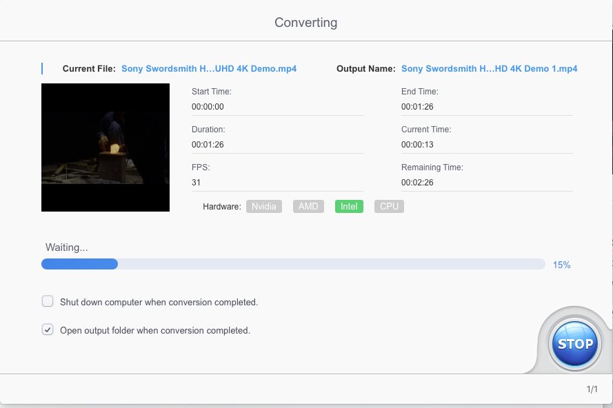

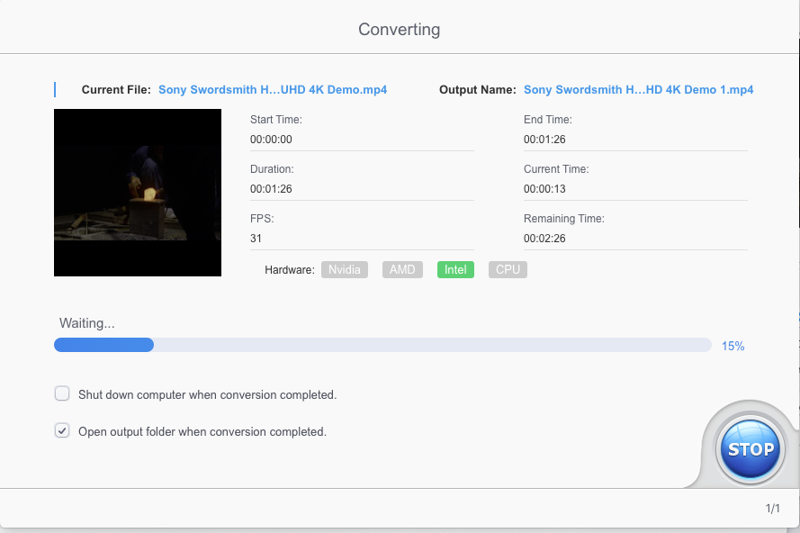

This is how VideoProc treats hardware acceleration:
Intel really?
We should stop using VideoProc and go for ffmpeg + videotoolbox. I have noticed this weird behavior too and OC devs told about it too.

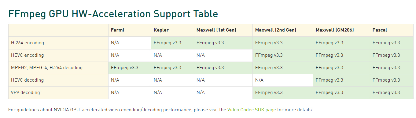

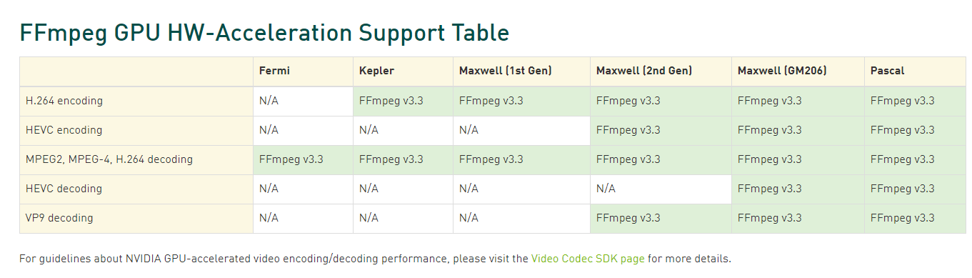

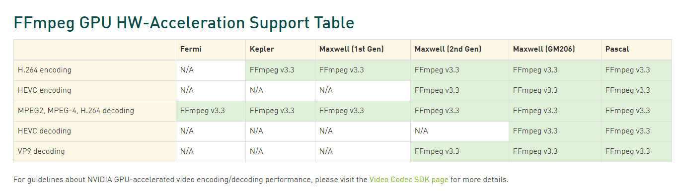

I might be chasing my tail with Kepler and ffmpeg:
That’s because Kepler can’t do HEVC decode ... it doesn’t have the hardware.
Intel really?
This is a known cosmetic error. Obviously, there is no Intel GPU on our Mac, but only the AMD GPU has the hardware to do the job.
There are three problems for the Titian to provide HEVC HWAccel.
1) As per your finding. Kepler GPU has no associated hardware for HEVC HWAccel.
2) There is no web driver support in Mojave.
3) Nvidia never provide NVENC and NVDEC support in any of their MacOS web driver / CUDA package.
Any one of this already makes your Titan impossible to decode that Sony Swordsmith HEVC sample. And at this moment, all three exist together.
