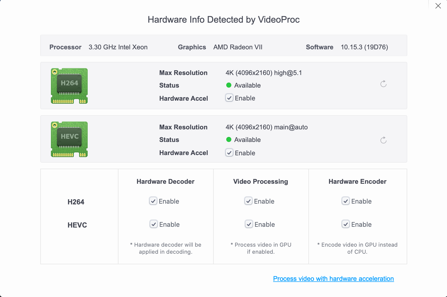

Alrighty, put my lateral thinking hat on and I now seem to have a solution. Hardware acceleration was working just fine when I had a single Radeon VII mounted in Slot 1, so after fixing my boot drive from the backup copy, I tried moving the x16 PCIe interface card for the Cubix expander from Slot 2 into Slot 1, and then mounted both Radeon VIIs inside the Cubix (so now both GPUs are connected through Slot 1).
System booted up fine, and this time the hardware acceleration worked perfectly. So now I have dual Radeon VIIs running with hardware acceleration for h264/h265 decoding/encoding. And because they're mounted in the Cubix, power is no longer any kind of an issue (though for the timebeing I'm going to keep the 204w downvolt kext in place, as I benchmarked better scores from that than running the Radeon VII stock).

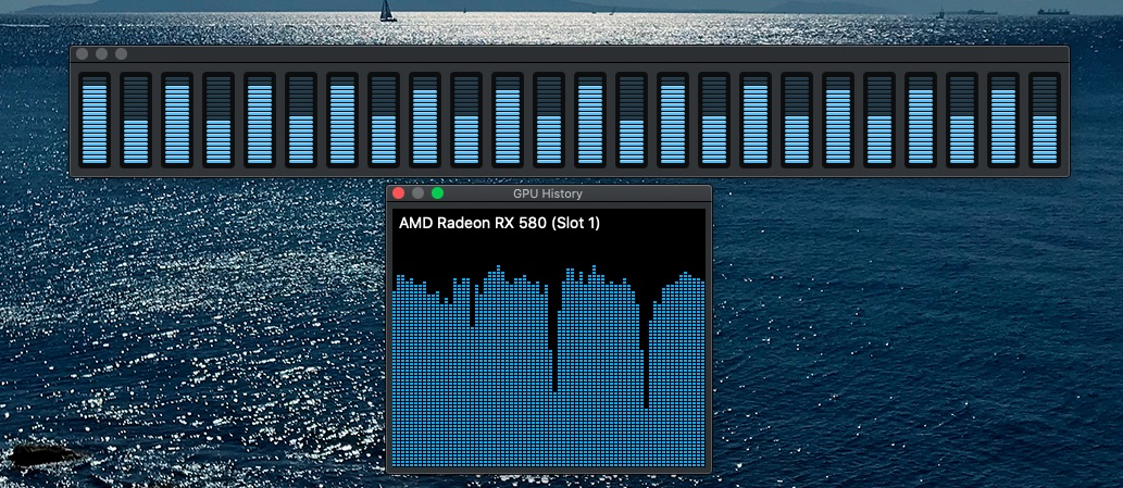

I sometimes wonder, why would anyone pay for a new macpro with the rx 580 in, if hardware acceleration for this particular gpu is disabled. I also wonder why apple are offering this particular setup as an option for what they see as "professionals". With acceleration enabled on my 2010 macpro, and a prores timeline sent to compressor to be converted to mp4, the gpu usage peaks at 70%; without it it only goes up to 7%. That is on FCX and macos 10.15.3. The whole situation is a bad joke, unless apple plan to re-enable acceleration in a future update of catalina.
Does enabling HWA actually speed up your work, though? If it does, then yes it is indeed downright stupid for Apple to be disabling it!
Still thinking about enabling it on my BOINC 5,1, I'd be able to tell if it was running any faster by seeing how long it takes to finish a GPU work unit.
If it actually winds up improving work unit time as much as Apple's gradual tweaks to OpenCL / Metal itself I'd have to say its ridiculous for Apple not to implement it across the board, unless its something that causes the GPU to heat up faster. It's not like it's not an issue for laptops, but in the new Mac Pro there's just no excuse to not have it when you have an industrial strength cooling system to make up for it! Unless Apple feels it would shorten the life of the GPU or something.
