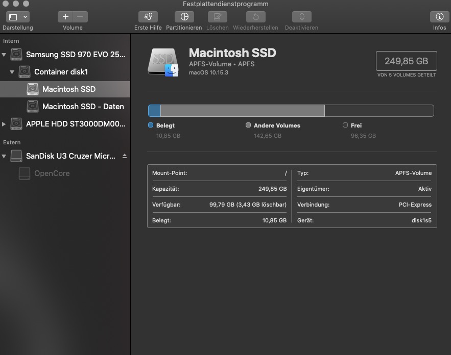

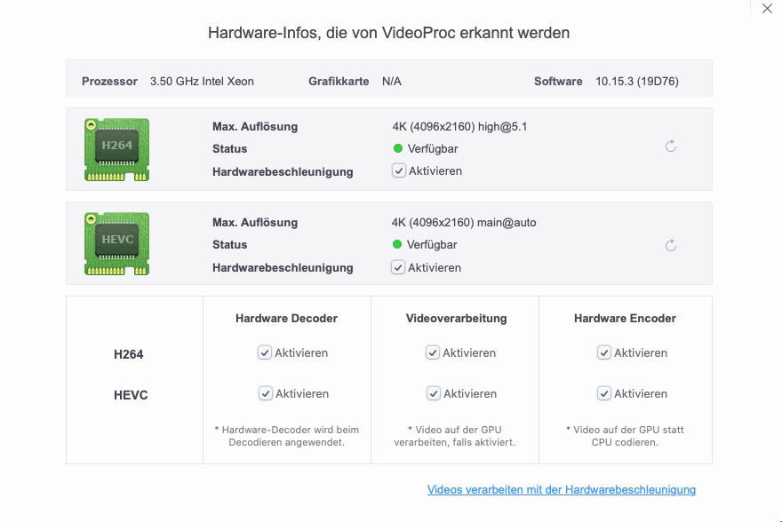

Switched to OpenCore 0.5.6 on USB Stick (thanks to h9826790, Nighshift enabled, HW Acceleration top, BootPicker works well), Windows 10 EFI Mode

works great for me so far! Thanks!
EDIT: Still no bootpicker though..How do I have to proceed with bootpicker if I have a legacy win10 install? select it or trash and just create usb uefi win10 installer and insert and boot with bootpicker to usbinstaller and redo it?
Config: Installed OC on 4GB USB 2.0 Drive plugged in in lower front usb
Reactions: zoltm and h9826790

I just installed this.. what a relief to get a boot picker that gets my Sapphire Pulse RX 580 to throw up that beautiful grey screen immediately!
Everything else is working as advertised. Netflix runs like a dream. So far no changes to my BOINC render time.

I'm able to play 4K content in Google Chrome with no problems, highest CPU gets is 50% and GPU gets is 27% on 8K videos. Trying to play 8K vids results in buffering/stuttering.
The 1.5 GB, 400 Mb/sec 4K HEVC Jellyfish file plays in Movist Pro smooth as butter. CPU never climbs above 3%, GPU 25% as measured by iStat Menus, and with no other app running.
