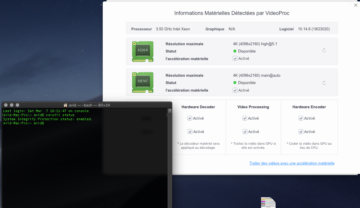

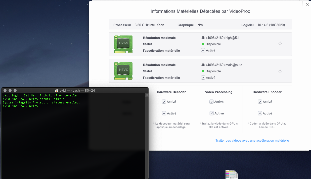

Finally got the xserve up to date with 10.14.6.
Using OpenCore 0.5.5 boot method and replaced GT120 MXM card with WX4150 MXM (flashed with @Nick [D]vB's rom showing as Radeon Pro 560X) gets about 13.7k metal score and 13.1k openCL score in GB5.
VideoProc reports both HEVC and h264 encode/decode.
Netflix in Safari works with no DRM issues.

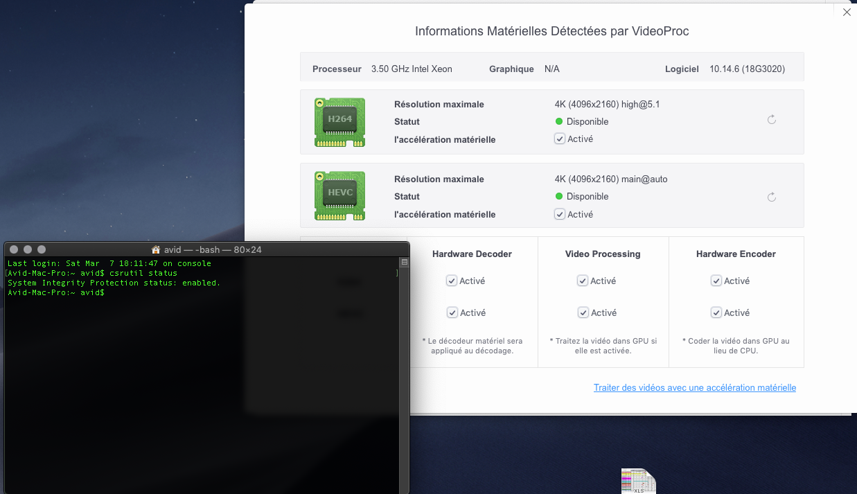

Ok it was "that" easy!
I refreshed my RX580 with its original ROM (thank god I kept a copy before modding it!), and reboot and voilà: boot picker and early boot screen.
I also re-enabled SIP by rebooting in the Recovery partition, and upon reboot into the main partition, I still have HW Acceleration.
It didn't work first time so I ended up rebooting without the USB Stick into the Recovery partition with CMD-R, and then I plugged the USB Stick and blessed it from Terminal in Recovery. When I rebooted, I had the boot picker.
Thanks again @h9826790 and everybody involved in the OpenCore development! This is amazing. I'll start saving for a Radeon VII which seems the ultimate option for a Mac Pro 5,1 - it only works in Catalina, right? I'm in no hurry... much prefer Mojave which went through more updates so far.

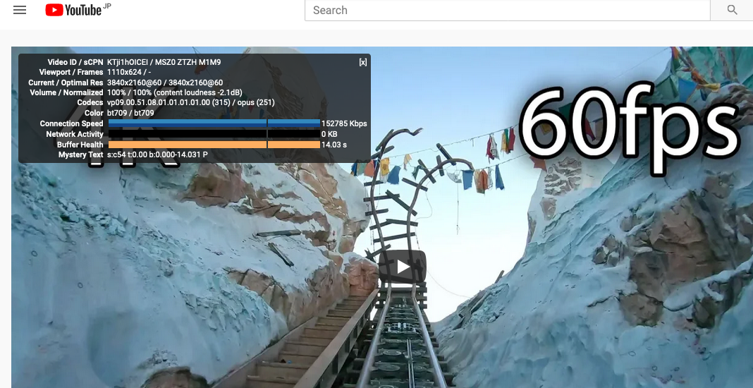

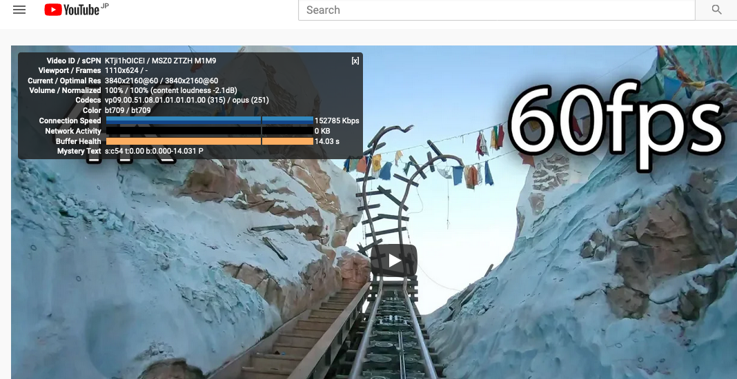

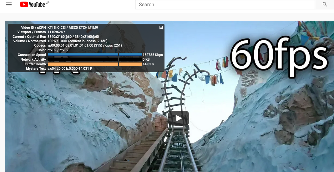

I finally got round to giving this a try with my non-EFI MSI Armor RX 580 8gb.
Followed Post #1 religiously with SIP = OFF.
Used Lilu Version 1,4,2 & Whatever Green 1.3.7
Rebooted but only got H264 working. No HEVC
Went through 'almost' all the posts but no joy.
Monitor is 1080
Anyone have any ideas ?

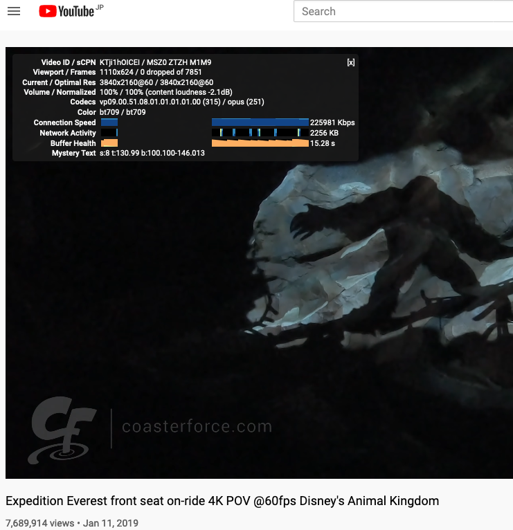

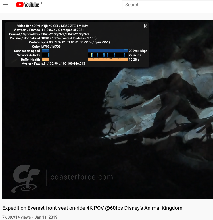

When you right click that video in stats for nerds what is the listed codec?
Reactions: Eschers
vp09.00

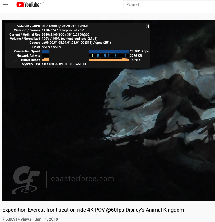

[automerge]1583608344[/automerge]

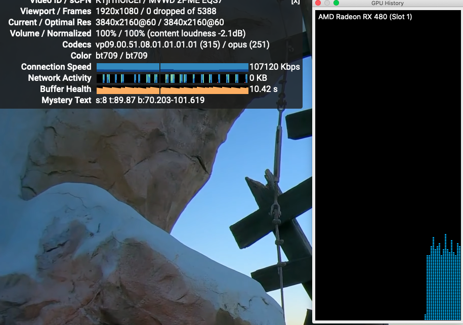

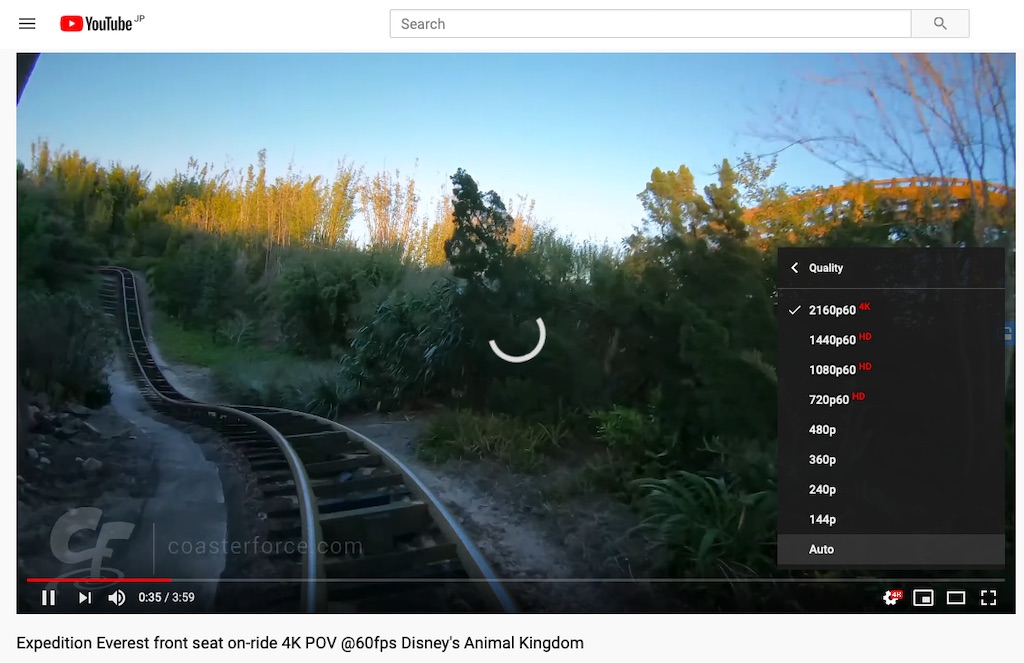

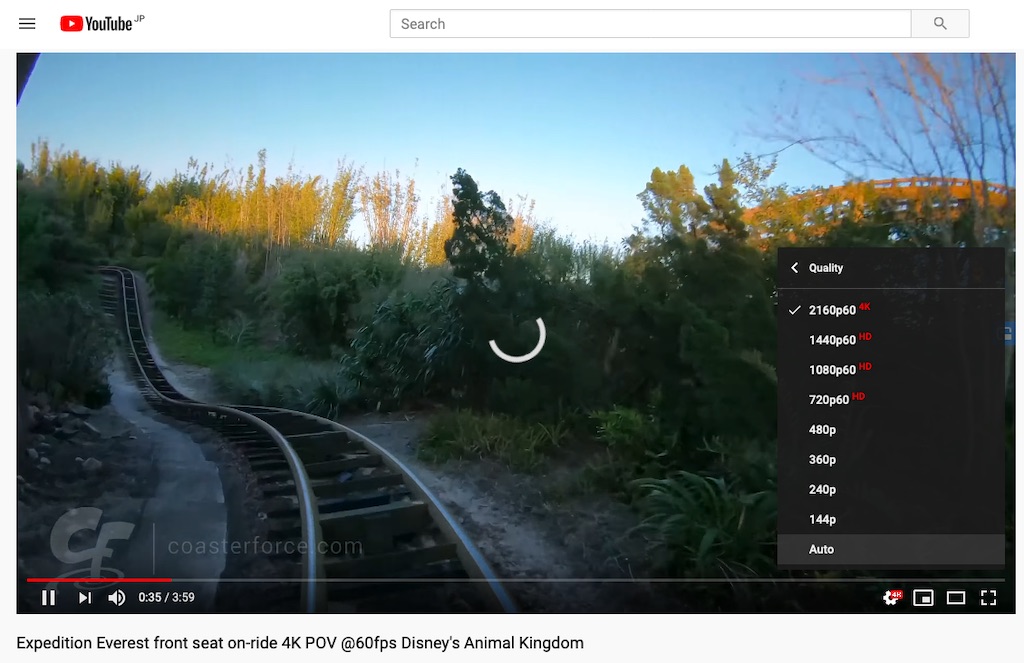

Actually, I uninstalled Lilu & WEG last night but just ran the video in 4 k ( no Lilu or WEG) . . . but I let the buffer fill up before hitting the 'play' button .. it ran butter smooth in full screen.
Is this normal ?
Reactions: Eschers

vp09.00
Is this normal ?
This is with OC and WEG.
VP9 is not HEVC. VP9 is not supported in OS X. It may be be supported by Firefox to an extent but generally the performance in OS X is subpar. See this:

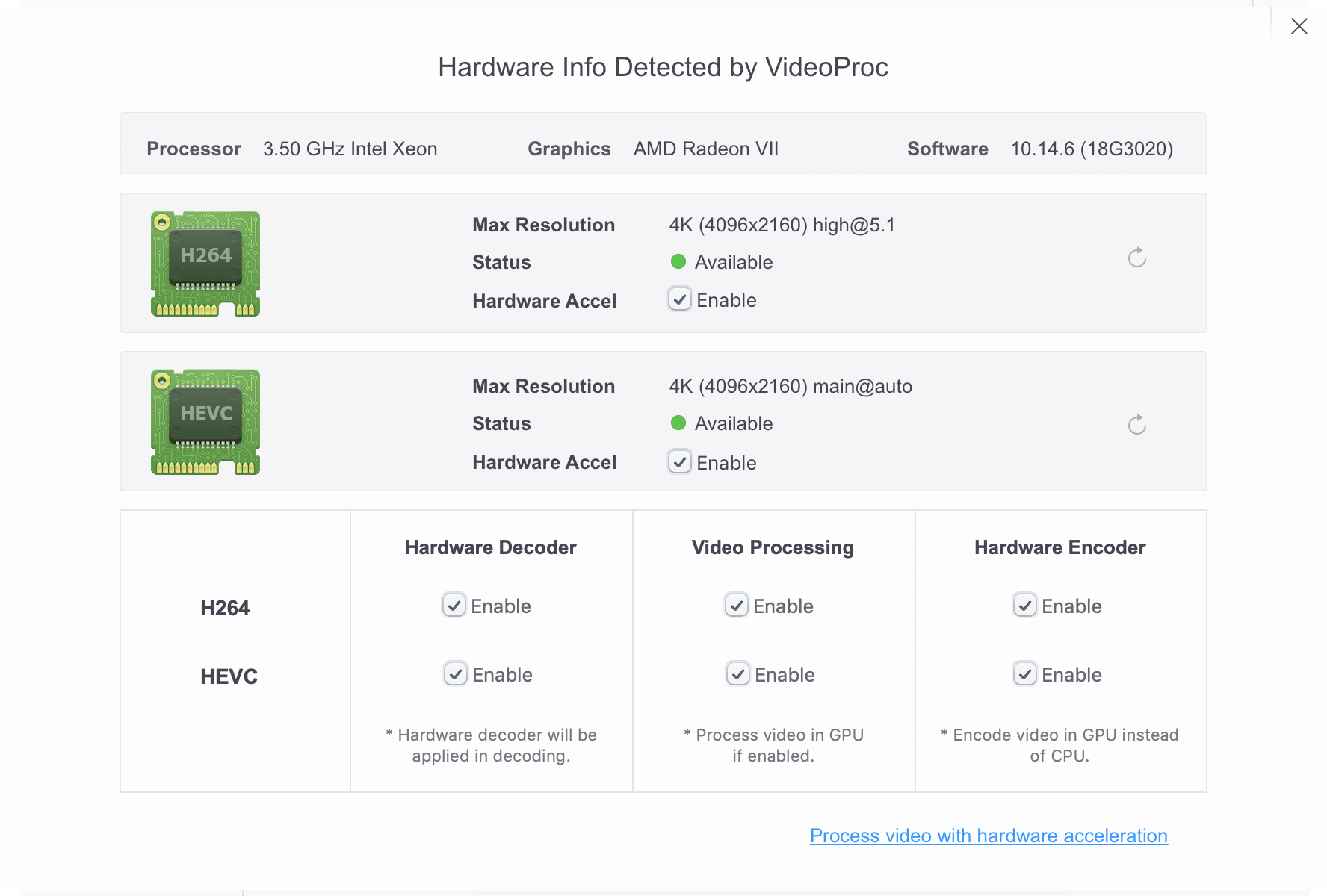

Radeon VII can work flawlessly in 10.14.6

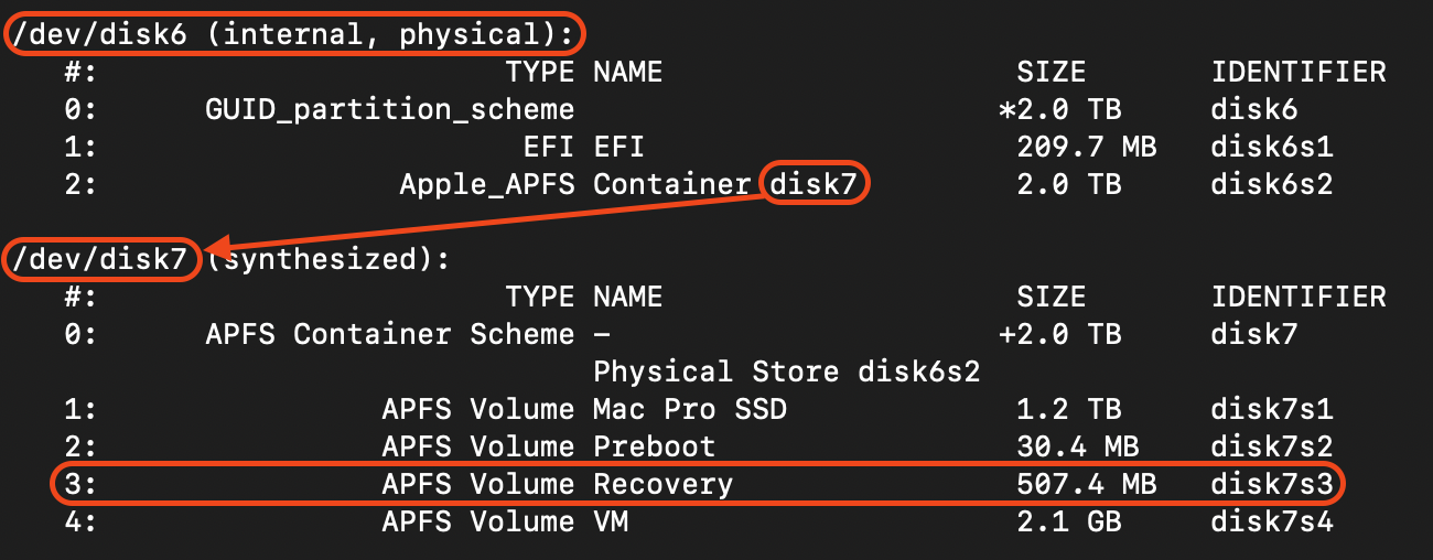

should I try 3-times NVRAM reset and starting the whole thing from scratch if the two dont work?
EDIT: I am usually doing SIP disable and stuff from a mojave usb install since I have never managed to get to the recovery boot. Somehow either I land in the OS or no screen at all (wired apple keyboard)
EDIT 2: a quick check via diskutil reveals that on the m.2 nvme samsung drive is no recovery partition. Always did reinstalls (last one January 2020) with a usb stick. Any steps I missed?
The Recovery Partition is inside the container.
