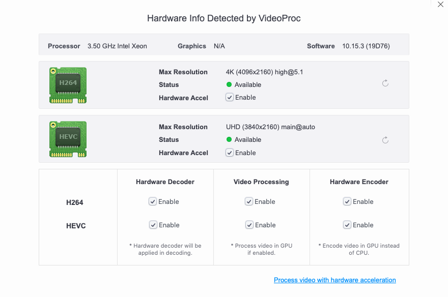

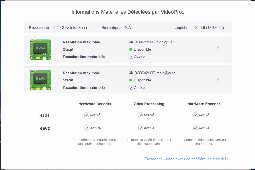

And now it's working =-) CATALINA 10.15.3 with full HEVC capabilities and Boot Picker menu!!!
Big thanks to h9826790 and Startergo !
Full H264 and HEVC video processing !!! :cool:

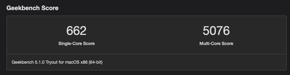

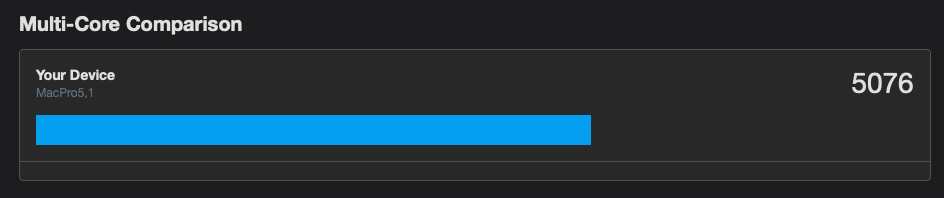

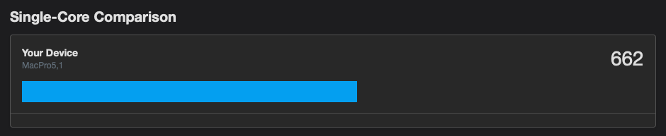

This is the GB test results
CPU

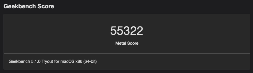

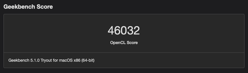

And the GPU results

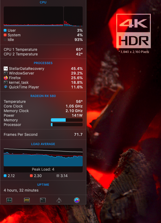

Now the Sony test video play back smoth :apple:
