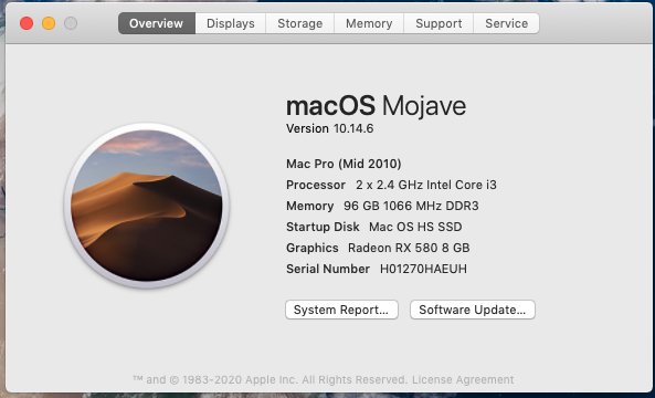

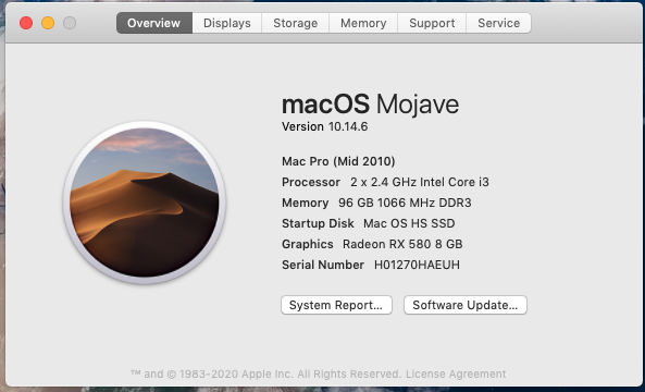

After doing everything it says I'm using 2 intel core i3 also I don't have a boot screen, would that mean my rx580 pulse has a custom firmware?
The theory is that for balance GPU use both GPUs have to be the same.

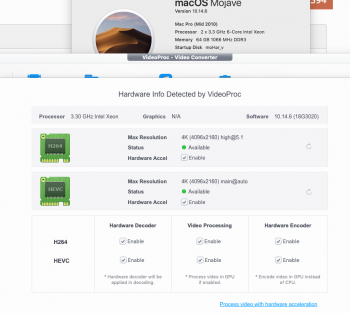

Hi - I used your OpenCore setup from post #1314, except replaced Lilu and Whatevergreen with updated versions (1.4.2, 1.3.7). I get the Boot Picker, the Bootscreen (monitor loses input just before Finder appears but comes back fine) but no hardware acceleration for h264/265 at all. VideoProc reports neither available. NVMe report as internal, I am not able to check all the other 'features' as I dont have Catalina installed, any DRM accounts, no usb superdrive, don't use Windows other than virtual etc
Any idea why no hardware acceleration - the one thing I really wanted!

Please make sure you read post #1 Q29
Ah - missed that! Thanks, now its showing green 🙂 Thanks for simplifying this all for folks like me!
It lists the card (RX580) as "N/A" in that window though. Not sure what thats about.

My xserve does that as well, it comes from the OpenCore smbios injection. my cMP 3,1 showing cpu unknown when booted via OpenCore with smbios injection on, so we have to inject the right cpu ID in the smbios.
The xserve 3,1 (essentially a Mac Pro 4,1) also has cpu detection issue when doing smbios injection but it shows core i3 CPUs as opposed to unknown. Adding the correct value to smbios inject corrects them back to quad core xeon.
Credit to @Dayo for finding and fixing that for the cMP 3,1. Which is how I also fixed it on my xserve (they each use a different value even though both are Xeon quad cores)

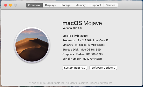

How would I change the cpu id in the smbios? I try to use clover configurator but when opening the config file everything is blank and creates a blank config.
