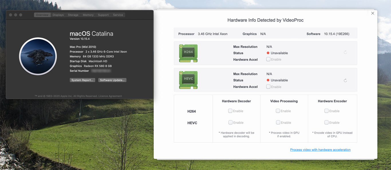

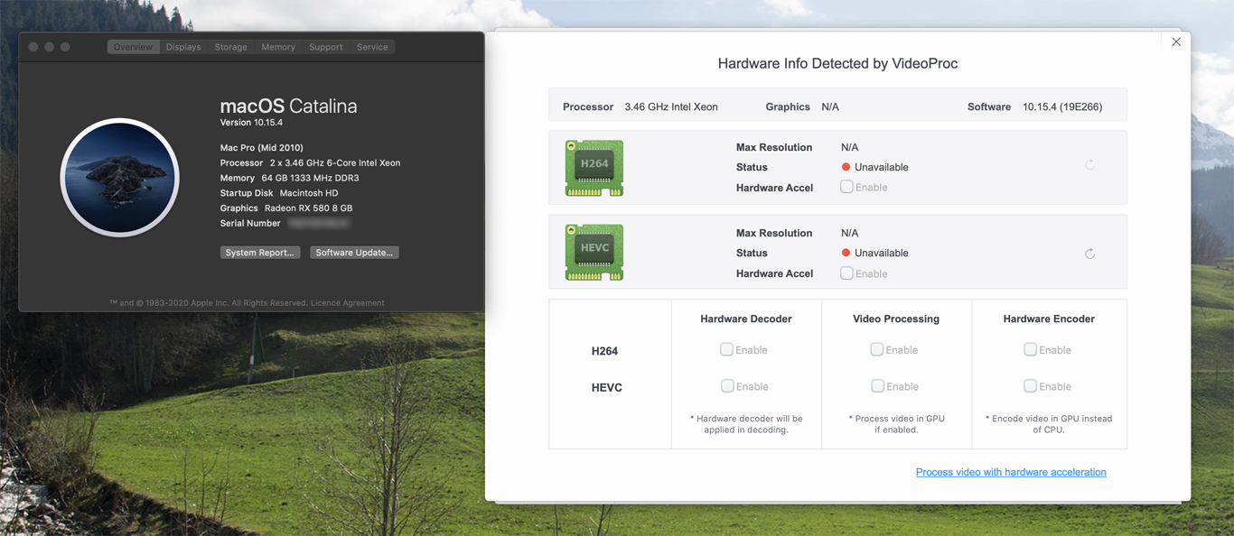

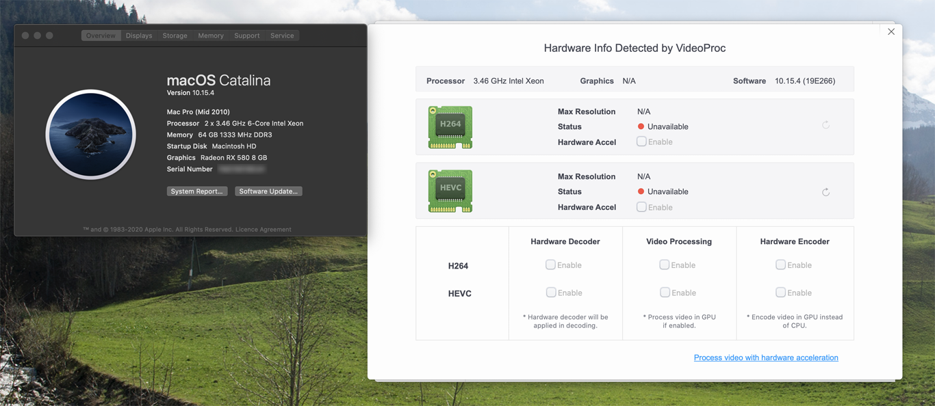

I can boot in all drive now but seem hardware decoder not enable yet.
Thanks h9826790
To activate HWAccel, You need to have Lilu and WhateverGreen installed. That should be in my package already. Please double check it (of course, you need to mount the EFI partition). If not there, you can follow the instruction in this post to download and install them.
Once you confirmed Lilu + WEG is installed, go to the OC folder in EFI partition, and open config.plist with a text editor. There are 3 parts need to be modified.

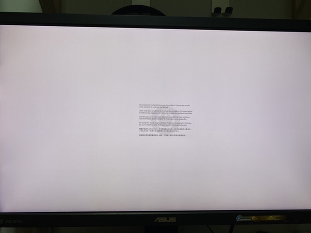

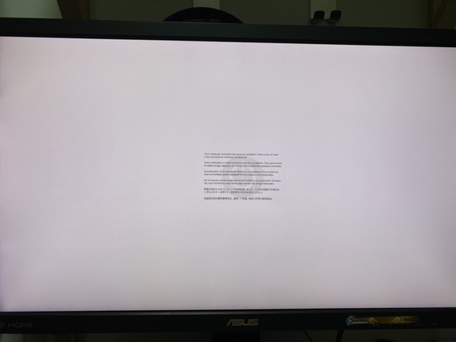

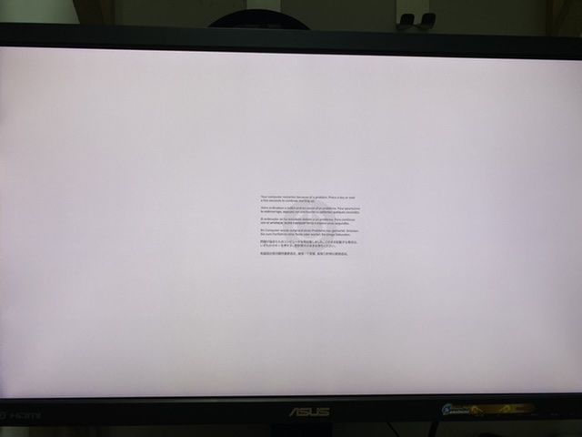

changed and reboot result same boot after apple logo will reboot again
added -V and all drive cannot bootup, boot screen gary screen but no apple logo and many coding in boot screen and some showing fault, reboot and loop.
Tonight, I will boot it from Mojave and return to cdf config file first.
cdf config is the only config I can success boot right now to bootup but no hardware decoding...
This is hard~ haha

I have installed Teamviewer in system and I have seen my machine is online now but it cannot be login.
I believe it is because it hold in the error shut down, reopen app question screen and not enter to desktop.
There is very strange that the machine will endless reboot but sometime it will enter the system...
When you reboot, it will endless reboot again until suddenly success again...
