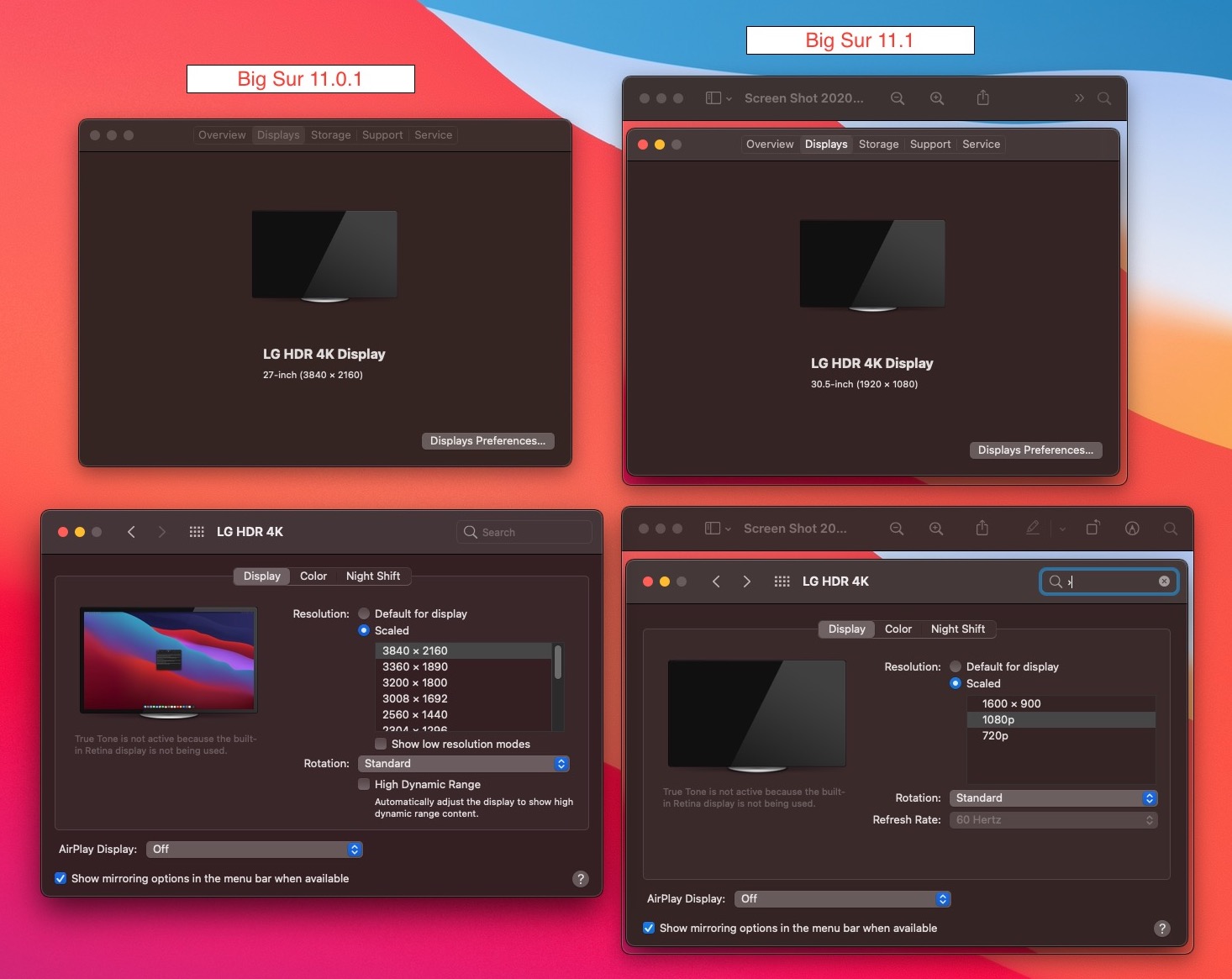

The problem is simple, after updating to BIG SUR 11.1, Apple programmers "broke" something and since then BIG SUR no longer recognizes external 4k monitors via direct ThunderBolt 3 connection!
Here is the example image (taken from the Apple discussion forum), since then a slow agony with consequent productivity problems towards professionals who are no longer able to work as before.
This causes problems of incorrect resolution, completely wrong monitor size and frequency always at 30hz. Practically the monitors are UNUSABLE!

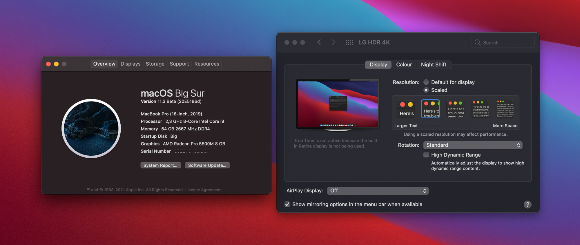

Guys, perhaps the latest beta of macOS 11.3 (build 20E5186d) has fixed the bug with the resolution of the external display. I restarted the MacBook Pro 16" several times. I turned it off and on after a while and it is .... ok! :) I even turned off the monitor itself. Nothing decreased resolution. I hope this is not spoiled to release the final version!
Holy-moly - I could finally dare to upgrade.
Hope they really have fixed this issue. I'm on 11.2.1 with my 16" MacBook and I just restarted my Mac serval times, even reset the SMC to get the port back on recognise there's an external monitor...
I'll cross my fingers that this does fix it. This all started in Catalina so after nearly 15-18 months it would be great to see Apple fix this. My MBP got relegated to being on the bench due to all the issues with trying to get a reliable working mac in an office style environment. Mojave worked fine but I ended up having to move to windows for a daily driver. So if Apple have finally fixed all the display issues I may be able to return to using my MBP. I watch this thread hoping. It would be good to see some AGDCDiagnose results.
I can confirm that it is improved with 11.3
First i got a black screen with usb-c, after next reboot i got 4K30, switched a little bit around with resolution and rebooted several times and after a while it seems to be stable with 4K60 and 10Bit.
So its still a bit buggy but no comparison to before....
