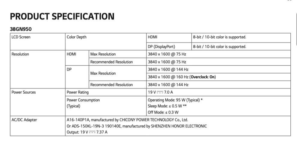

Regarding your spec your monitor should be at 144hz with DP (if not your Thunderbolt Dock is not supporting DP 1.4).I use an LG 38GN950-B monitor that was working fine through the upgrade to Big Sur version 11.0. It's connected to my 16" MacBook Pro (early 2020 build) through a Thunderbolt dock, and from the dock to the monitor via DisplayPort.
This monitor's native resolution is 3840 x 1600. My MacBook Pro normally drives the monitor at that resolution at 75 Hz in HDR mode. Upon upgrading to Big Sur version 11.1, I could no longer convince macOS to offer resolutions for the monitor above 1080p. I tried the various tools suggested here and in the Apple Support threads (e.g. DisableMonitor and EasyRes), tried dropping down the DisplayPort version from 1.4 to 1.2 and even 1.1, restarting and reconnecting everything in various orders, all to no avail.

Currently with Big Sur of course any Display Port connection will not work as intended. In some cases its a bit better or not (e.g. with my monitor DP 1.2 was ok but showed some weird informations and was limimted to 30hz).I'm on my third Thunderbolt dock now—first, the CalDigit TS3Plus, then the Belkin Thunderbolt 3 Dock Pro, and now the Plugable TBT3-UDZ—and none of them have allowed my monitor to get past 75 Hz. Both the Belkin and the Plugable have been using DisplayPort 1.4, at least according to my monitor. I haven't found any settings that suggest that going to a higher refresh rate is a limitation of the monitor. Plugable does say that they don't "support" any refresh rates higher than 60 Hz, though I don't think the dock is actively preventing exceeding that.
I do see a setting on the monitor called "HDMI Compatibility Mode," but it's already disabled. This current HDMI cable is one that I dug out of a bag of old cables, so it may predate the 2.0b standard you mentioned. More concerning to me, though, is my return to using DisplayPort. Can you think of what else I can check to understand what's holding back reaching a higher refresh rate?
With most of the docks you have to be carefully they really hold their promises. In your case e.g. the Calldigit even clearly specified they just support DP 1.2 so it is limited. I would always first check a direct cable connection (a cable like this is not even really expensive (about 15-20). For some reason the the TBT3-UDZ supports DP 1.4 but officially doesn't support more than 60hz in any resolution....There's a Reddit thread that describes much the same hardware that I have, also facing this limitation.
