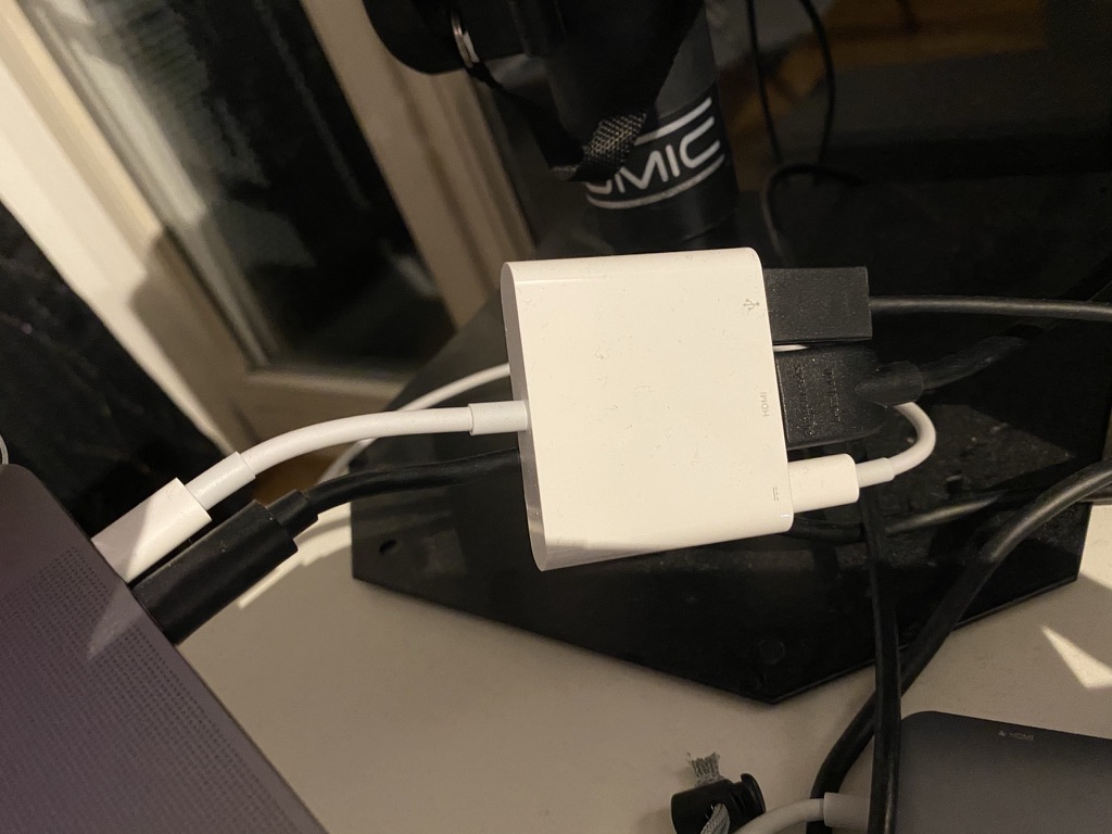

As i said after i got the HDMI Apple Adapter for free i have everything working (power delivery, usb-a and display at just one usb-c port). I can live with this solution by apple until they fix the problem.

the best thing is the original apple adapter i got for free from apple because of this problem:

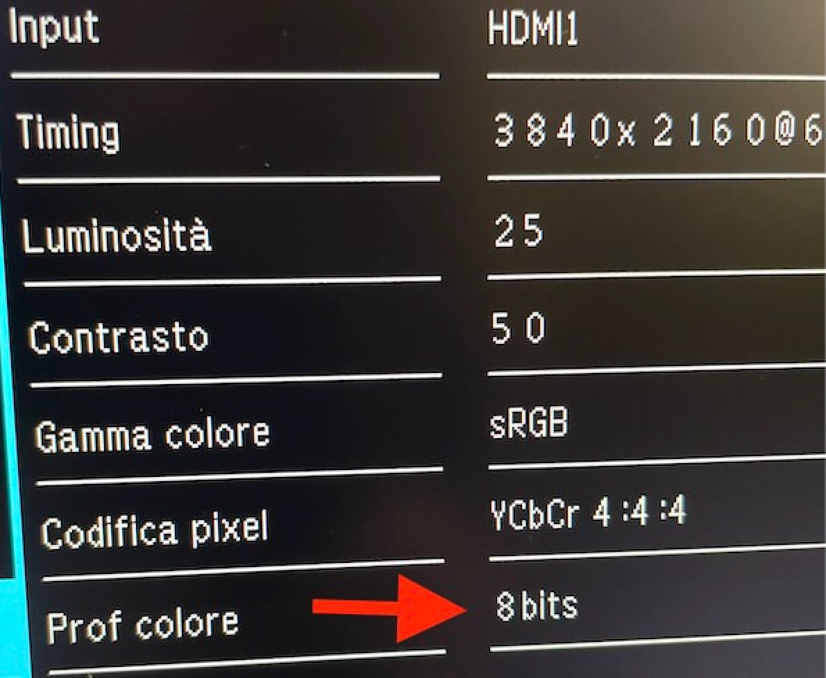

I tried 2 hdmi cables at 60hz 4k bought on amazon and connecting them to benq they go to 8bit, I asked the cable manufacturers and they also say that those cables are 8bit. Apple please resolve the thunderbolt 3 display issue! I can not stand it anymore.

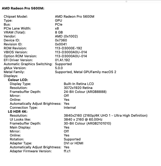

And as you can see at my MBP 16 with HDMI connection instead of my USB-C there is no problem with 10Bit:

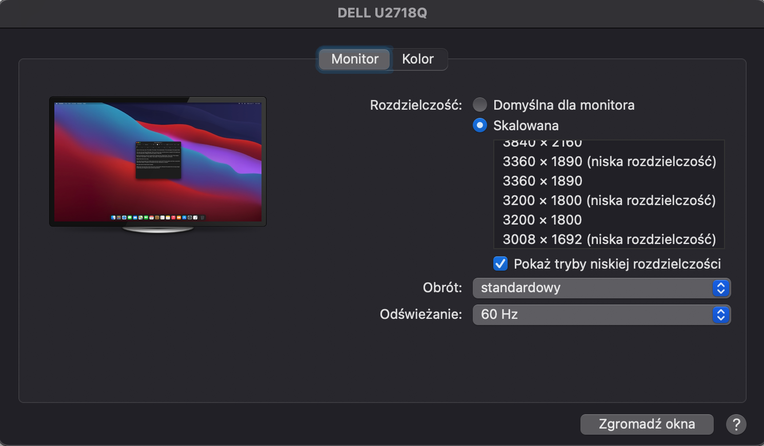

I was able to turn on the 60Hz option after clicking with alt-option on the text "scalable", after checking "show low resolution modes", below there is a list for refresh rate selection -> 60Hz works.
Cable: HDMI -> USB-C
Monitor: Dell U2718Q
macOS 11.1

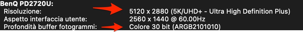

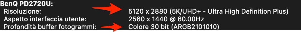

first point, wrong resolution (big sur fails to detect the correct specifications), monitor is 4k, color depth in theory that is 10bit, but via hdmi with this cable: https://www.amazon.com/gp/product/B075V5JK36/, i also asked the manufacturer and it is an 8bit cable.
in fact in the monitor screen it is unfortunately 8 bit
:confused:
