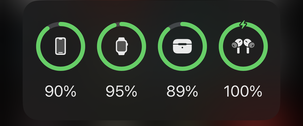

Same here. I think it’s a feature? I listened yesterday evening putting everything back in its place and woke up and the earbuds and case show up in my battery widget. Case lost about 10% overnight.
I’m having this same issue glad I didn’t create a new thread. Picked mine up yesterday and the battery has been draining in them overnight.
Not only that even when I put them in the case they don’t disconnect and I can switch audio to them 😂. Maybe they are always on to locate in find my?
Regardless I don’t want them connected or in the widget all the time as my other products don’t show battery life.

It’s such a stupid implementation in my opinion.
I’m not even using them and I can see the battery life of the case and I’m unable to see the battery life of the AirPods I’m actually using at the moment.

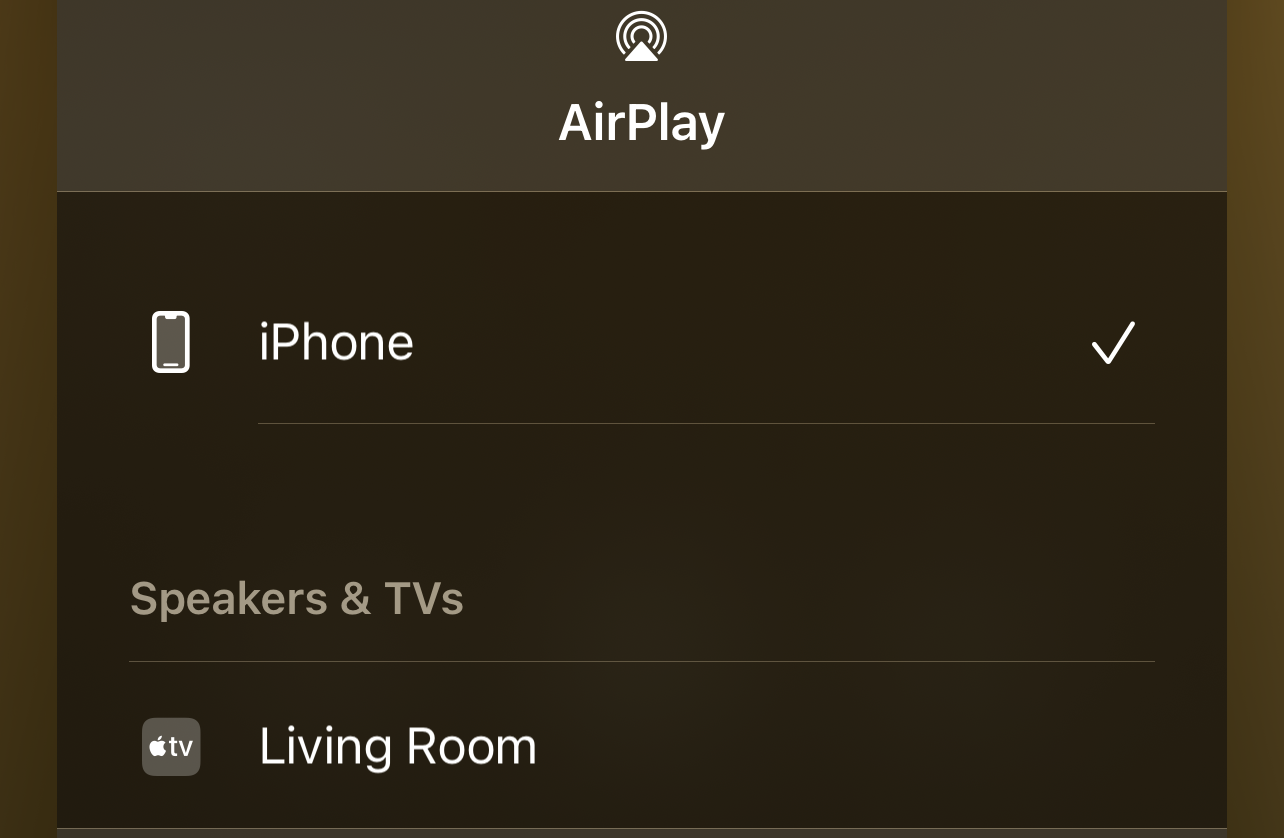

Wow that’s weird.
It won’t let me play to them despite them showing up in my battery widget:
And just an update since my last posts, the battery drain has all but disappeared. I haven’t charged those things for days - I get almost no standby drain anymore despite using them several times yesterday.
Took a bit of getting used to.
