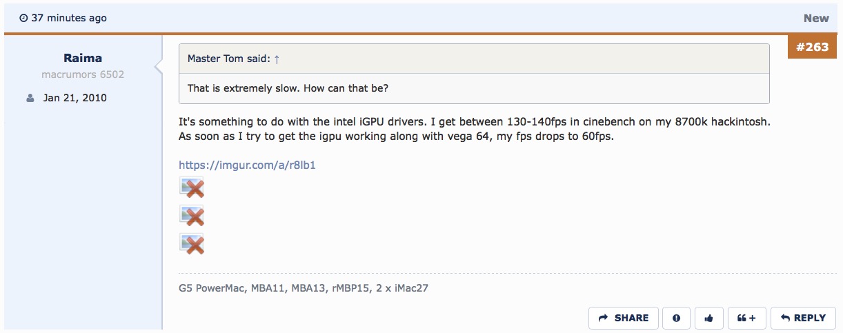

It's something to do with the intel iGPU drivers. I get between 130-140fps in cinebench on my 8700k hackintosh. As soon as I try to get the igpu working along with vega 64, my fps drops to 60fps.
https://imgur.com/a/r8lb1
r8lb1
r8lb1
r8lb1
Can't see the pic. may be some permission issue.
