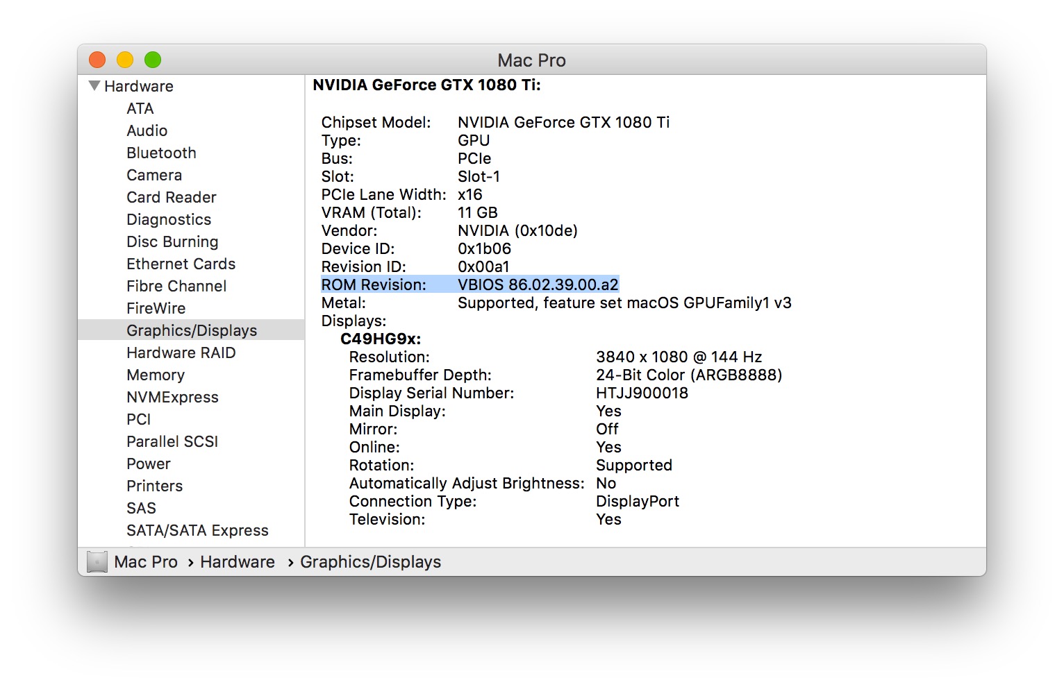

The VBIOS version should show up at here.
Actually I must admit, I don't know exactly but it looks like that is the one.
Couldn't really find it :(

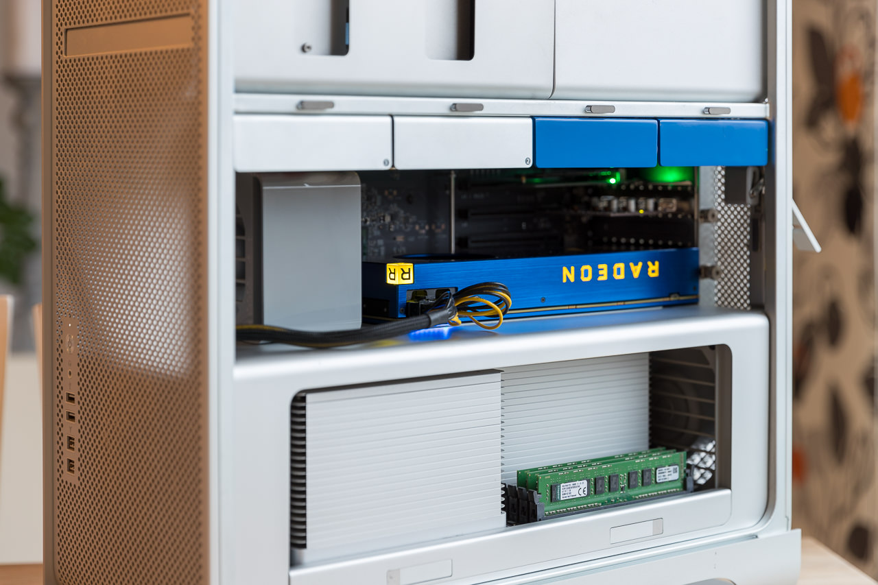

I've got a Vega FE running in my Mac Pro now. Probably temporary. Booted no problem but I've also got the fans running too high. The card isn't hot. Too bad... I found a used card and might keep it since it looks so sweet in my Mac, but I'll probably replace it with another 1080 Ti for more 'bang-for-buck'.

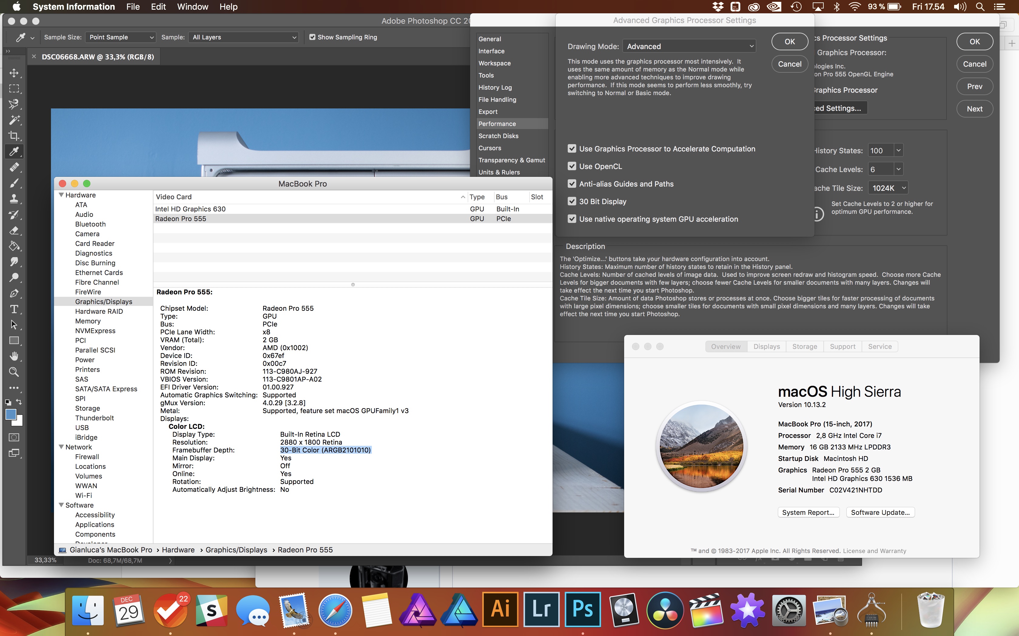

Theory which is actually verified by this screenshot! (it's a 2017 MacBook, but still valid)
No, I'm afraid not.
Interesting that your MacBook Pro screenshot shows 30-bit display. Never seen that marketed.
Mine is 24 (8 bits per channel).
I know, mine shows 8Bit too.. when the iGPU is in use!
My theory is that Apple switches on either a driver or something, after the dGPU is used (e.g when I opened Photoshop)
Try with yours

Depends on the screen. Polaris GPUs on MacBook Pros show 8 bit when using the laptop screen but 10 bit if using a professional or supported monitor.
Photoshop shows the 30bit option no matter what. It's a dithering technique for proofing managed by the Mercury Engine.
