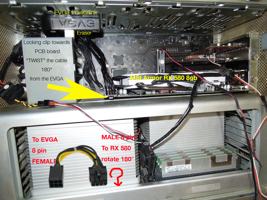

Regarding the EVGa Power link. I use it as BRIDGE for my MSI RX 580.
For cards with two 8 pin sockets in the middle of the card.
1.
Mount the EVGA Powerlink on top of the front PCI / SATA drives area INTAKE fan and secure it with a clean eraser cut to size to give a firm grip.
Like this . .
( bear in mind that this setup is for a single 8 pin RX 580 8gb. ) ..
From the cMP to the Powerlink
2. ( For the 1st. Powerlink INPUT socket )
TWO x mini 6 pin to 8 pin Powerlink 8 pin "INPUT" socket.
3. ( For the 2nd. Powerlink 8 pin INPUT socket )
TWO x SATA to 8 pin to the Powerlink INPUT.
From the PowerLink to the dual 8 pin socket GPU
3. Female 8 pin to MALE 8 pin 1st. GPU 8 pin.
4. " " " " " " ditto.
DONE
