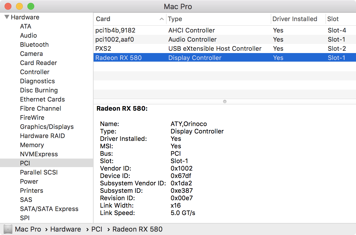

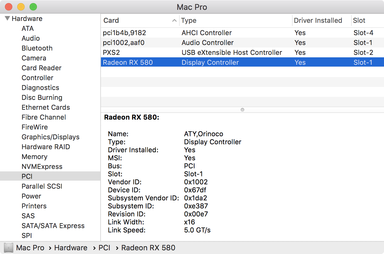

Doesn't matter how good or bad it is (as long as it can still display, and it's possible to read the text on the screen).
The idea of co-installing both GPU is to confirm if the RX580 is really recognised by the OS like this

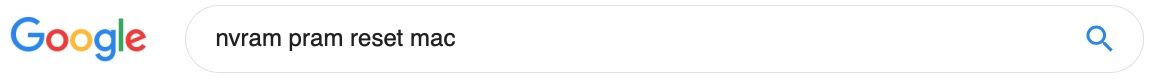

PRAM (now known as NVRAM reset) is done by holding down Cmd+Opt+P+R immediately at startup, and keep holding those keys down continually until you've heard your Mac restart for the third time - might take a couple of minutes all up. Make sure you don't overly push down on the keys - we're not trying to push them thru to the back of the keyboard :)
More info here from apple.
Or
scottr02
macrumors newbie
Jul 10, 2019
21
5
Or
Thanks. I tried that but it sounds like the Mac is rebooting itself every minute or so. I get the boot up sound but still no signal to the display. Wondering if I'm supposed to be using a specific apple adapter to connect the monitors? This new card uses a hdmi and display ports, so I've been plugging directly into those.
