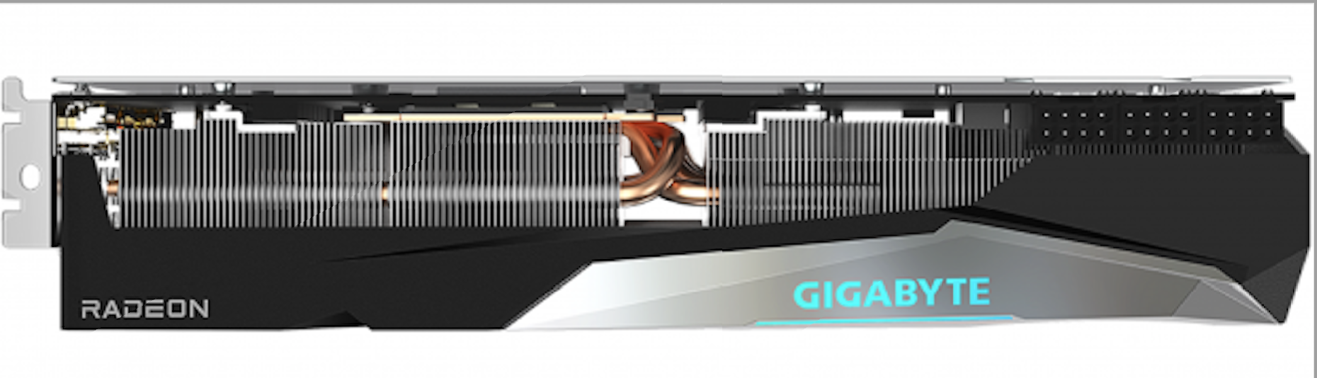

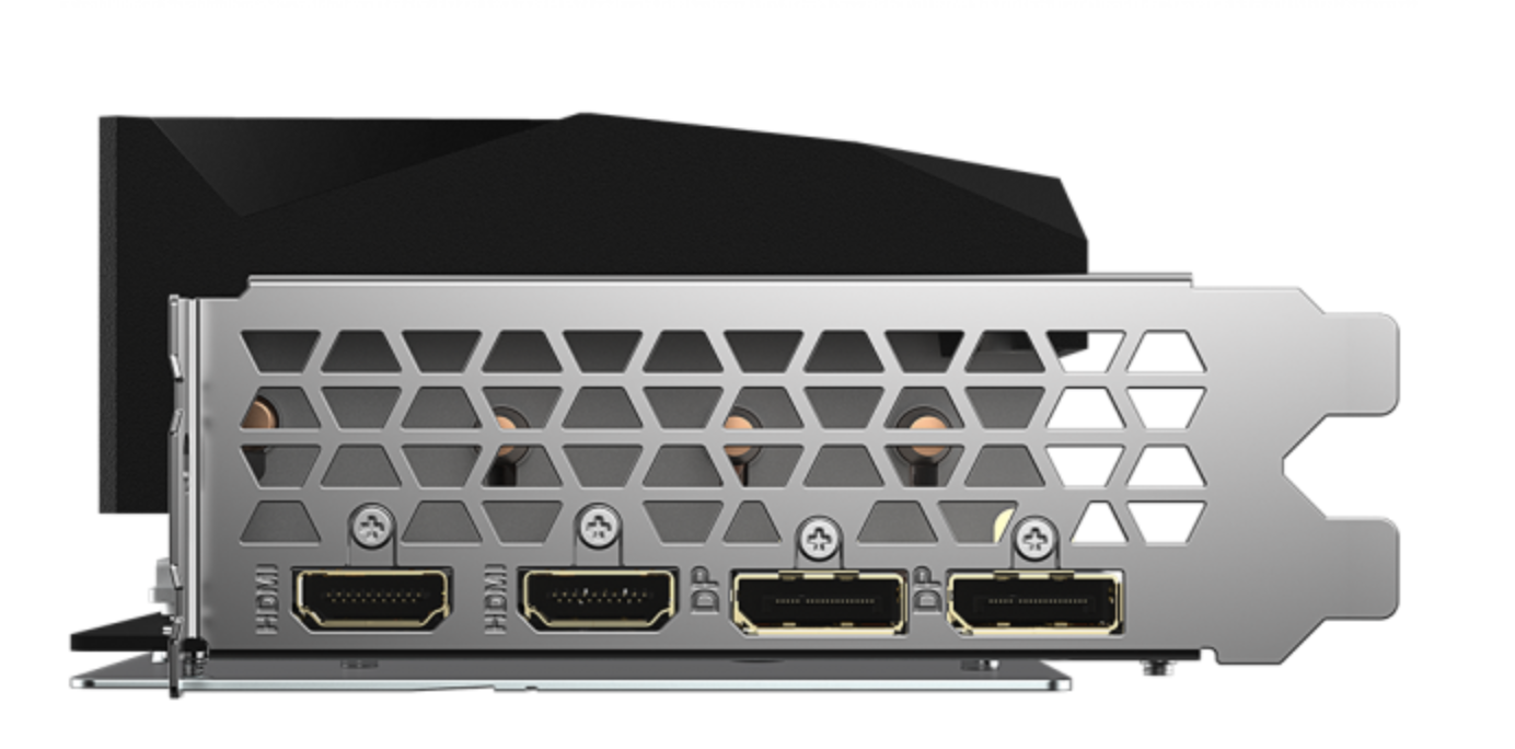

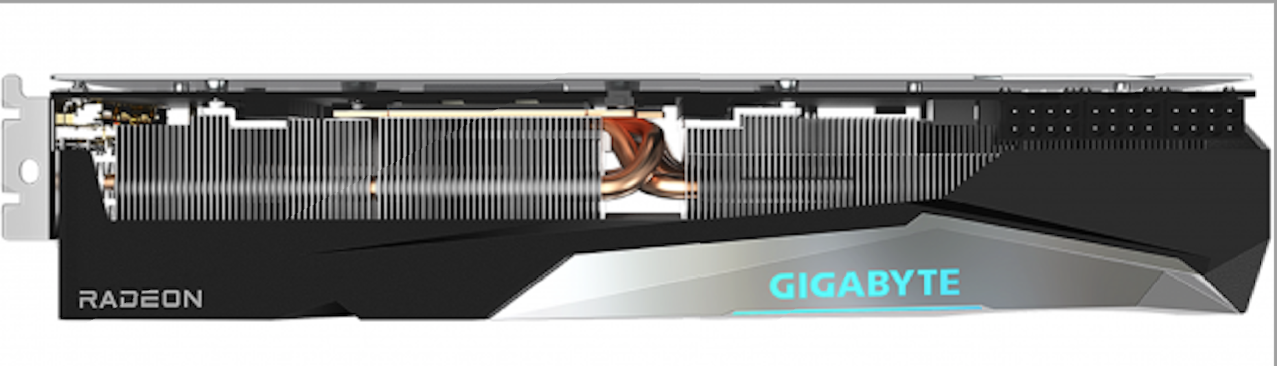

Gigabyte's card announced. It's huge. Three 8 pin connectors. 850 watt PS requirement. 16GB of GDDR6. $1200 price tag. An Aorus version coming later.

So this definitely won't work in a Razor Core X eGPU with stock PSU? What about a reference model?

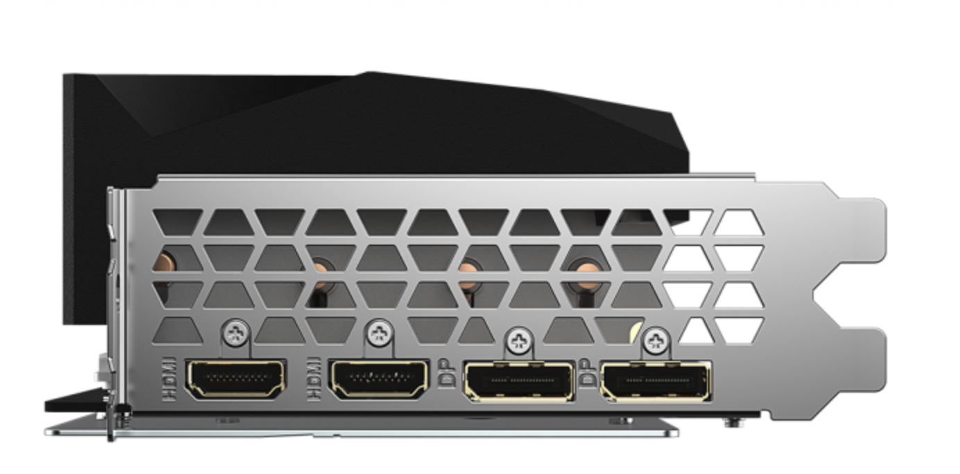

Lou
The reference card looks so much better than that.
Side note, it’s a shame the reference card doesn’t let you flip the logo up the other way for systems with cards mounted the opposite way to normal (like Mac Pro).

^^^^The Gigabyte logo would be upside down too?
I have an Aorus RX5700XT in my NcMP, and the lighted logo is upside down in that. I never gave it much attention?

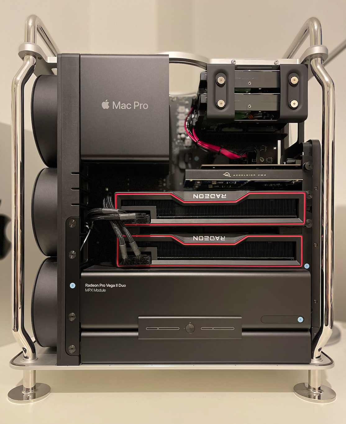

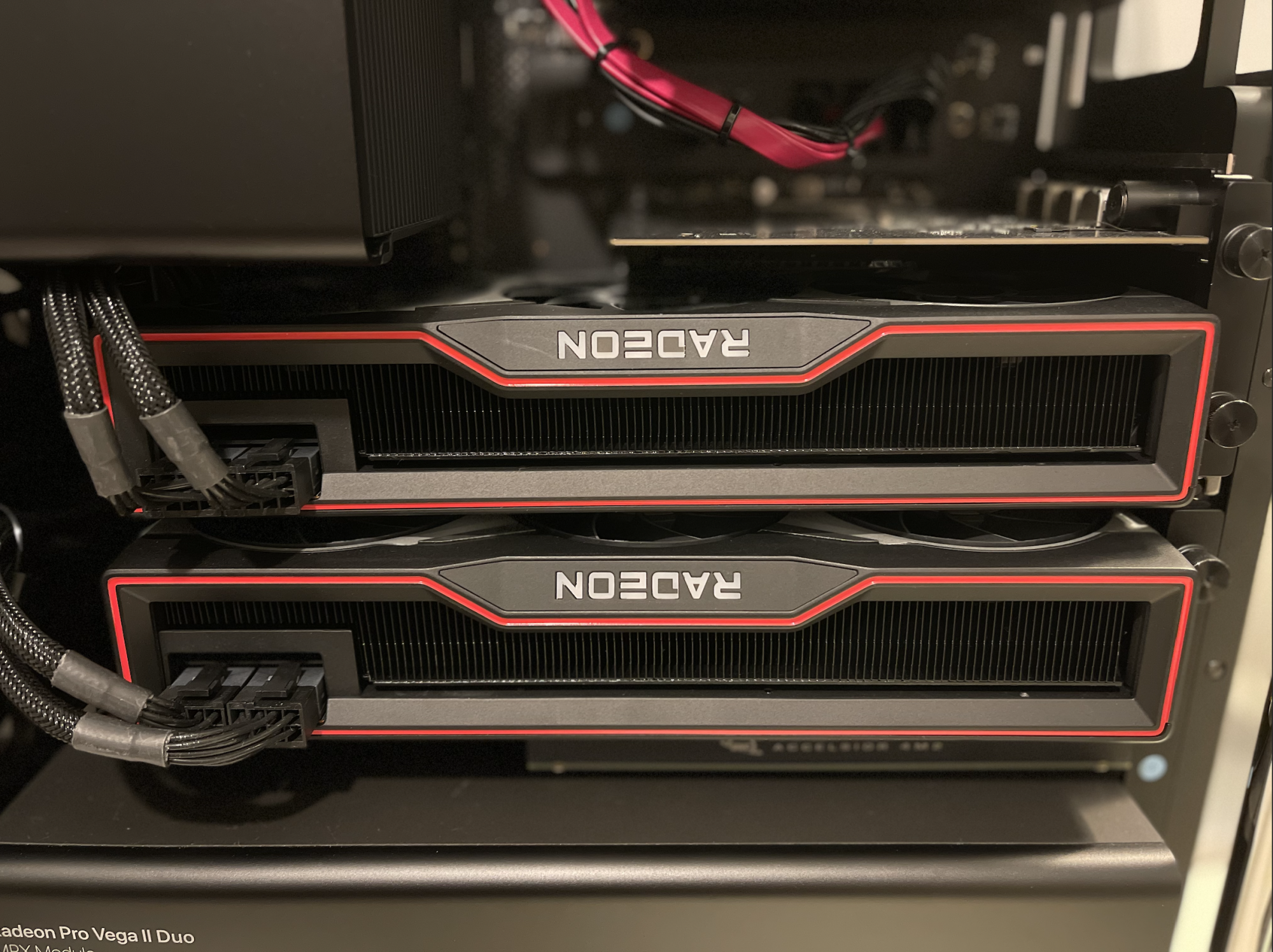

s4ru i have the same mac pro setup. are those 2 6800xt or 2 6900xt. looking to add that same setup when I can find them in stock. I only thought I could fit one.​

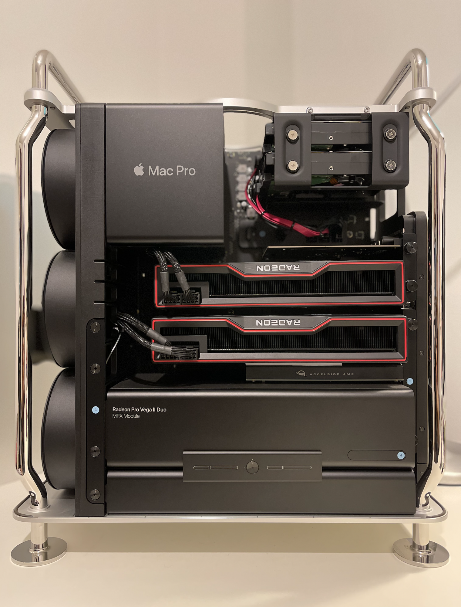

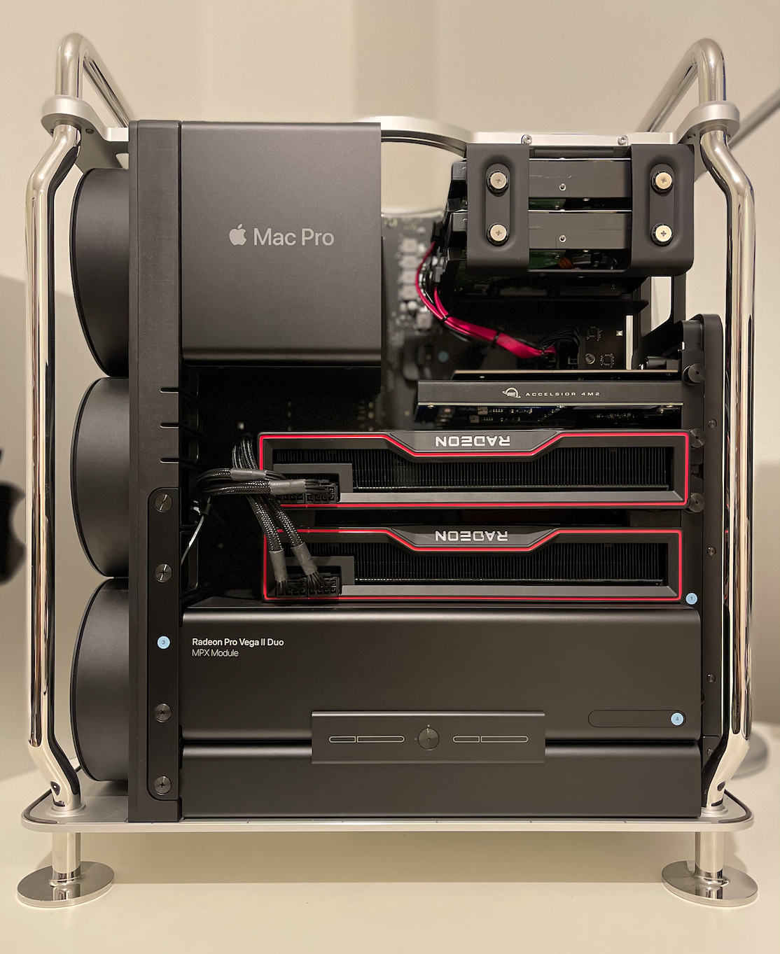

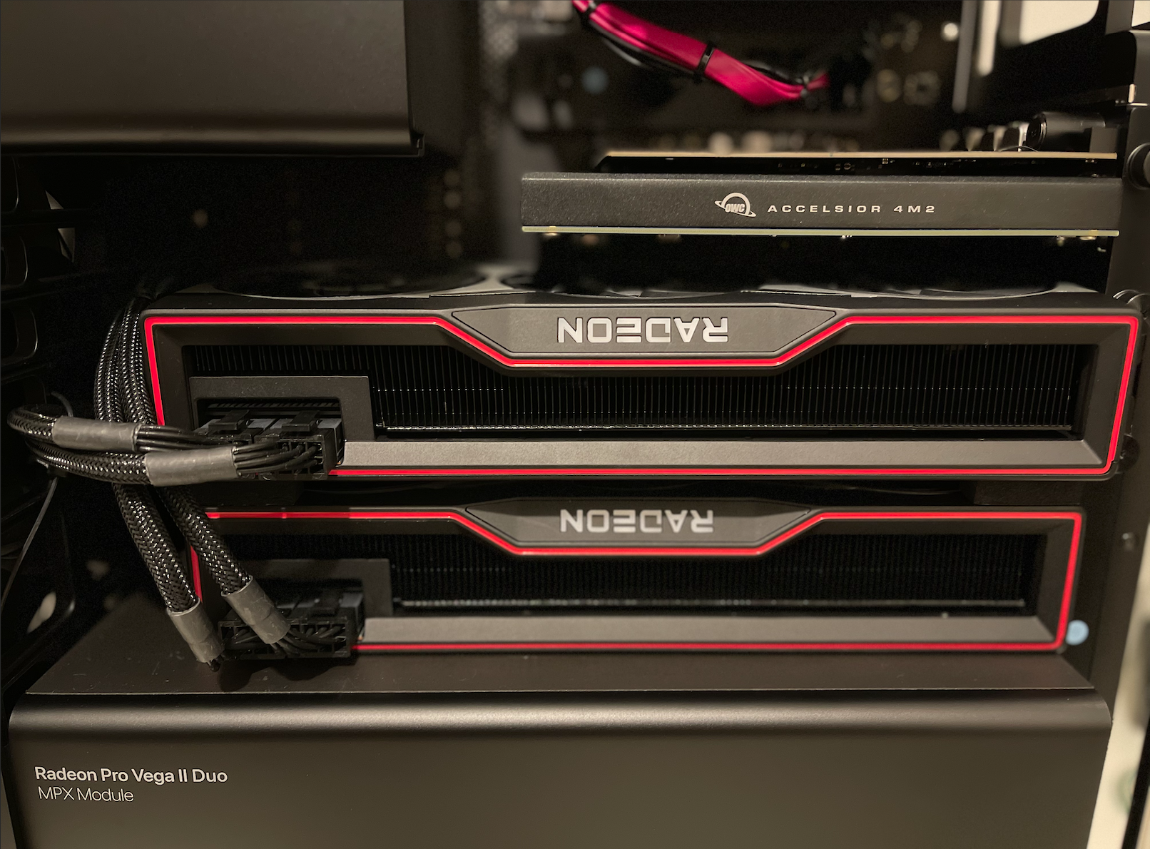

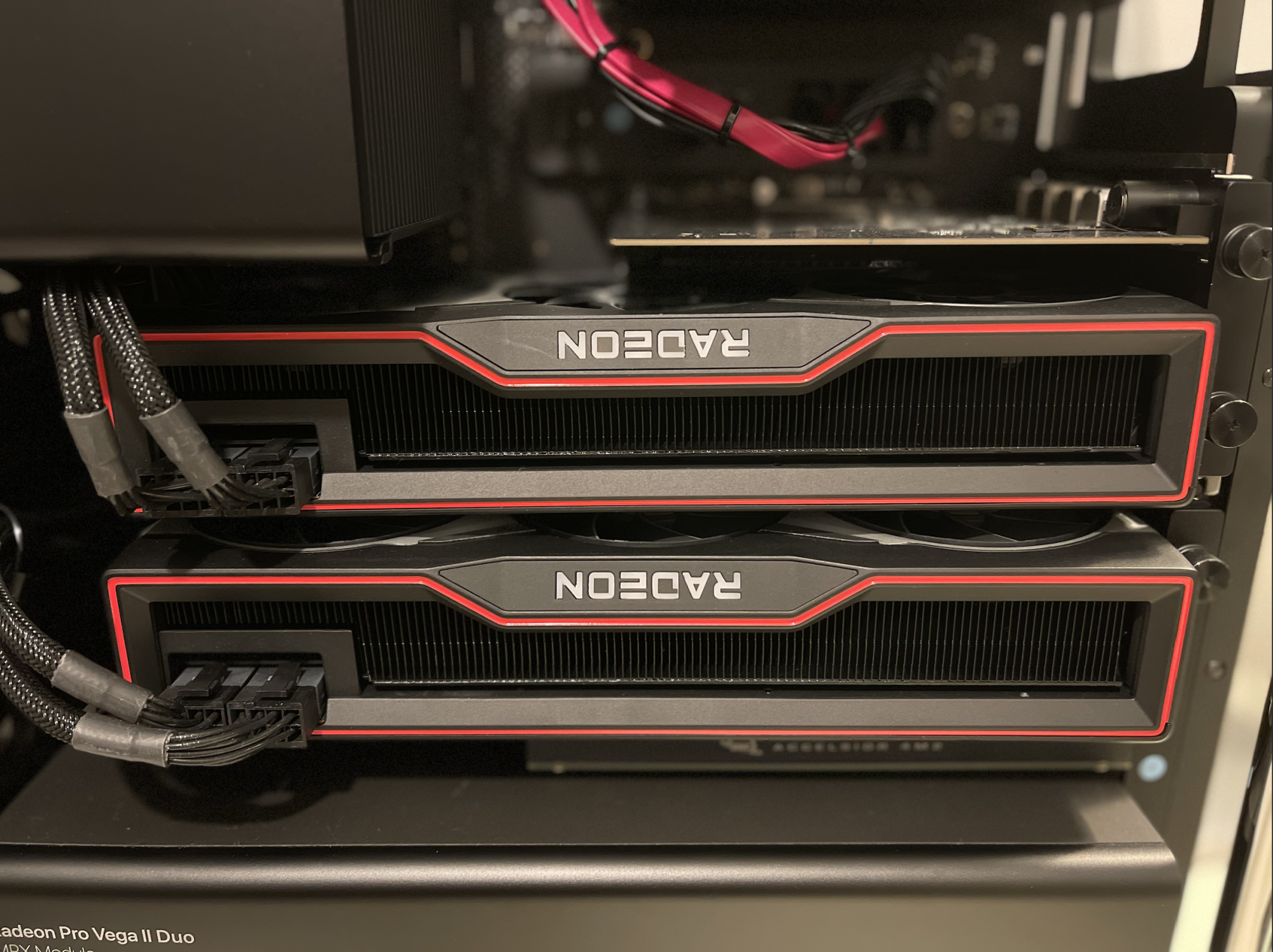

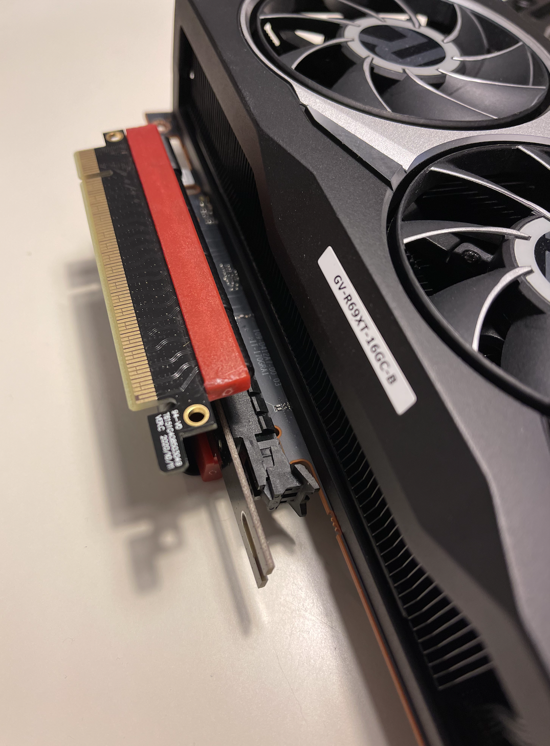

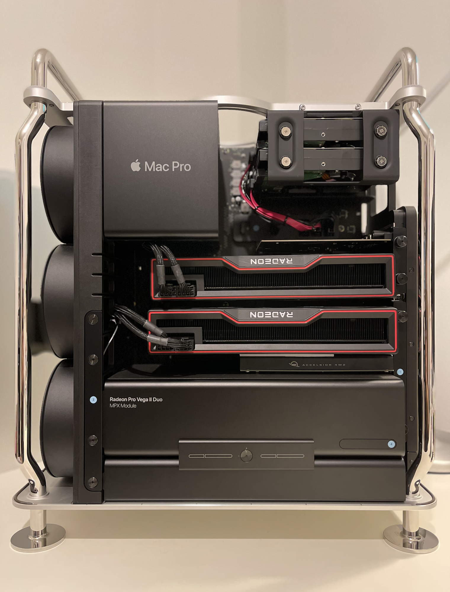

Yes. They are two 6900 XTs. I used a short PCI riser cable for one of the card to manage the installation of the dual 6900 XT.

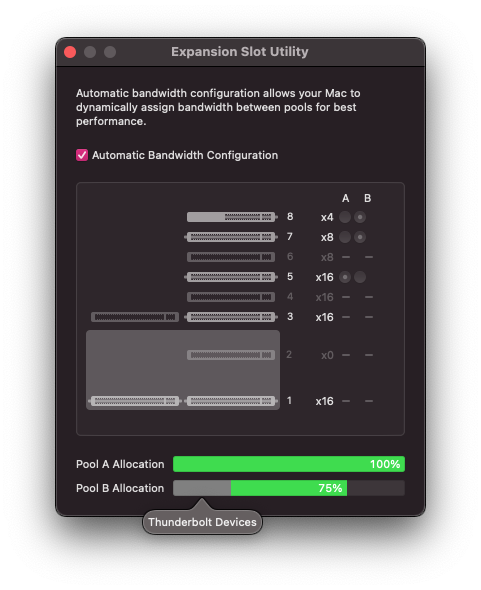

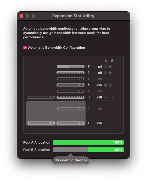

The setup pictured previously had a PCI lane allocation issue though. In the OS’s Expansion Slot Utility, Pool A Allocation was 100%, whereas Pool B had 125%. That is because I had an OWC Accelsior 4M2 (x8 card) in Slot 3, which is x16.
Searching for a web, I found a very useful article about the MacPro’s PCI lane allocation.
After reading it, I re-did the cards installation.
Here’s the config;
Slot 3 (x16) is populated with the first 6900XT.
Slot 4 (x16) is obscured by the card so it is not accessible.
Slot 5 (x16) is filled with a riser cable so that the second 6900 XT can be used in offset way, in between Slot 4 and 5, making some head room.
Slot 6 (x8) is obscured by the card.
Slot 7 (x8) is populated with OWC Accelsior 4M2.
Slot 8 (x4) is populated with Mac Pro I/O card.
The PCI bracket of the second 6900 XT is removed because the card is slightly protruded due to riser cable. The card is not secured in anyway. It just sits on the first card with sponge spacer in between. This is the reason I chose the first setup attempt, in which a 6900 XT sat more firmly and somehow was sticked to the Accelsior with a thermal silicone pad in between them.
Anyway, the PCI lane allocation seems better now.
Pool A Allocation is 100% and Pool B is 75%, reserving some spare resources for Thunderbolt devices. Actually, with eGPU attached, Pool B goes to 100%.
Hope Big Sur will natively support the card soon.

s4ru thank you for sharing a breakdown of the build. Really helps me moving forward in purchasing 2 6900xts soon. For the cables. Did you just use the ones on the apple website that they sell for mac pro? If not can you provide a link? Can you share a link on where to purchase the GPU Riser? In order to fit the same configuration as shown.
s4ru
macrumors newbie
Feb 10, 2020
17
27
The power cables are from Belkin that Apple sells.
The GPU riser cable I used is this. 5cm 90 Degree angled one.
https://www.amazon.com/LINKUP-Shielded-High-Speed-2020┃Universal-Compatible/dp/B08P3S8TPT/ref=sr_1_3?crid=23BXC80LLUWS9&dchild=1&keywords=linkup%2Bpcie%2B4.0&qid=1609723868&sprefix=LINKUP%2B%2Caps%2C327&sr=8-3&th=1
I also ordered ADT-LINK riser cable too but haven’t received yet.
I guess this one fits better because it’s got smaller print board than LINKUP.
Both brand has left-angled riser which seems better fit but a ribbon cable might be too long for this purpose.
I think 6900 XT reference model has got perfect size for dual installation in Mac Pro. Other OC models might have thicker and longer size so it could be more difficult to fit in.
*Edited. Seems Amazon URL does not work properly so I quoted the links.
