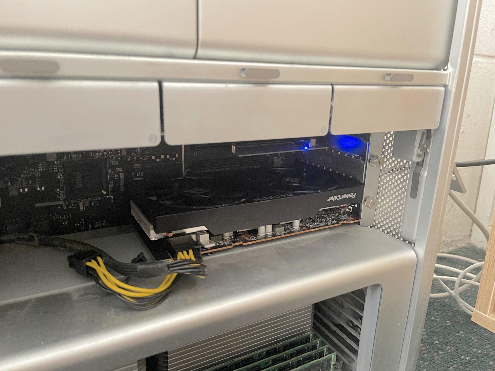

What is the TDP of this card? I am leaning towards buying a RX6x00 (granted, mostly for Windows use in games), but what I have available is an EVGA Powerlink.
160 W for the mentioned PowerColor Radeon RX 6600 XT Fighter.
As it has only one single 8-pin PCIe connector, it can‘t draw more than 150 W from the Mac Pros motherboard Dual-6 pin power connectors. So a Pixlas mod shouldn‘t be necessary.
Yeah can confirm. This card was originally in my PC, it used next to nothing when gaming. Would always be less than 160W. I think for my use case it hovered around 140W if not less.

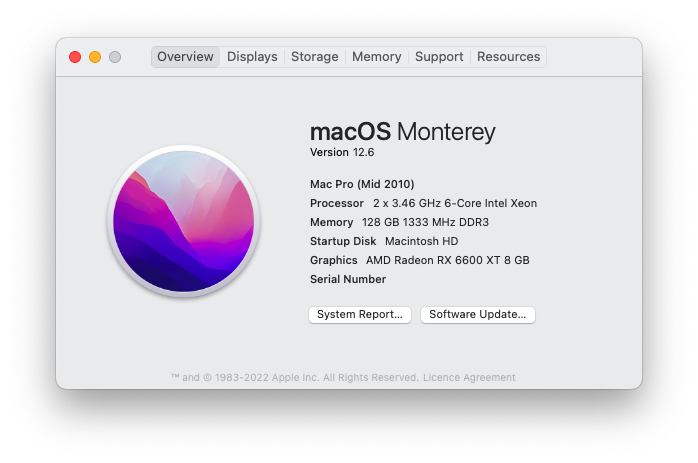

Thanks for this great tool Syncretic. Decided to Install a 6600XT (Power Color Fighter to be exact) into my Mac Pro 5,1 and it is working great, so much better than the old 7950 it replaces. Compressor seems much more happy compressing files into newer codecs.
Note: The Pixla Mod was done ages ago when this Mac Pro was rocking a Vega64 and isn't needed for this particular setup.

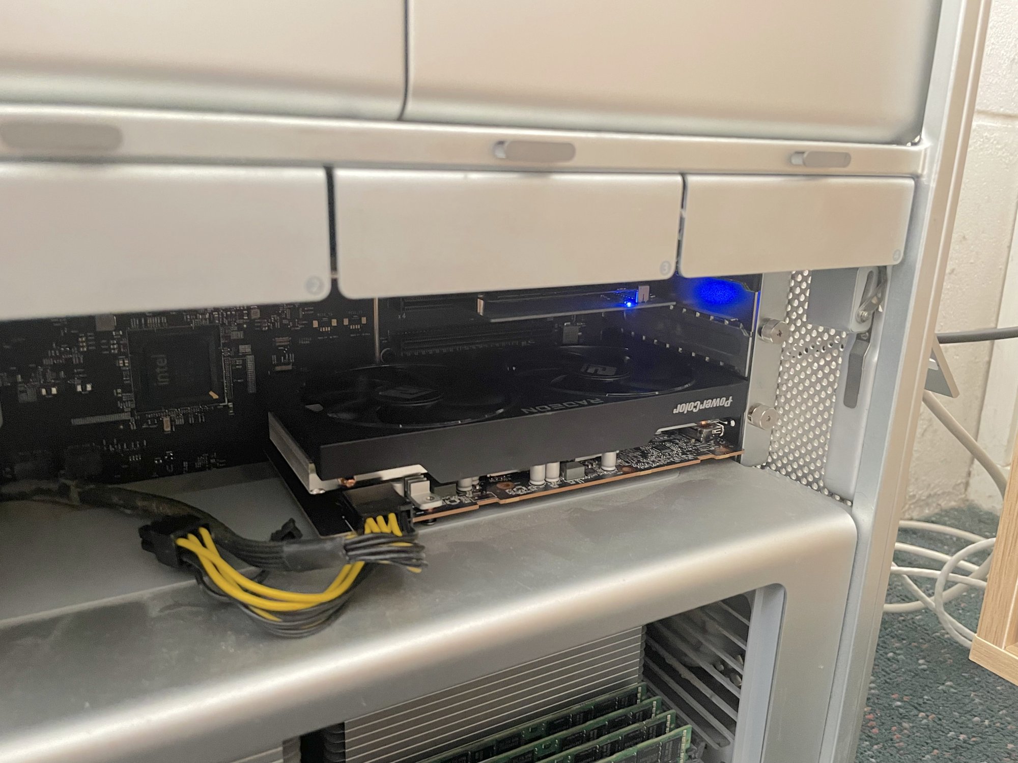

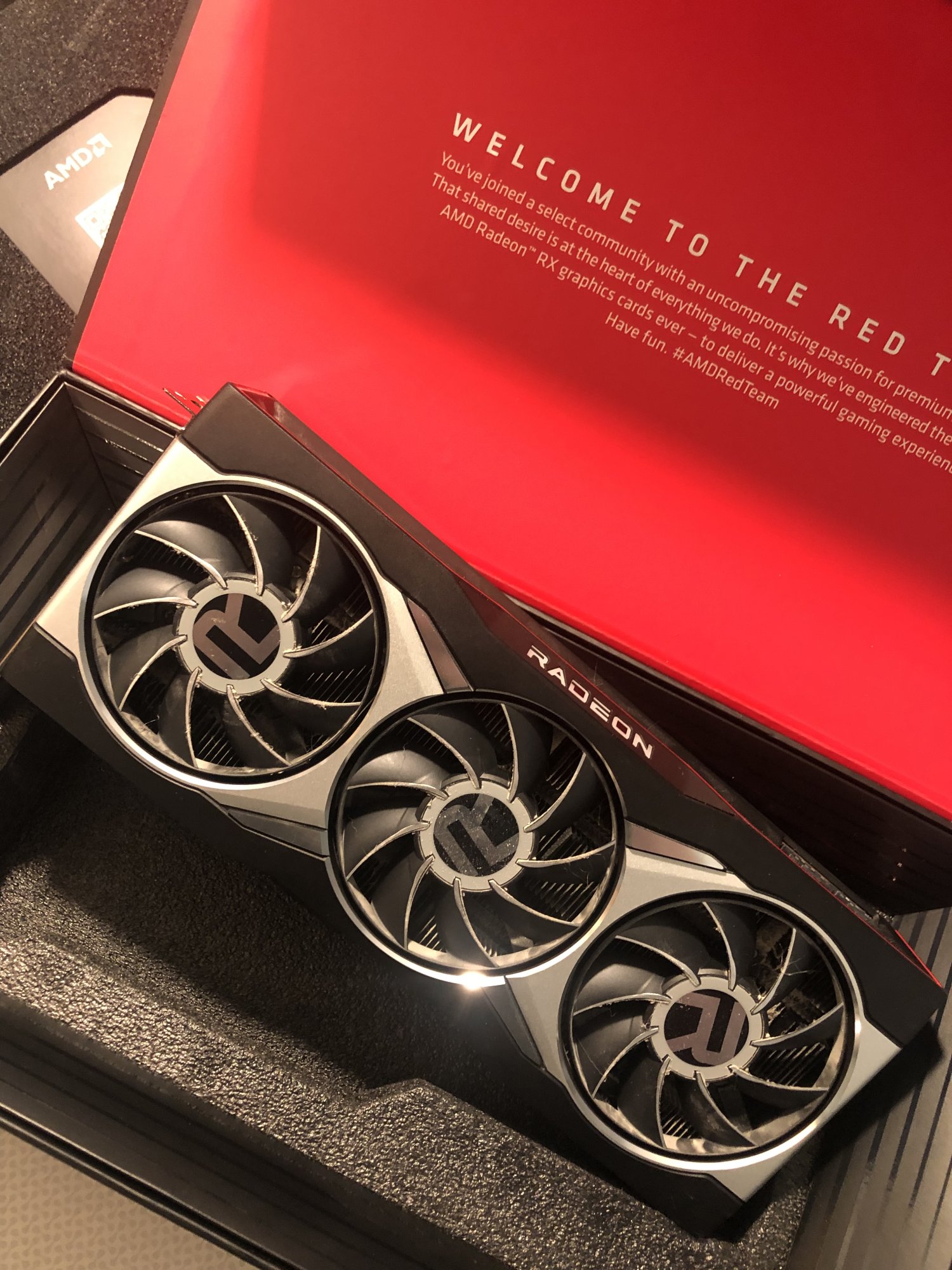

It's HAPPENING!!
Thanks to @Syncretic and the whole opencore team. And also thanks to Donald at Canada Computers for flashing this for me. Gonna make a whole video on the pixlas mod and installation of this beast in the next few days. Will include some benchmarks and jokes on my new channel - https://www.youtube.com/channel/UCUcNGyY2FDA-sA4e24V9aSw
And boom! If there anyone out there living in Toronto that wants this done for them, let me know!

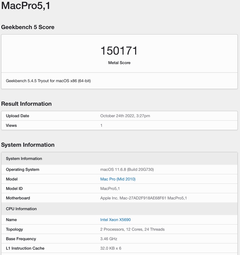

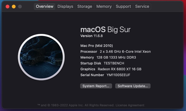

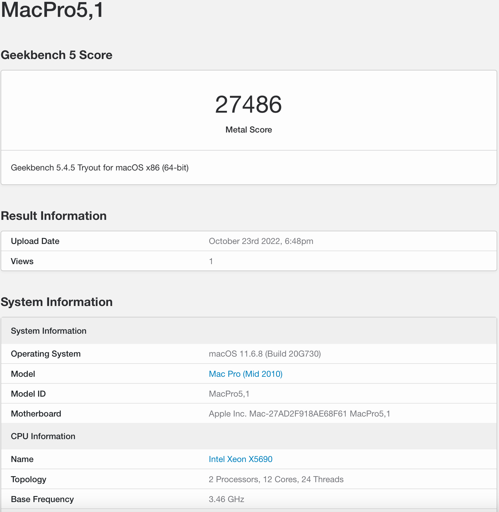

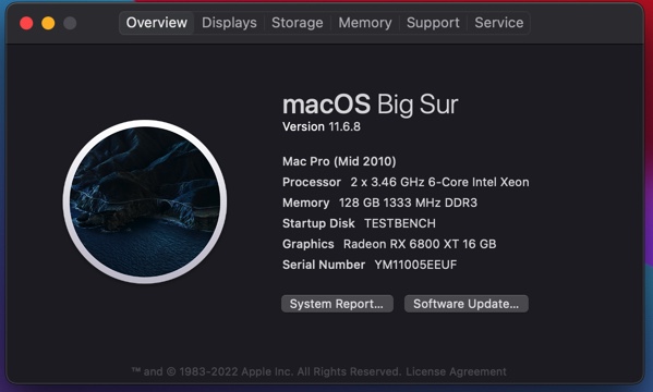

What was the 27486 metal score for....?
That's what I was getting with hardware encoding on a test SSD Sata 2.0 drive. Wanted to make sure TitanRidge was working with UAD before I upgraded a friends NVME to BigSur.
I found that with hardware encoding turned off (selecting no SYMBIOS spoof in OCLP) I got 47000'ish with his overclocked RX480 8gb, but wanted to be a little more dramatic....:)
With that said, if anyone knows why I was getting a lower score on GB5 with the new SYMBIOS, I'd love to know. Maybe there's another setting I'm missing?
Being that I intend to do a lot of video editing when I can afford the card myself, I want to make sure I have the best settings for OCLP for my rig and intended use.
Just tested my RX 580 8gb and got 28048 - Same SYMBIOS Spoof ID as the machine I upgraded yesterday - Apple "Inc. Mac-27AD2F918AE68F61 MacPro5,1"

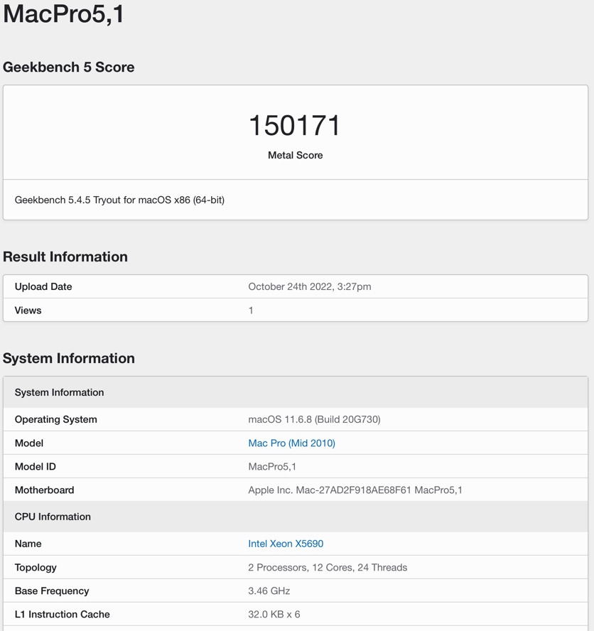

It seems the Ventura RC has increased metal performance with the 6900XT. would be nice if apple supported the up coming 7900xt in the future.

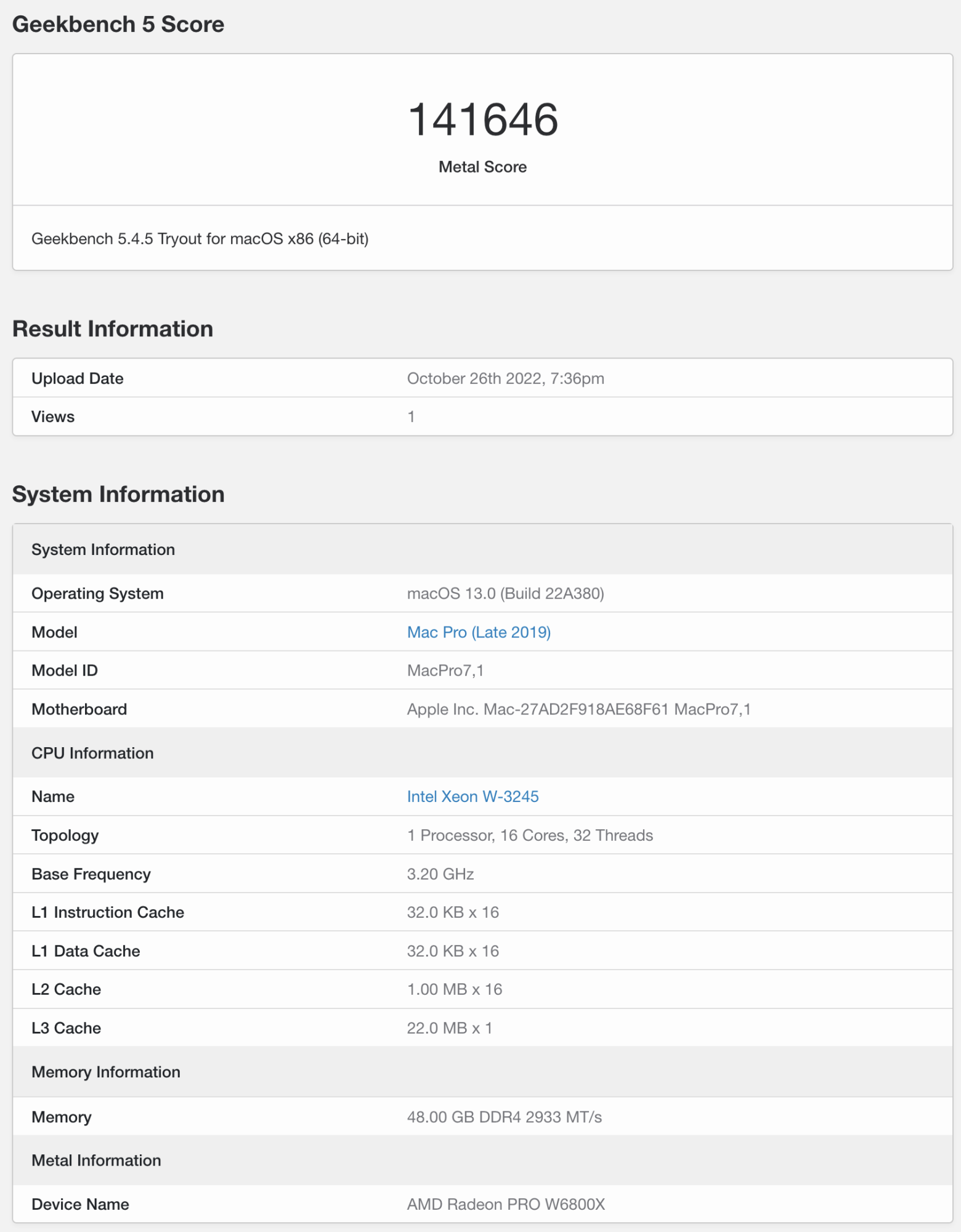

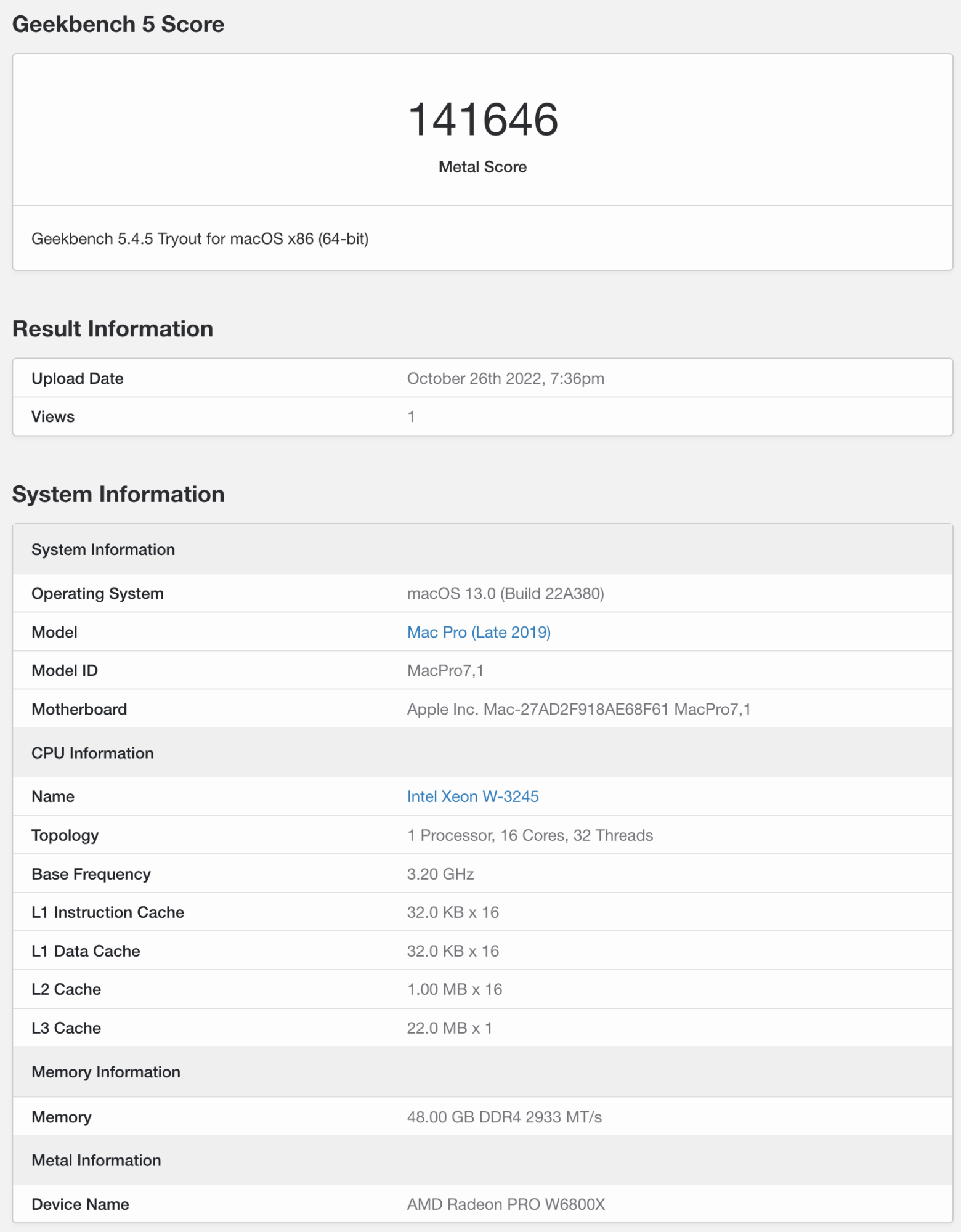

Mine was 141646 with the W6800X MPX module and W3245 (not the M version) and less RAM than yours:

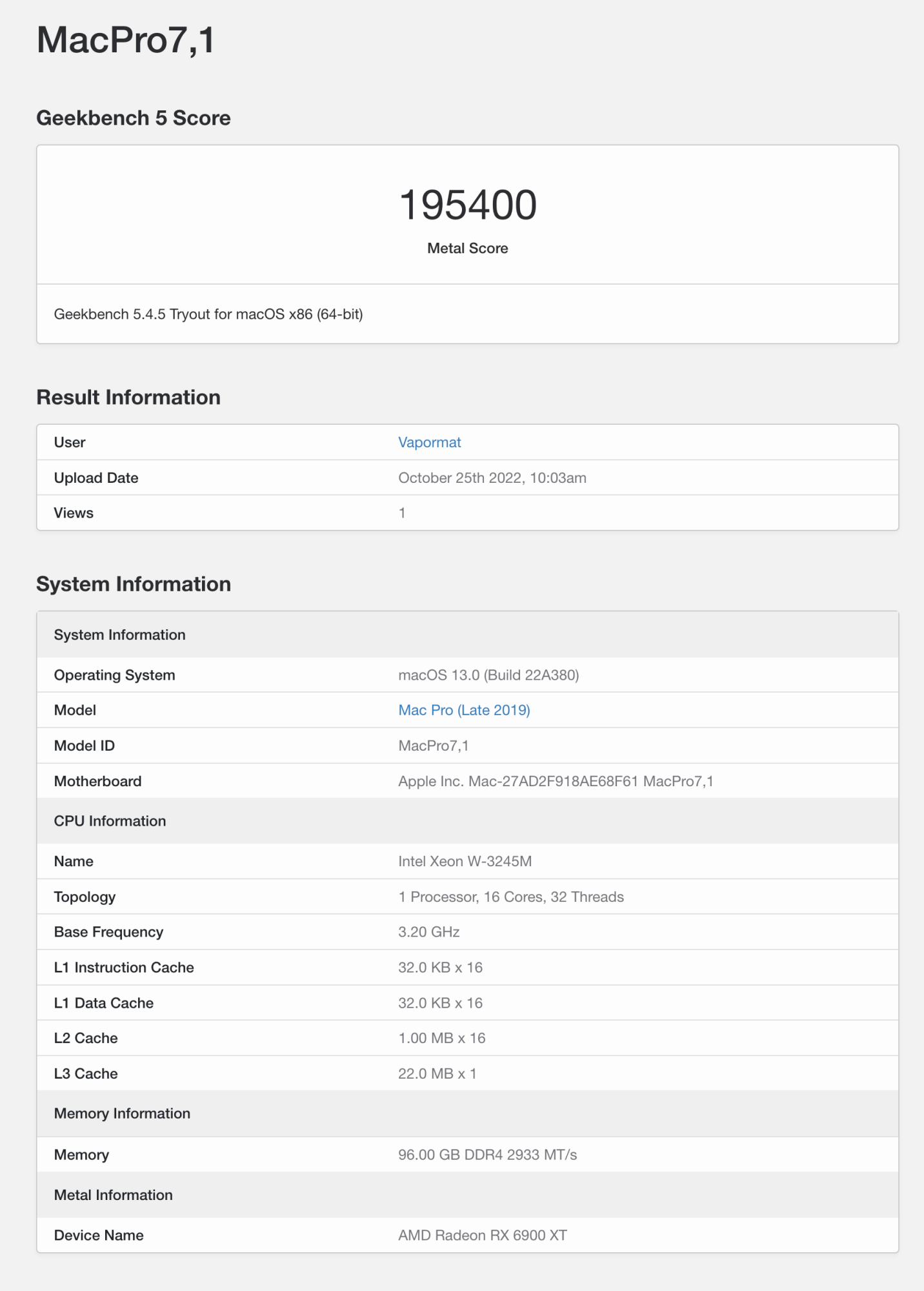

I don't think there is any performance difference between the W3245 and the W3245M apart from the M version supports more ram. 1tb against 2tb for the M version. I will not be buying 2tb of memory for sure.

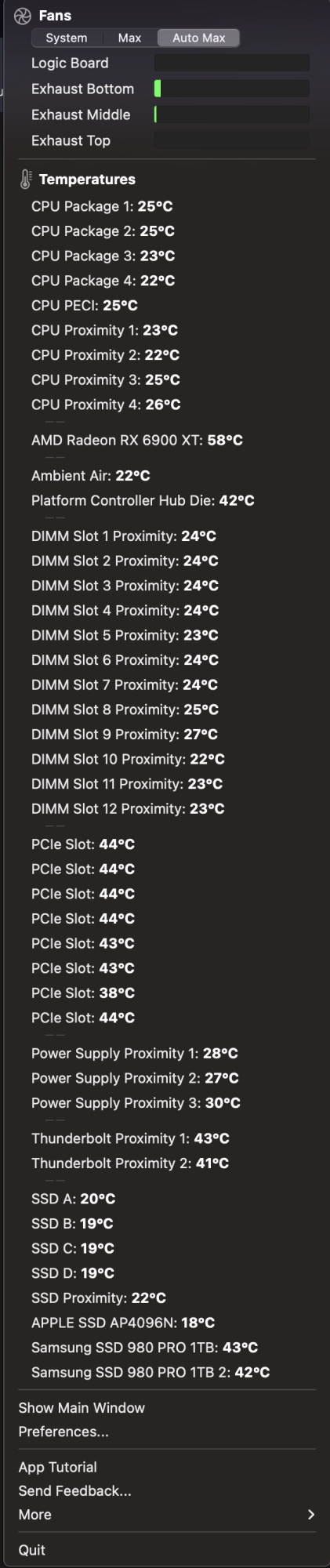

But i think your W6800X has 32gb of memory against my 6900XT 16gb but what i have noticed is that in windows this gigabyte 6900XT boost's on it's own to 2730mhz which is amazing for a 6900XT as i don't overclock the GPU at all, all settings are default. I have no idea if in Ventura the AMD drivers boost or not as no control panel like in window's.
My other sapphire 6900XT OC version cant reach any where near the Gigabyte in boost, 2300mhz being Max on default settings. So i think i lucked out with the gigabyte version. It's a shame you cant control the 6900XT cooling fans in Mac OSX as that would be useful. sits at 56c idle in windows with 800rpm on fans it sits at 36c and you still cant hear it.
Your machine is certainly fast.
