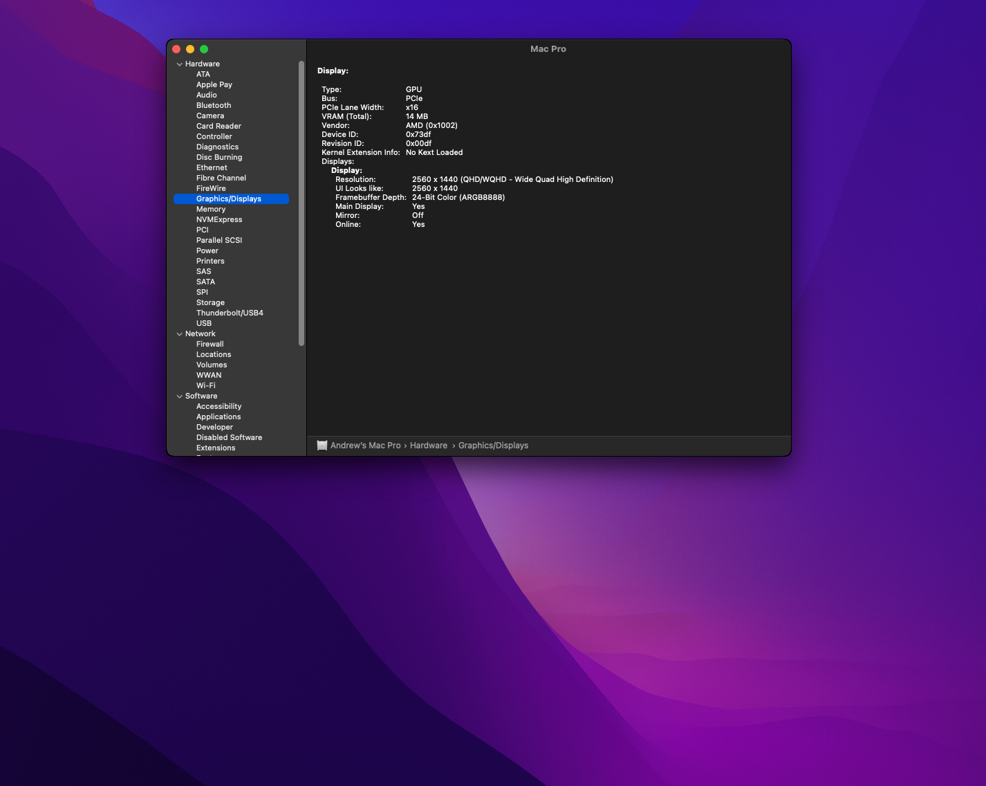

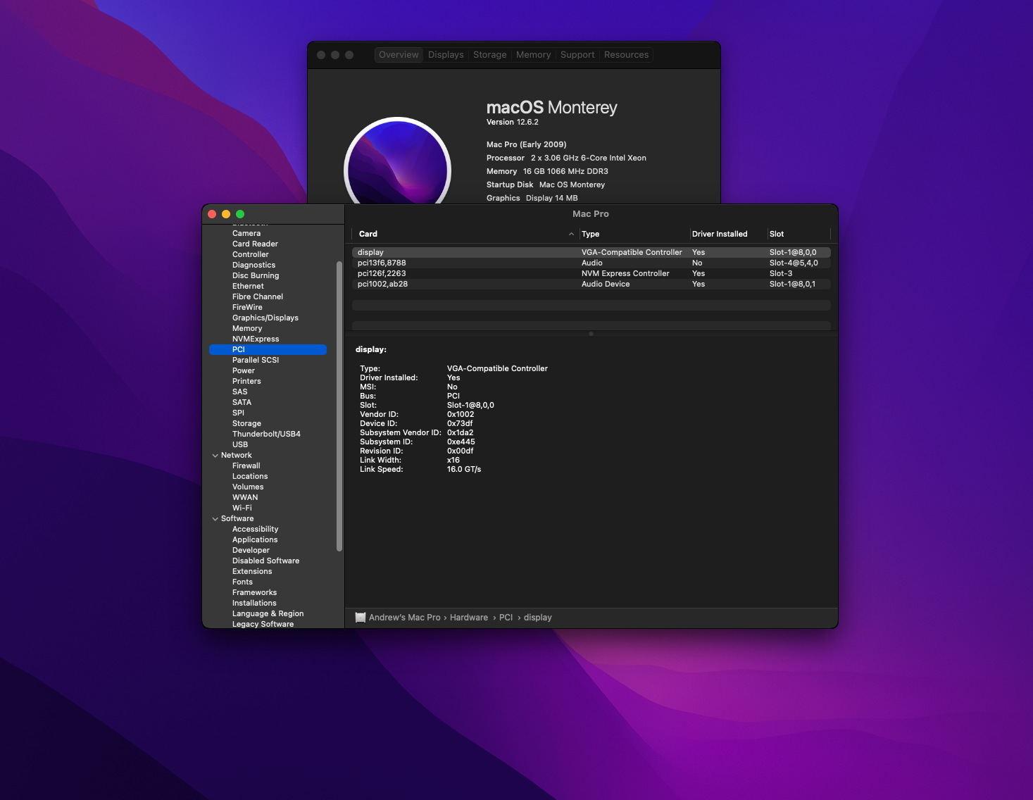

Well i have the Sapphire Pulse RX 6700 (non xt) working on my Mac Pro 5,1 on Windows 11 and Monterey (without acceleration ). I used the patch that Syncretic made for the RX 6x00.
It's far from "working" if not accelerated, though.
Just because it is not working in Mac OS, does not mean it is far from working does it? It works on my 5,1 now with a patch that was uncertain to work on a Navi 22 gpu thanks to Syncretic. I sent my Rom to Syncretic after I ran the patch for him to look at.
