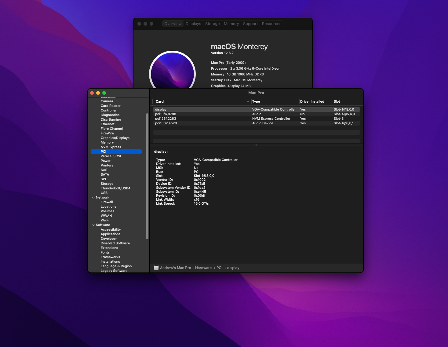

Besides, it is interesting that @BMWDoctor has any output at all. Non-flashed cards without drivers should not produce any video under macOS on a Mac Pro.

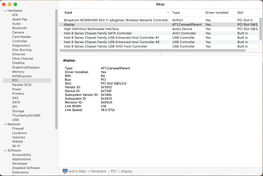

You are forgetting of OpenCore pre-boot configuration support/GOP shim, the RX 6700 in that case is just producing an unaccelerated display via Apple EFI fail safe drivers.
Look About My Mac and SysInfo:
https://forums.macrumors.com/attachments/screen-shot-2022-12-18-at-7-19-07-pm-png.2130168/
Here have the exact same Graphics Display XX MB / VGA Compatible Controller when booted from OC with any other unsupported GPU that have a working GOP driver, like for example a RX 6600 with Big Sur and earlier macOS releases.
The reason may be that AMDRadeonX6000Framebuffer.kext actually includes the RX 6700 (device ID 0x73DF) in its plist.
Almost one year and half later, NAVI 22 GPUs are still not supported.

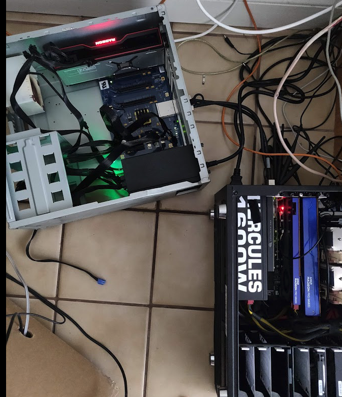

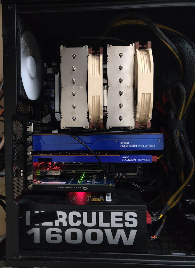

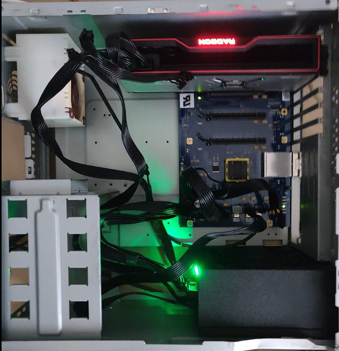

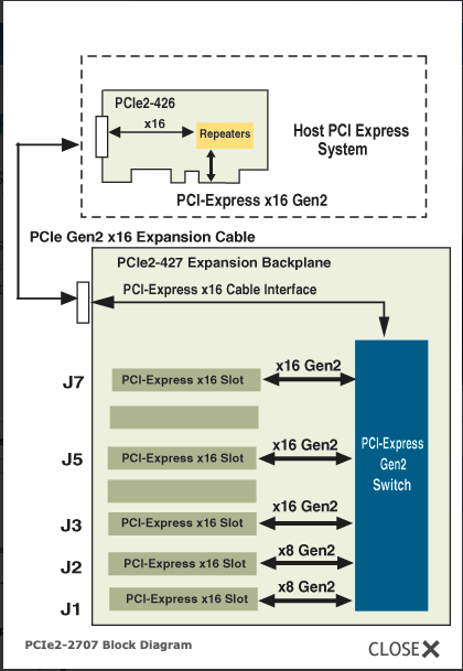

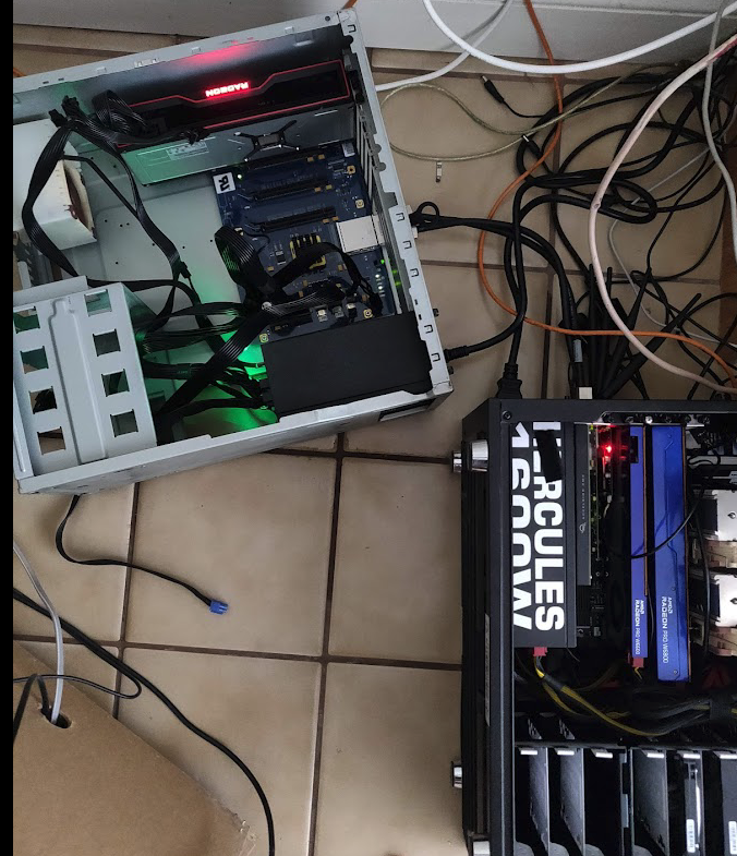

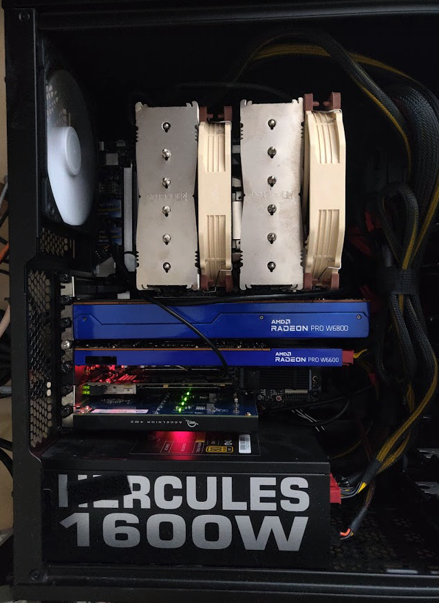

So I removed the 6900XT from the main PC and moved it to a Cyclone PCIE-2 expansion card and installed W6800 inside instead:
Same performance, but much more space. GB5 results are the same.

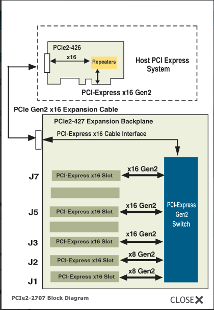

This is a bit off topic but what OS are you running in the MacPro 5.1. I am trying t get a Cyclone 446 /2702 to work using OC 7.9 and Catalina 10.15.7. I was getting kernel panics. Now I cannot see the PCI card in System Report. I have tried a new cable and a new PCI R270-0436 Host Bus to PCIe Expansion Cable Adapter. Still no joy. I believe Apple has released some updates as I was working on getting things running. Thoughts, suggestions
Thanks
Thanks
It worked fine on my cMP5,1. No issues at all. Now is attached to my x299 SAGE mobo and it works fine in HS, Catalina, BS, Monterey, Ventura, Linux and WIndows.
Thanks for the information. So Operating System doesn't seem to be an issue, therefore one problem off the board. I suspect a bad solder joint on the mainboard. I may try taking a long IR wavelength picture and look for hot spots. Or I suppose it could be the 5.1 needs a clean install. It is about time to go to Monterey and skip BS. Thanks again.

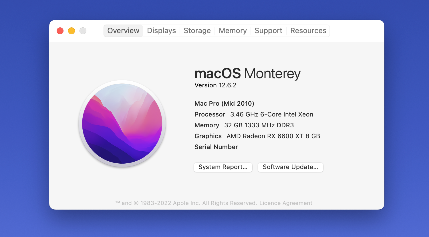

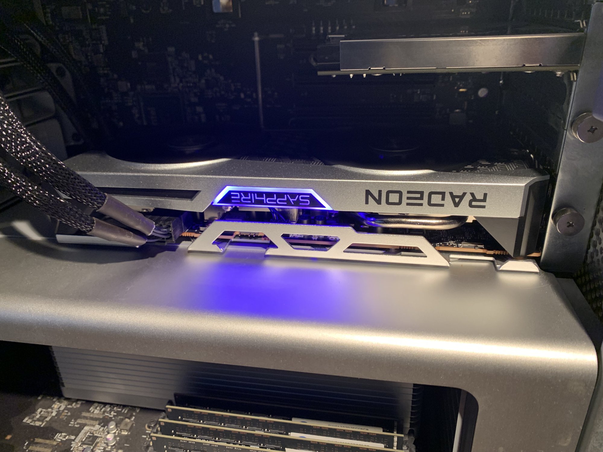

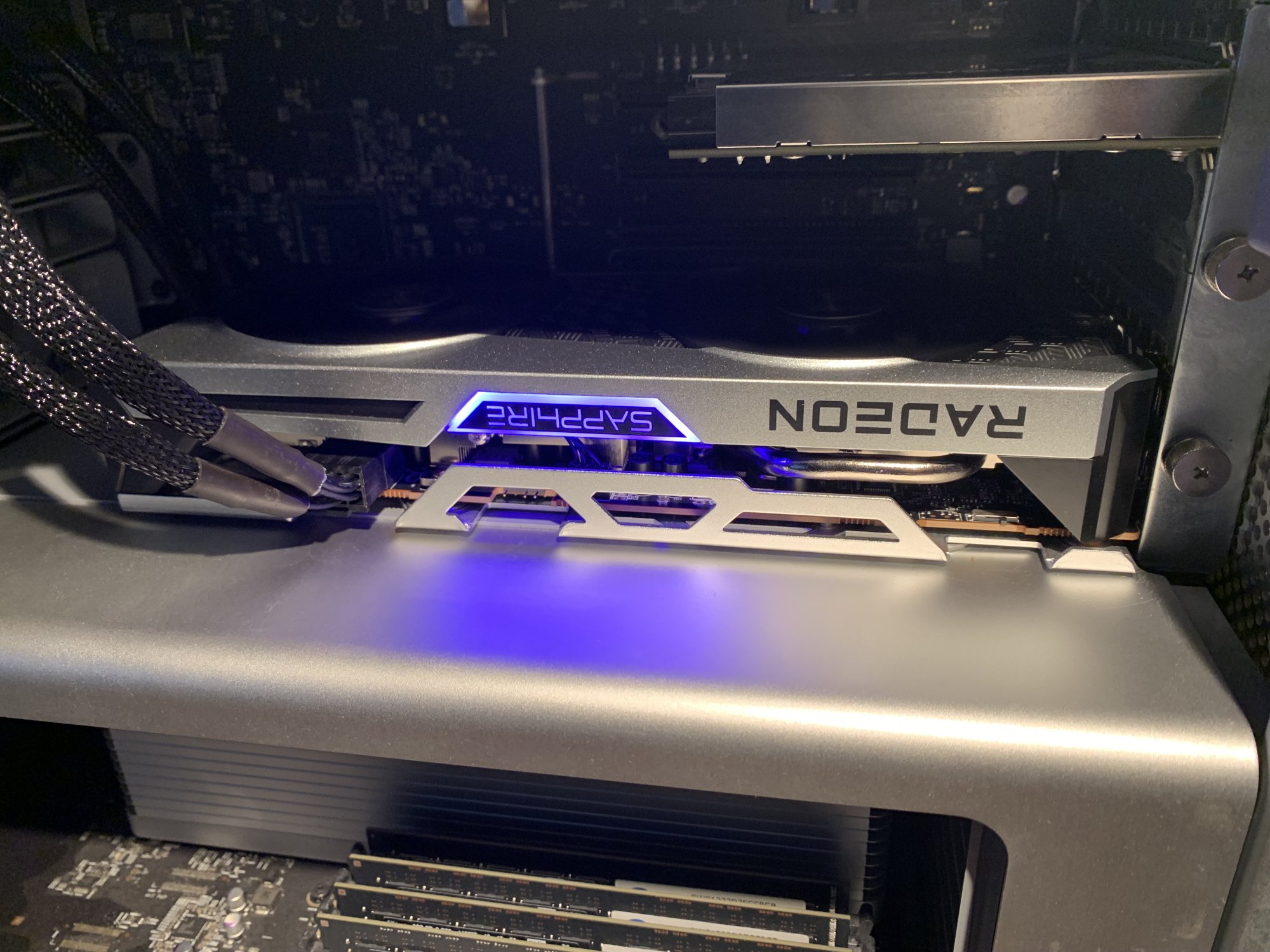

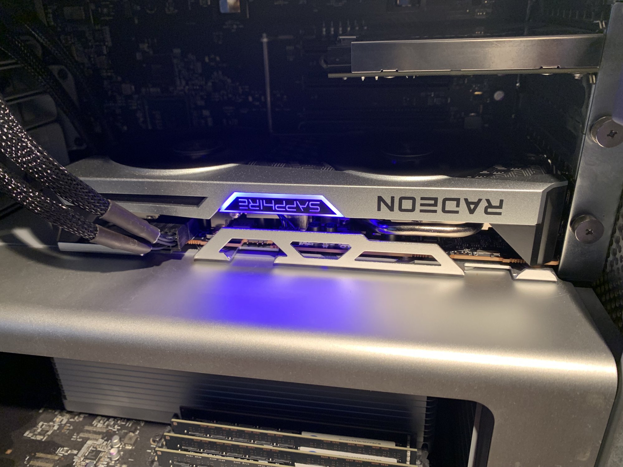

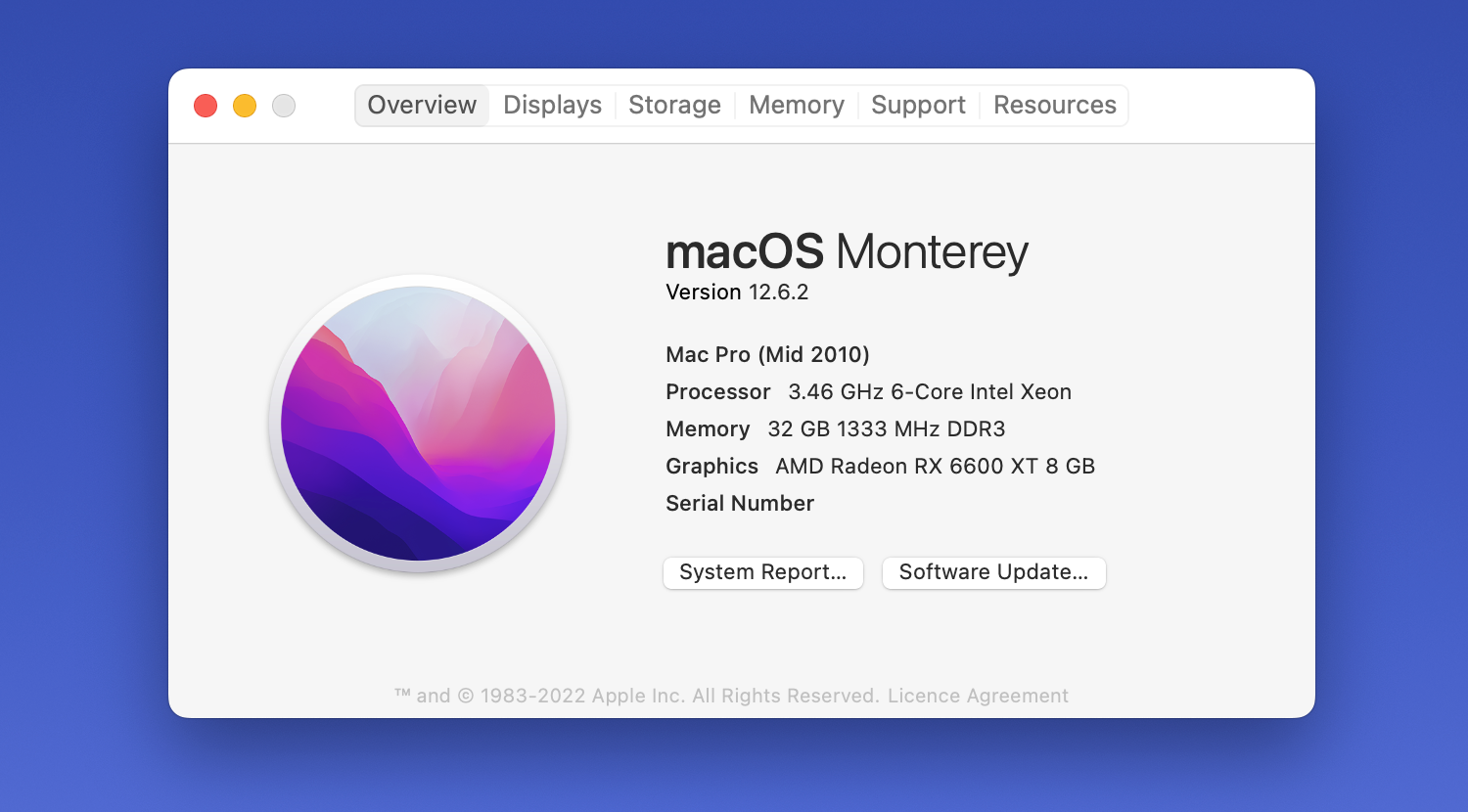

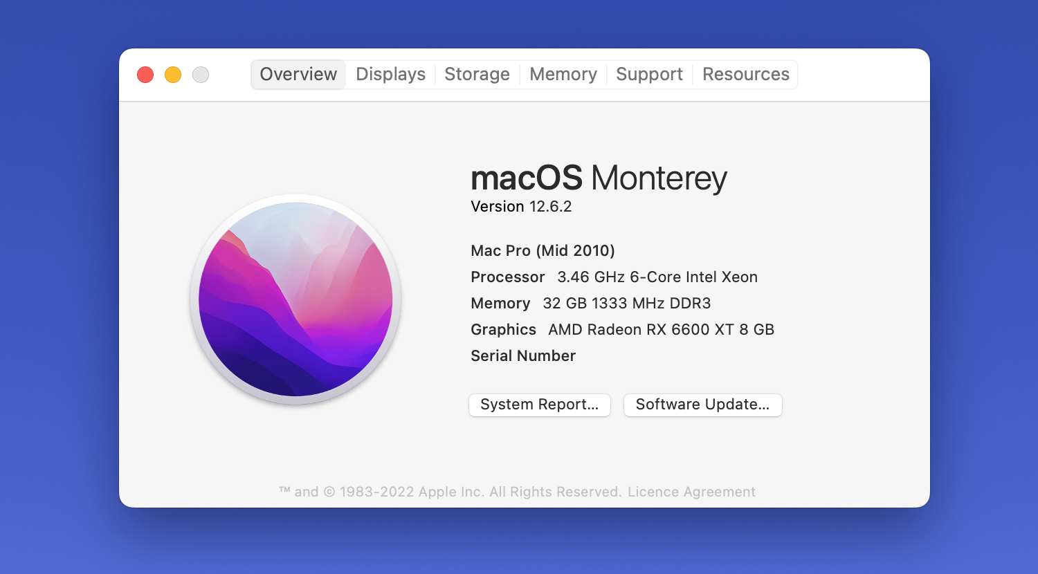

I'm also joining the RX 6600 XT in a vintage Mac Pro crowd:
Sapphire Radeon RX6600 XT Nitro.
I was able to get the ROM out of it, use the tools provided here then re-flash it. It works fine on my 5,1 and it is powered by the same mini 6-pin to 8-pin cable as the RX580. The RX6600XT seems to run a lot quieter and cooler than the RX580. Thanks @Syncretic for your instructions and work.
I used an eGPU enclosure to connect it to the 7,1.
EDIT: I had a problem after doing this and removing the RX 6600 XT from the 7,1 in that Windows would not start properly - I'd hear it boot and the intro sound but black screen on a USB-C connected screen and the LG 5K on Thunderbolt.
This was related to the Bootcamp display drivers somehow getting messed up - the solution was to connect a screen to the W6800X MPX Module with the HDMI cable and then the windows would appear normally. Re-install the Bootcamp display drivers and everything runs normally.

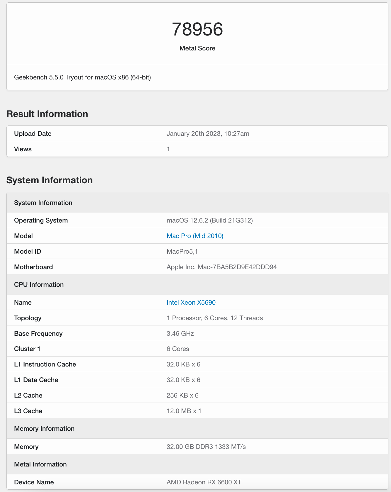

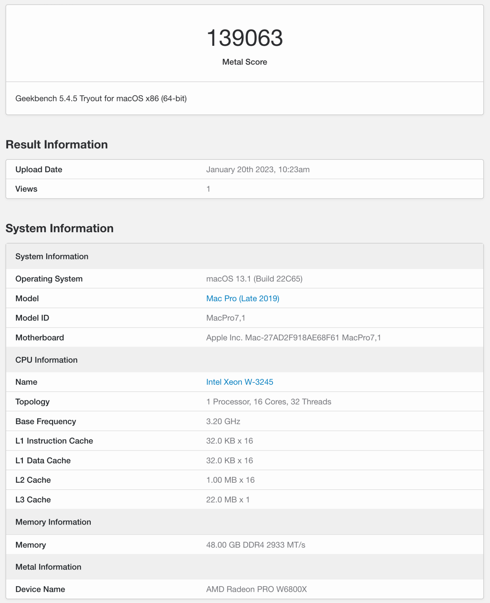

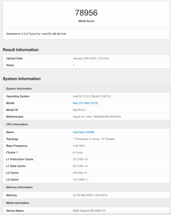

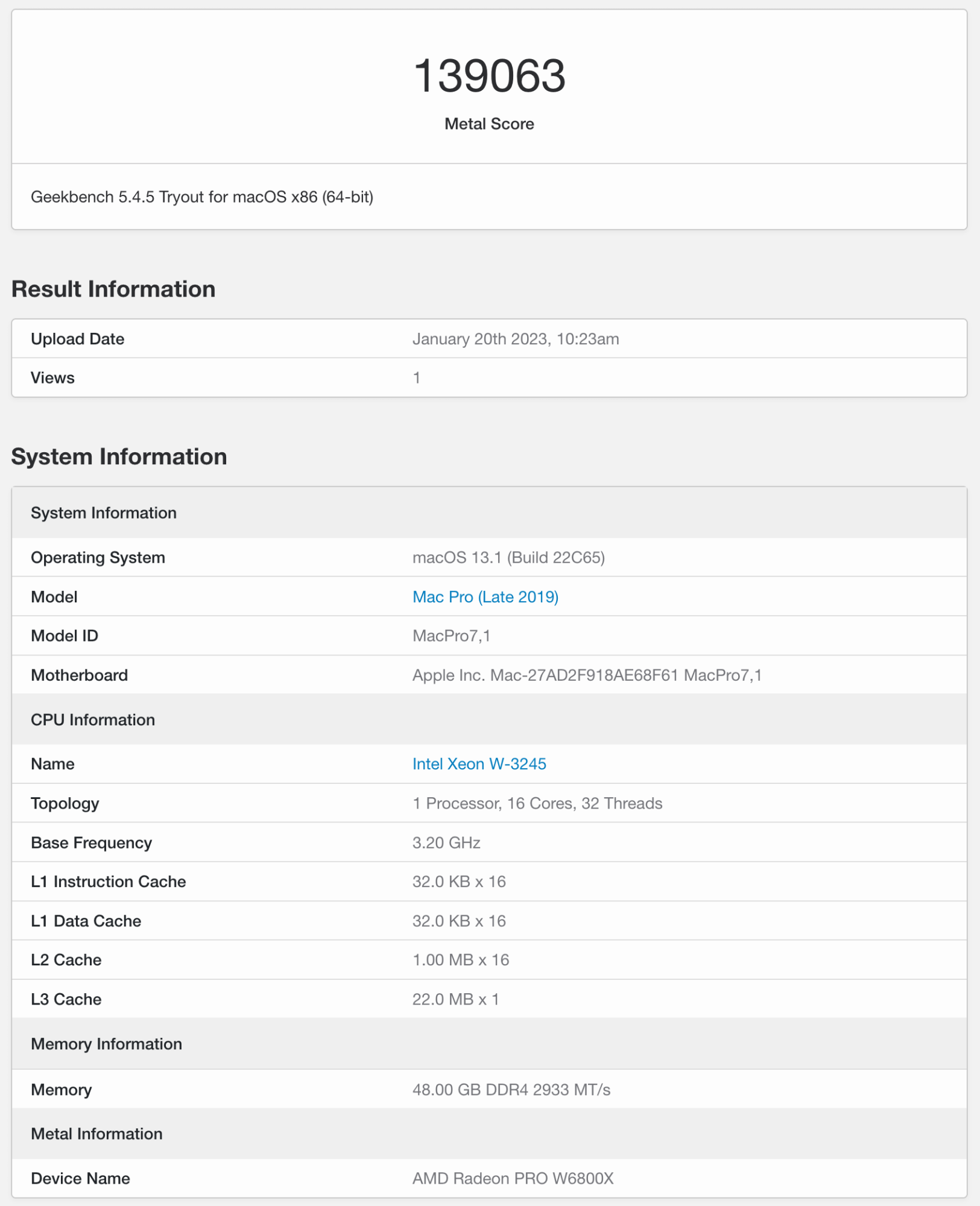

Comparison between old 6 core X5690 5,1 with RX6600XT and my modern 7,1 16 core W3245 with the W6800X MPX module:
Screen Shot 2023-01-20 at 10.31.43 am.png Screenshot 2023-01-20 at 10.35.43 am.png
The old machine isn't too bad. I didn't get any benchmarks of it from RX580 days however.
