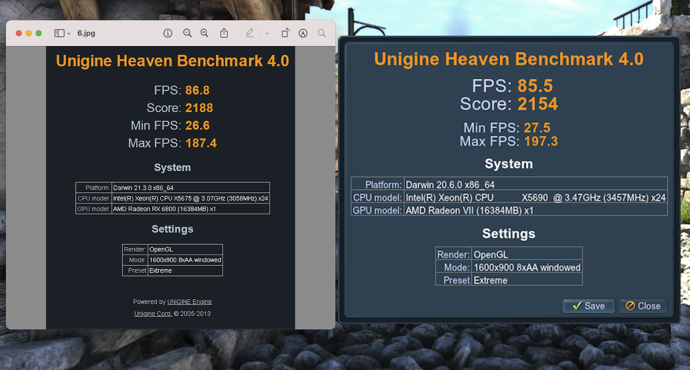

I don't see the reason to update from RVII for now, maybe other detailed benchmark will change my mind.
I think with updating to 12.3.1 the performance of RVII could be a little better maybe.
Of course a Radeon 6800 is much faster on macOS than a 5700 XT or Radeon VII, just check the numbers from barefeats.com. But with CPUs this old you are either CPU bound or the - I don't know - 10 year old Unigine Heaven benchmark is just not a valid tool anymore to measure newer GPUs.

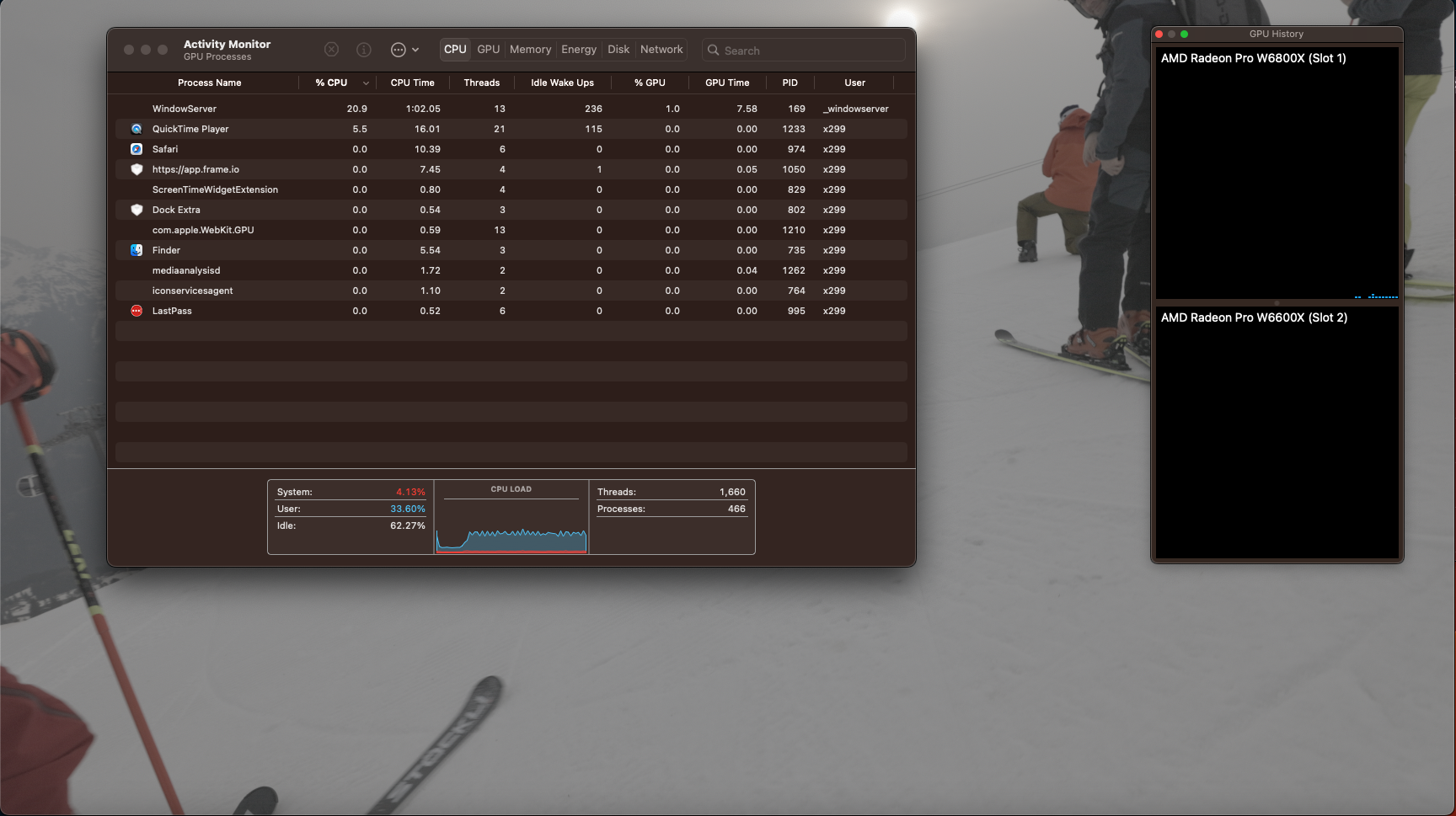

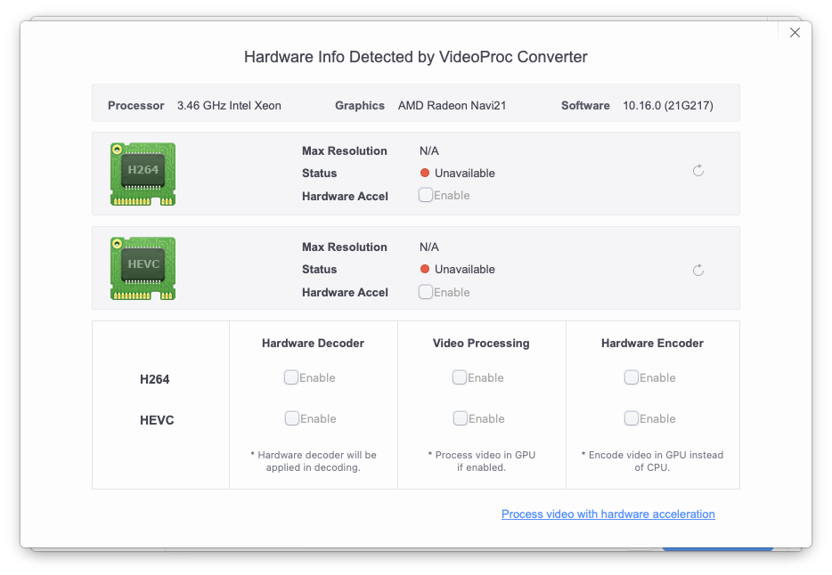

I have retested the 10-bit 4:2:2 footage again in Ventura. No stuttering at all 35-40% CPU usage almost no GPU usage.
Definitely there is an improvement in the software decoder. Previously unplayable in Monterey.
Download the 2.3GB sample and play it in Ventura for testing.

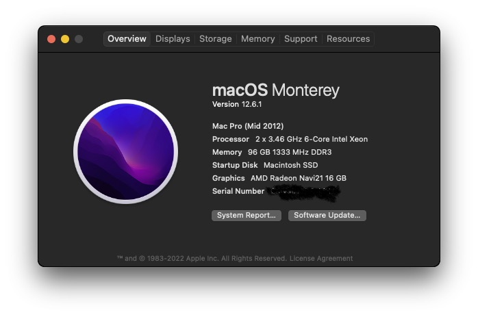

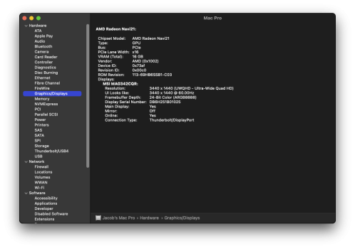

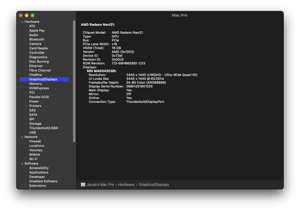

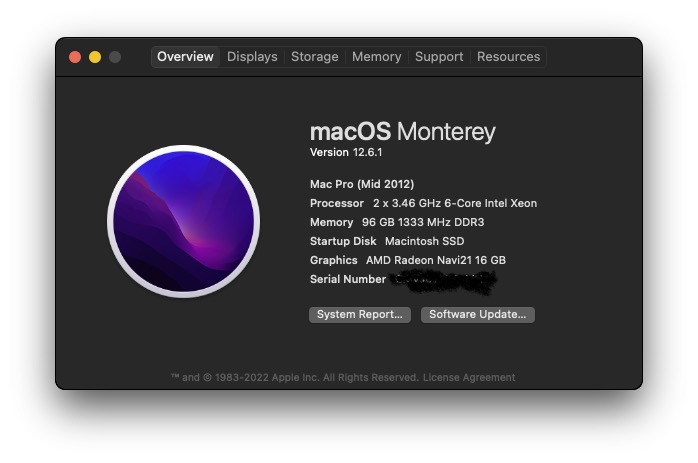

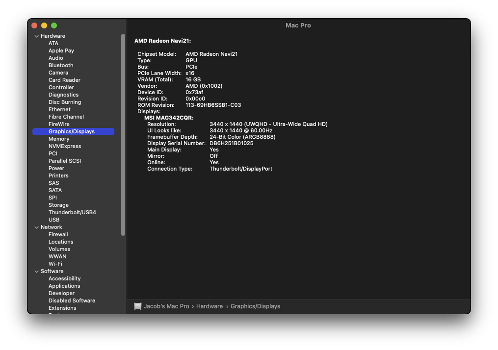

Hey all, I'm using OCLP 0.5.2 and just got a 6900XT which I flashed using Syncretic's patcher. Am able to boot to Mac and Windows but I noticed on Monterey 12.6.1, I'm not getting graphics acceleration like I used to with my 5700XT. My card is being seen as "Radeon Navi 21 16 GB" rather than Radeon RX 6900 XT. Does anyone know how I can get this fixed?
I guess you are using an XTXH card. This card hast the Device ID 73AF. The Mac compatible Card uses 73BF. This can be pacthed with OpenCore. I am not sure if it also works with OCLP on a classic MacPro.
Thanks @jan2ooo , you're right. I just checked here and noticed the card I'm using is there. The XFX Speedster Zero. Didn't realize this would be an issue but happy to know there is a chance to fix it. I can access the OC plist in the EFI partition. How can I go about patching this?
Find the PCI ID of your card using gfxutil. The command for your Device ID "73AF" will be like ./gfxutil | grep 73af
The result will come in PciRoot(NxN)/Pci(NxN,NxN/Pci(NxN,NxN) format. Copy this to your TextEdit. Now delete the last /Pci(NxN,NxN sequence. You should end up with a PciRoot(NxN)/Pci(NxN,NxN). Double check the syntax.
Open config.plist and locate your <key>DeviceProperties</key> key.
Right below this line add:
XML:
    <dict>
        <key>Add</key>
        <dict>
            <key>PciRoot(NxN)/Pci(NxN,NxN)</key>
            <dict>
                <key>device-id</key>
                <data>c78=</data>
            </dict>
       </dict>
    </dict>
Reboot.

I was able to remove that section and I got my bootloader back. But I'd love to get my macOS back up and running normally again. Appreciate the help!
Thanks @hwojtek !
So I followed your instructions and after adding that bit of xml to the config.plist I wasn't getting a boot loader anymore.
Here's the result I got from gfxutil
Code:
0c:00.0 1002:73af /PCI0@0/IOU0@3/PXS1@0/pci-bridge@0/GFX0@0 = PciRoot(0x0)/Pci(0x3,0x0)/Pci(0x0,0x0)/Pci(0x0,0x0)/Pci(0x0,0x0)
And here is the XML I added under Device Properties in the config plist
XML:
<<dict>
    <<key>Add</key>
    <<dict>
        <<key>PciRoot(0x0)/Pci(0x3,0x0)</key>
        <<dict>
            <<key>device-id</key>
            <<data>c78=</data>
        </dict>
    </dict>
</dict>
Why did you enter PciRoot(0x0)/Pci(0x3,0x0) when gfxutil says the path is PciRoot(0x0)/Pci(0x3,0x0)/Pci(0x0,0x0)/Pci(0x0,0x0)/Pci(0x0,0x0) ?
I think you just changed the device-id of IOU0@3.
0c = PCI bus number for GPU
00 = PCI device number for GPU
0 = PCI function number of GPU
1002 = vendor-id (AMD)
73af = device-id (Radeon RX 6900 XT)
/PCI0@0/IOU0@3/PXS1@0/pci-bridge@0/GFX0@0 = I/O Kit registry path in the IODeviceTree plane.
PciRoot(0x0)/Pci(0x3,0x0)/Pci(0x0,0x0)/Pci(0x0,0x0)/Pci(0x0,0x0) = UEFI Device Path.
For a Pci(n,m) node, n is the PCI device number (a number between 0 and 31 or 0x1f) and m is the PCI function number (a number between 0 and 7). PCI bus numbers are not used in a device path since they are dynamically assigned by the PCI enumeration code in UEFI and/or macOS.
PciRoot or PCI0 is an ACPI device. The rest of the nodes in the paths are PCI devices that are accessed through PciRoot. Pci(3,0) or IOU0@3 is a root port at 00:03.0. Pci(0x0,0x0)/Pci(0x0,0x0) or PXS1@0/pci-bridge@0 are an upstream bridge and a downstream bridge of the GPU which may have other devices such as audio controller and USB connected to the downstream? GFX0 is the PCI endpoint GPU device. All of the PCI devices in the path will have a different PCI bus number (because you can't have multiple devices with the same PCI device number and function number connected to the same PCI bus number).
Thanks for the thorough explanation @joevt! I'm still learning so I appreciate you taking the time to explain it. I left it as PciRoot(0x0)/Pci(0x3,0x0) because I thought I had to leave it at 2 levels but I understand now how the pathing works.
So if I understand correctly, this should be the correct XML added to the config.plist?
XML:
<<dict>
    <<key>Add</key>
    <<dict>
        <<key>PciRoot(0x0)/Pci(0x3,0x0)/Pci(0x0,0x0)/Pci(0x0,0x0)/Pci(0x0,0x0)</key>
        <<dict>
            <<data>c78=</data>
        </dict>
    </dict>
</dict>
As for the device-id is c78= the correct data? I'm spoofing the 73af to be 73bf so my mac sees that its a regular 6900 XTX model and not the XTXH model, but I'm not sure if c78= is the correct value.
The Device-ID in <data> section is written in Base64. So your 73bf becomes c78=
Edit: oh, wait, shouldn't it be written with reversed bytes? Not 73bf, but bf73? It may be. In this case it's v3M=.
XML:
<<dict>
    <<key>Add</key>
    <<dict>
        <<dict>
            <<data>c78=</data>
        </dict>
    </dict>
</dict>
Looking at ioreg -fliw0 it appears that device-id is data containing 4 bytes as little endian.
The following converts 73bf (expressed as a 4 byte big-endian value) into a little endian value encoded by base64:
xxd -p -r <<< 000073bf | xxd -e | xxd -r | base64
The result is this: v3MAAA==
You can check the result with this:
base64 -d <<< v3MAAA== | xxd -p
which returns bf730000
Understood, I wouldn't have known to do this so thank you again.
Unfortunately, I tried with both below and still don't get the boot loader screen.
What @joevt suggested -
XML:
<<dict>
    <<key>Add</key>
    <<dict>
        <<dict>
            <<data>v3MAAA==</data>
        </dict>
    </dict>
</dict>
And what @hwojtek suggested -
XML:
<<dict>
    <<key>Add</key>
    <<dict>
        <<dict>
            <<data>v3M=</data>
        </dict>
    </dict>
</dict>
Looking at the config.plist I noticed the beginning section references 73AF. Could it be I need to change something there?
XML:
<key>Build-Type</key>
<string>OpenCore Built on Target Machine</string>
<key>Build-Version</key>
<string>0.5.2 - 2022-12-06</string>
<key>Hardware-MacPro-dGPU-1</key>
<string>1002:73AF</string>
I also reached out on the OCLP discord and @Ausdauersportler redirected me to this MR forums post regarding gpu spoofing and I'm wondering if I need to add more info?
I assume you already load whatevergreen.kext. Do you have -unfairvga shikigva=128 in your boot-args?
I haven't done this yet. I wasn't sure how much mirroring I could do from the hackintosh community since I have a Mac Pro 5,1 on OCLP which uses OpenCore I thought it would be a little more simple. Is there a how-to or instructions on how I can do this? I found a few threads but the information is kinda scattered or dated.
Some Navi 21 cards currently require the boot argument agdpmod=pikera to get a display out.
Thanks! Do you think keeping the spoof xml I sent earlier along with this argument is enough to get it working again? Where do insert
Code:
agdpmod=pikera
