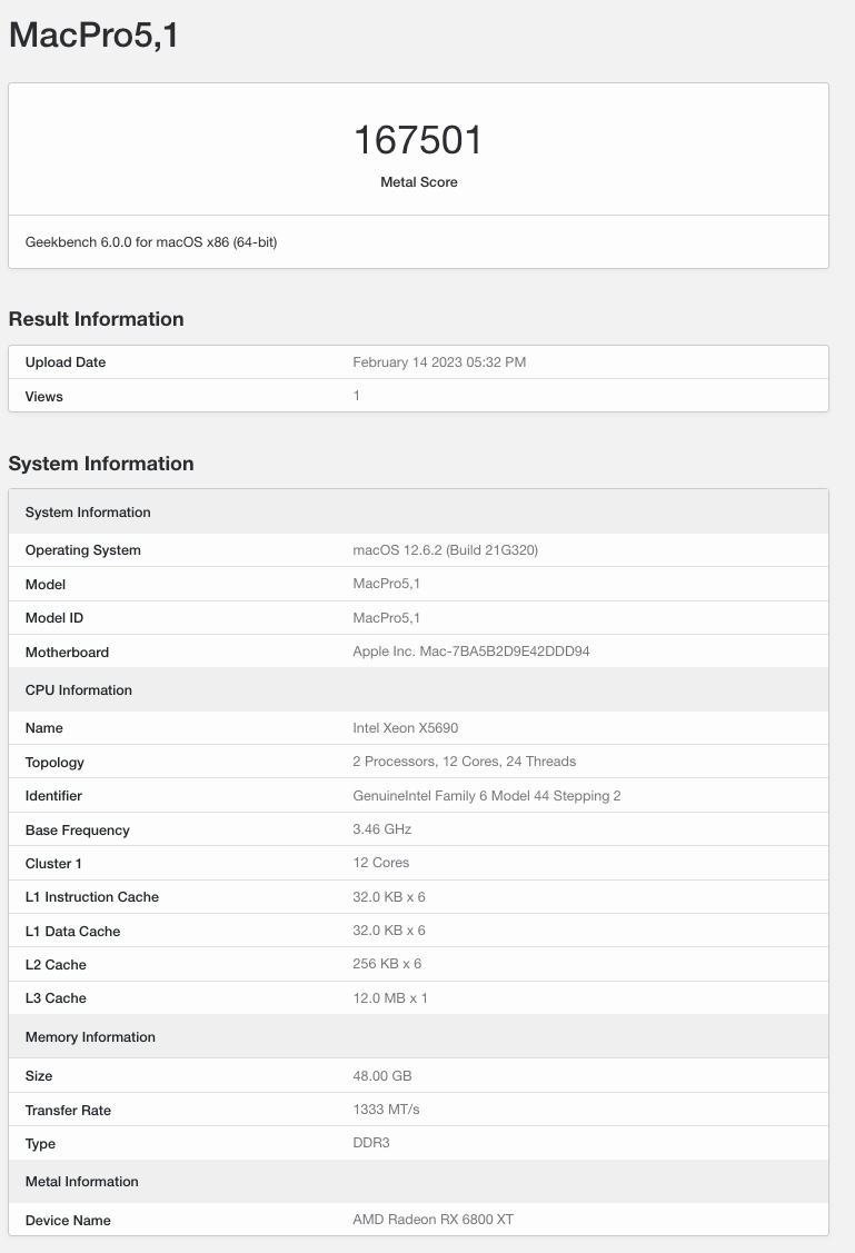

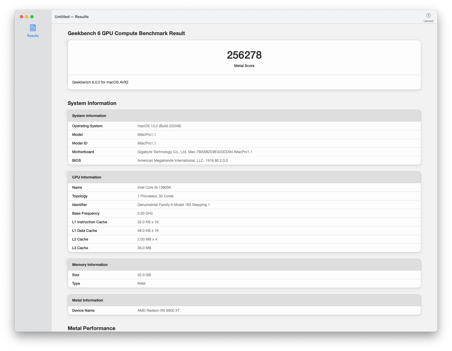

Geekbench 6.0 Rewleased here's my NcMP 7,1 with a Gigabyte TX6800XT - Metal:
Score is up from Geekbench 5.

It's not that your card suddenly got faster with the new edition of Geekbench, it's that GB scores are only comparable between the same edition. 100k in GB5 is not the same as 100k in GB6.
Yeah, this same thing happened when GB4 went to GB5. It's going to take a little time to standardize to the new metrics in GB6.

I wonder if macOS version also aids in increasing score?
It can occationally, e.g. driver efficiency improvement
But in this case, it's the test itself changed. If you compare the detail items at the bottom of that score page, you can see the tests are very different in GB5 and GB6.
