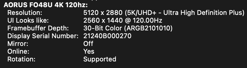

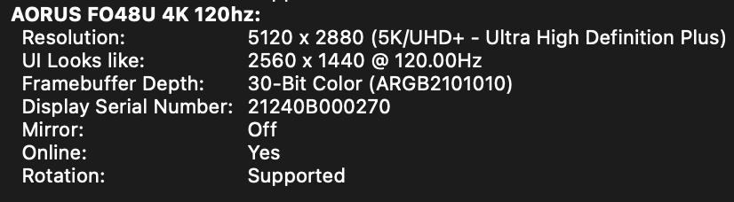

So after using SwitchresX I am now getting 4k 120Hz

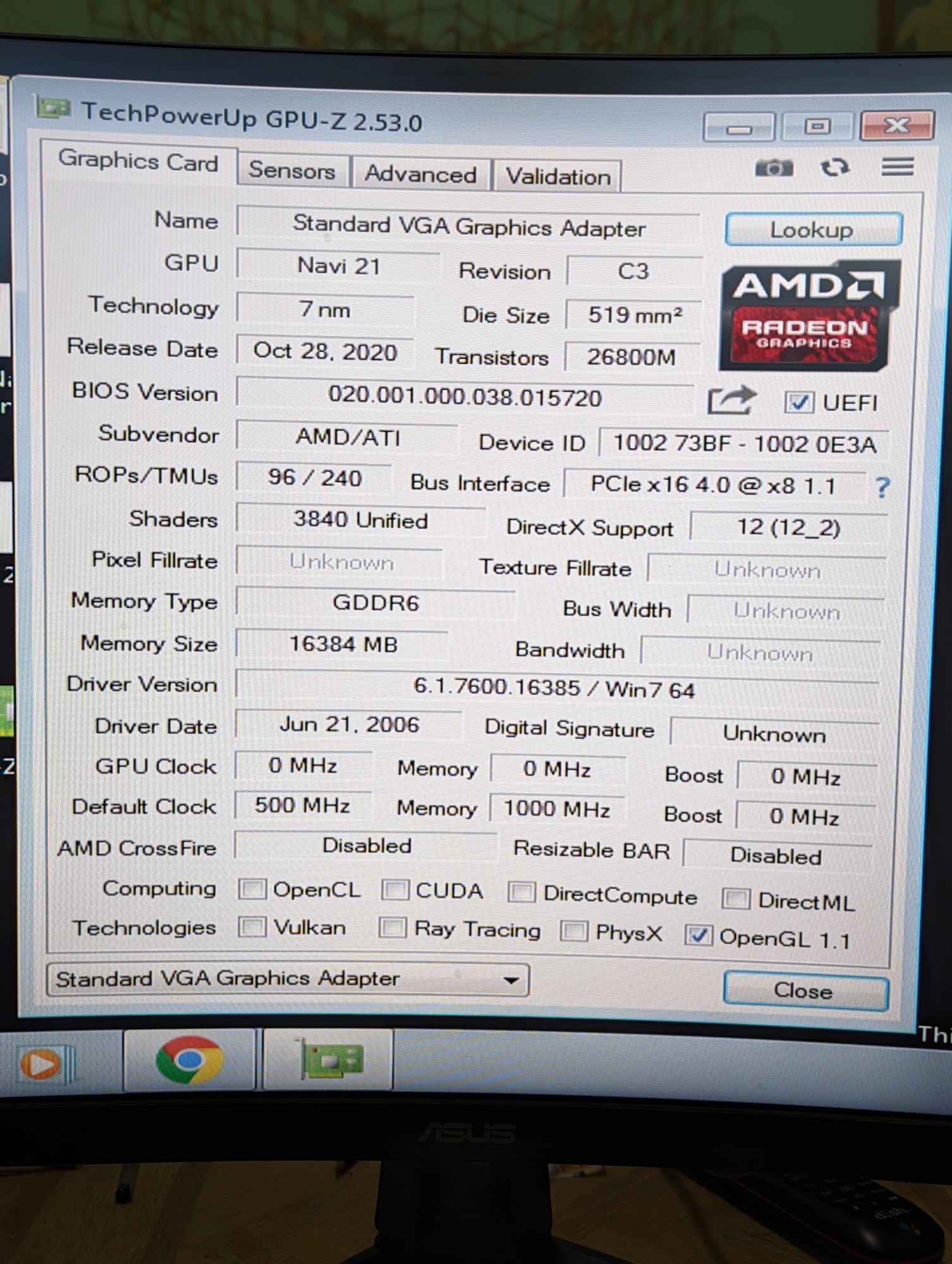

Ok getting my Rx 6800 today. Got my very old windows pc to see my rx 580 so i think its ready to flash the 6800. Crossing my fingers haha.

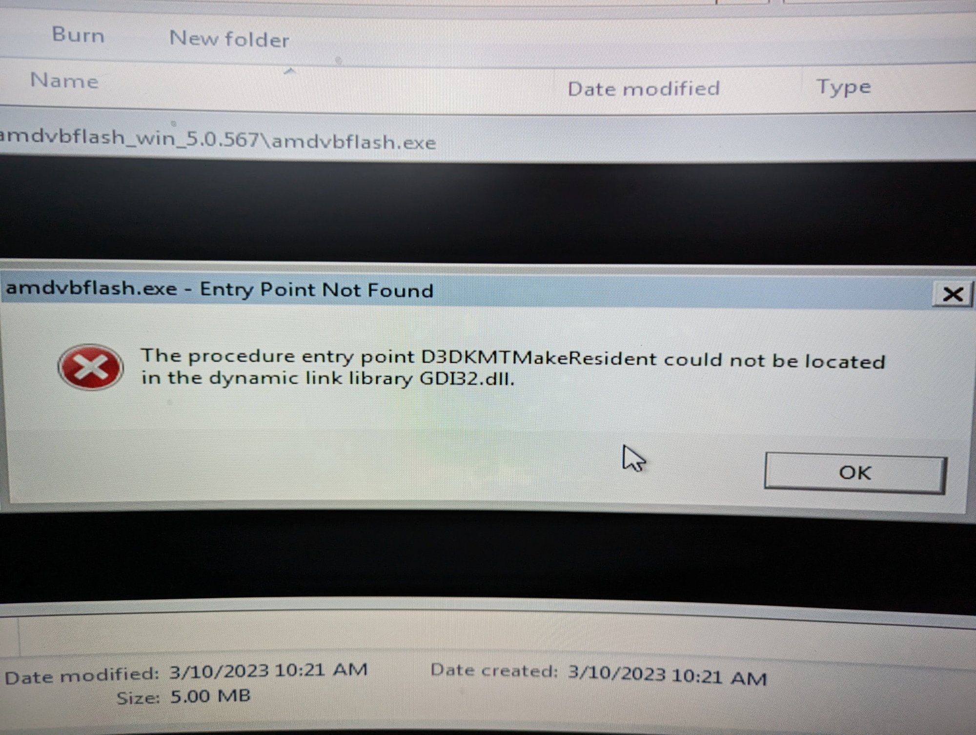

so having some issues. can't get amdvbflash to load. keeps saying The procedure entry point D3DKMTMakeResident could not be loacted in dynamic link library GDI32.dll.
Try Linux, just make a bootable LiveUSB is good enough, no need to install anything.

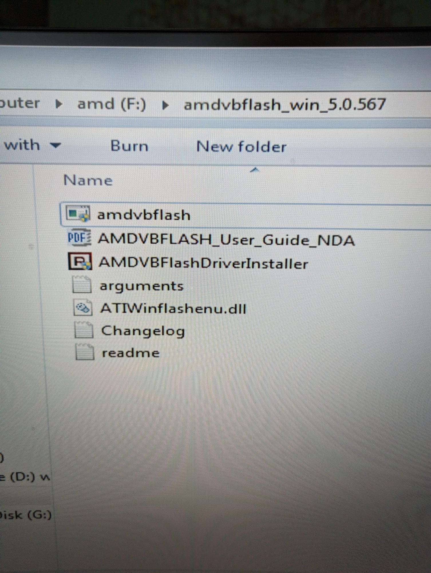

So my pc is old. it has a athlon 64 in it with 2gm ram. says i can't put windows 10 on due to cup. been trying everything to get amdvbflash to load it just won't. I can do everything except get the flashing program running. here is a pic of what gpu-z shows.

here is what it says. can't figure it out. so old it won't let me boot from usb so linux is out.
if your pc is that old, you can try the dos version of
AMDVBFlash.​
