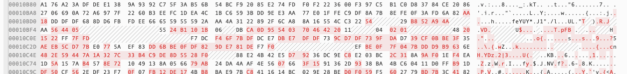

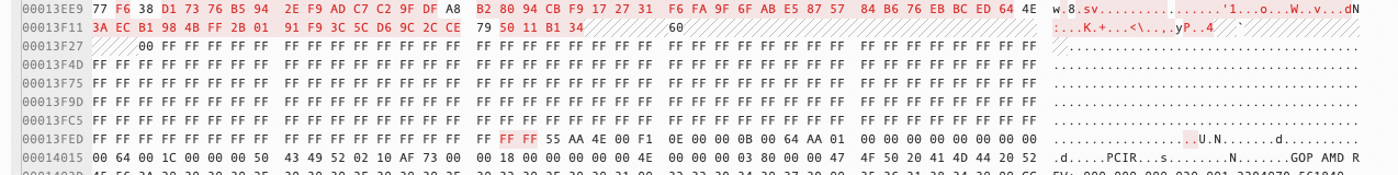

Are you sure you actually patched the vbios? I don't see a difference between both attached. Also don't forget before patching for GOP you need to patch for booting with cMP with syncretic's patch first.
Wow... i never mind they are the same because i use the FixRX6x00ROM.exe to change it.
I double check all now and tell you what happen
Anyway, thank you so much for your help
Edit : i found some difference between the two files here : start end of differences
but i don't patch for GOP because i was afraid to made a mistake...
I try now
Hmm, just compared the two files with HexFiend and found them far from beeing identical...
...but you are perfectly right: Syncretic's has to be applied before injecting the GOP-enabler! After, it just does not work anymore. Most likely cause some of the rom's parts/offsets are not where they are expected anymore.

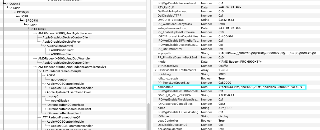

So the Syncretic's patch was correctly applied but my problem is the graphic card is not well recognized in my 5.1 and everything is very slow + no acceleration available in Videoproc...
It's like the driver not recognzed the card.

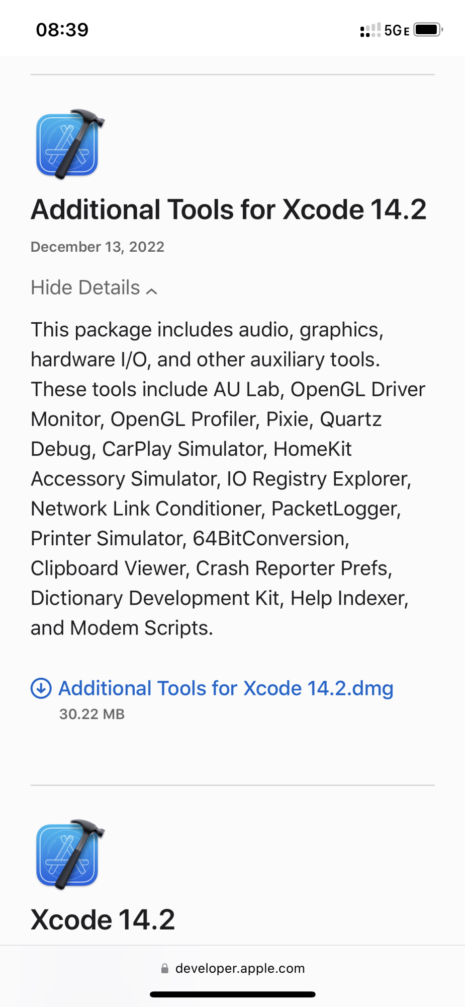

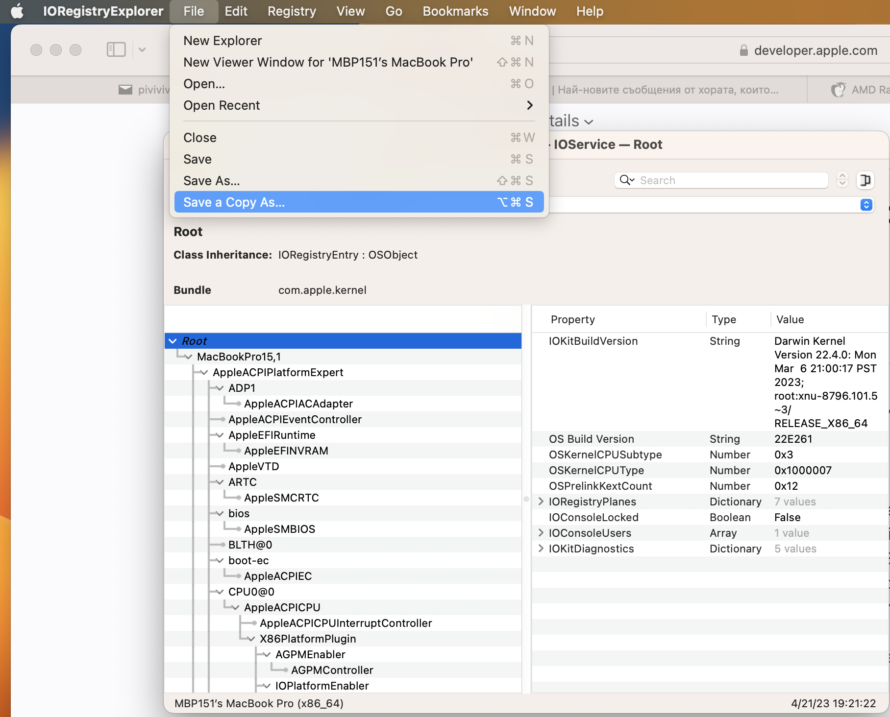

Send me a copy of the IOTegistry IORegistry backup with the card installed.
Installed in the Mac or in the PC ?
How can i find the IOTegistery ?
Sorry, i'm newbie :rolleyes:
Sorry misspelled it. IO Registry explorer can be downloaded from the free Apple developer account. Once you log in look for:
Yes the driver is not attached. Try this SSDT.

I do everything you tell, step by step
Changing false to true don't give result
Changing 0xAE by 0xBF make loop booting
I made reset SMC and Zap NVRAM but remain the same, loop booting
Attach, IO Registry after booting with config.list changed from false to true
  • MPNE293OX_v3.zip
