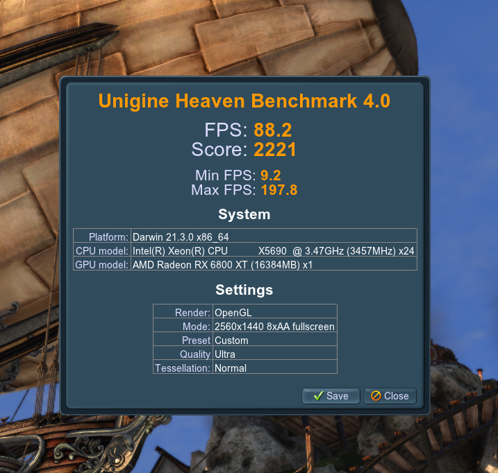

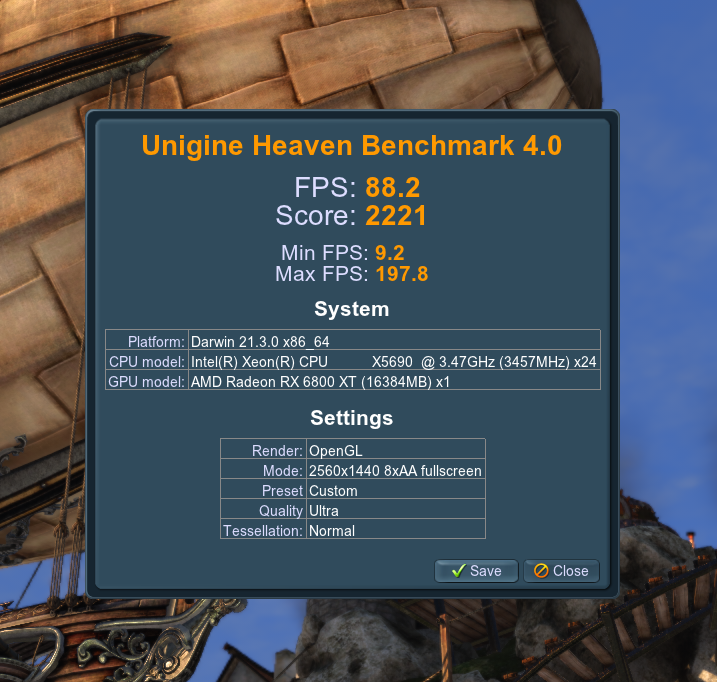

Hi Lance,Some benchmarks please.

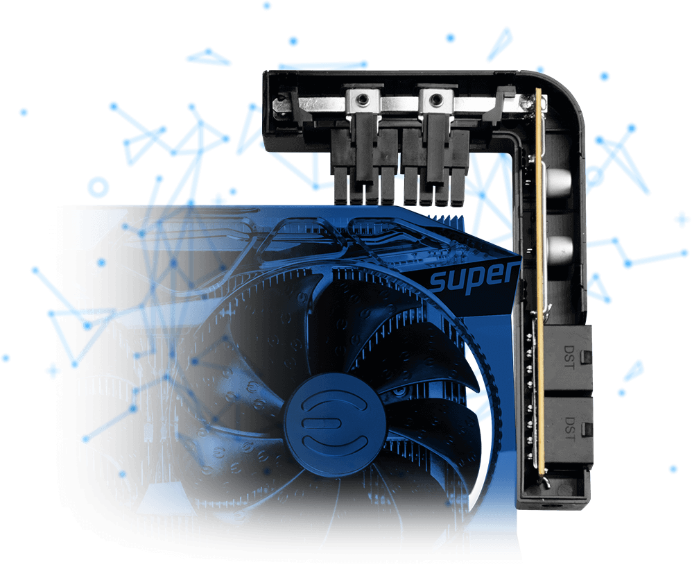

Here is your answer how the balancing works. There are resistors on that little board as well, which makes it an RC-Circuit solution. Here is the functionality and scientific background down below. (High-pass/Low-pass and such)As far as this picture shows, aside of two caps, there are no electrical componets inside. So, if the output-connectors are just clamped to the very same two pieces of metal, what kind of „balancing“ should happen thereafter?

Attached you will find the Heaven Benchmark with the same settings you used. Its about the same as your Sonnet. Though I can use a single SSD in Slot #2, the dual Crest I/O bridge card would give it an additional boost. But then most fans would be obstructed, so I decided to use only the very short single SSD PCI card so far to allow ample airflow.

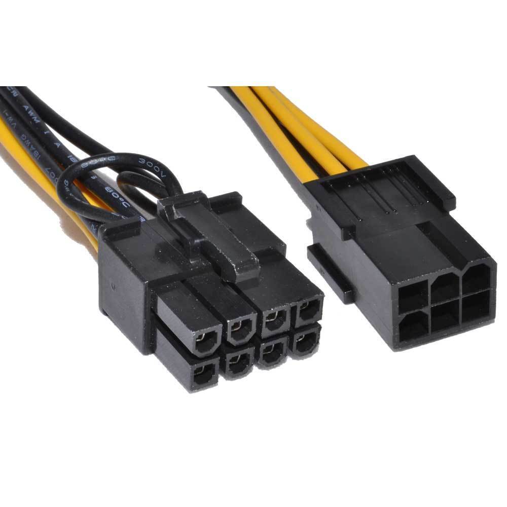

Just a short question about my AMD Sapphire nitro+ RX 580 which has 8+6-pins:You are thinking only for GPUs that have a single 8-pin power input, VEGA and no low-end NAVI GPUs usually have 8+6-pins or 8+8-pins. You can't balance it with just the cables when the GPU have more than an 8-pin power connector.
Modern GPUs have different power planes for different parts of the circuit, like one for the HBM and another for the GPU core, since intentionally or not the PowerLink circuit shares the load equally between the two backplane PCIe AUX connectors, this is very helpful to us to avoid the SMC emergency shutdown when one backplane power connector is having an excessive power draw while the other is drawing below the maximum, a very common scenario with modern GPUs.
Is this correct, or how would I power this card differently using both the 8 and 6 pin power inputs?
Okay, as I understand: 6pin-to-6pin and 6pin-to-8pin. -- Does it make a difference to power the card this way vs. 2x6pin-to-8pin?

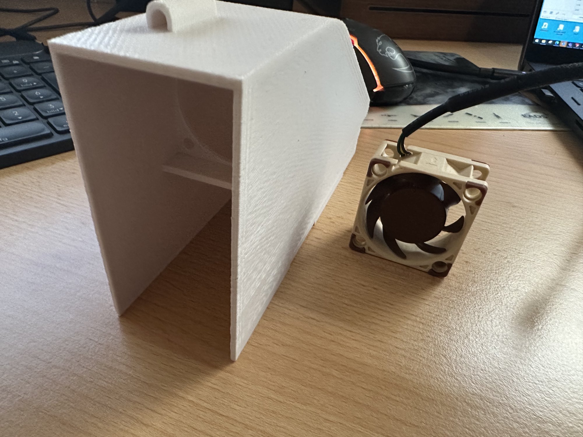

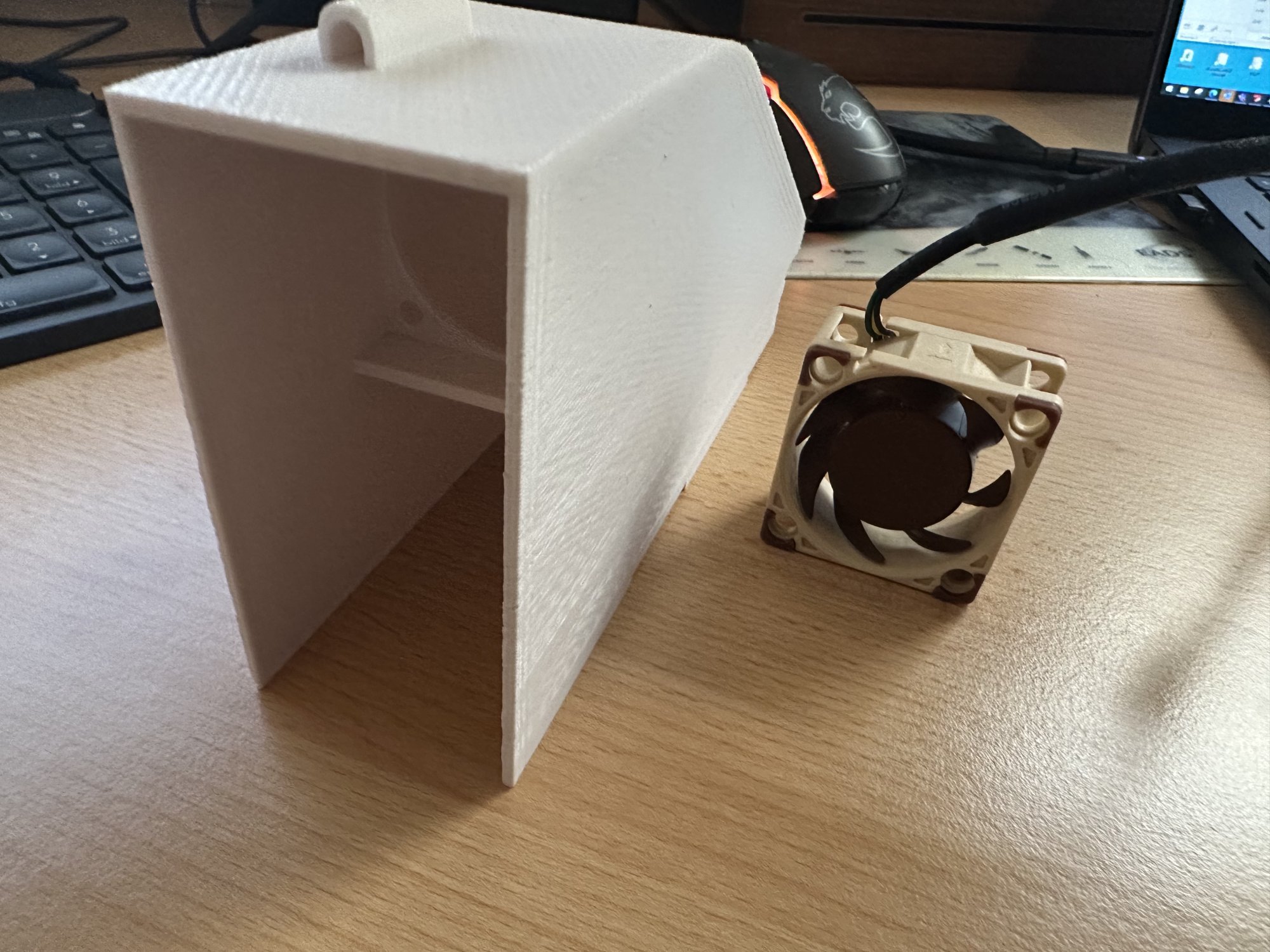

I may got just the thing. Down below see the link to the Northbridge-cooling-self-help-group.
I got myself inspired by Tsunami's solution, so I have ordered that 3D part in Belgium. Since I am located in Germany, shipping wasn't an issue. However I am low on time and not all USB parts for my 5V fan power solution have arrived yet. I hope I can post some results beginning of April when I get more time again.

So one other question to this: Does it make any difference wether the PowerLink is fed by two mini-6-pin -> single-8-pin cable to one of it's inputs or two seperate mini-6-pin -> 6+2-pin cables to both of them?You are thinking only for GPUs that have a single 8-pin power input, VEGA and no low-end NAVI GPUs usually have 8+6-pins or 8+8-pins. You can't balance it with just the cables when the GPU have more than an 8-pin power connector.
For each option, count the number of 12V lines and ground lines. The minimum of those two counts determines the max current the option can take (if the wires are all the same gauge).So one other question to this: Does it make any difference wether the PowerLink is fed by two mini-6-pin -> single-8-pin cable to one of it's inputs or two seperate mini-6-pin -> 6+2-pin cables to both of them?
Would tent to say logically no, as it all ends up on the same two rails anyway. But maybe i am (again) missing something. I'm asking cause i allready have the dual -> single and planing to finally fet one of these 6800 founders.
In general, unless some wires in the 6pin / 8pin cables are not connected properly. The card should just draw whatever it need until the cMP shutdown. "Not enough power" should not be the root cause of the artefacts (assuming there is PowerPlay table to limit the core voltage, etc).wnt today for upgrade for RX Vega 56 from mini-6pin to 8pin + mini6pin to 6pin
