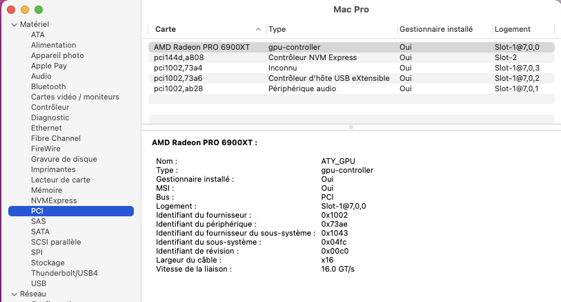

Changing 0xAE by 0xBF make loop booting

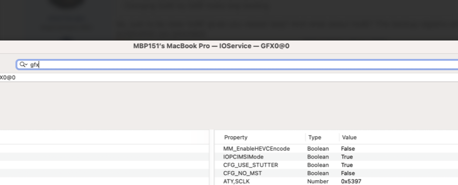

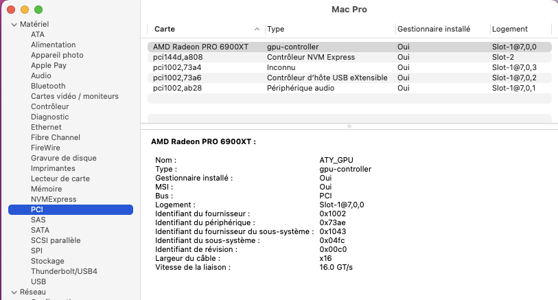

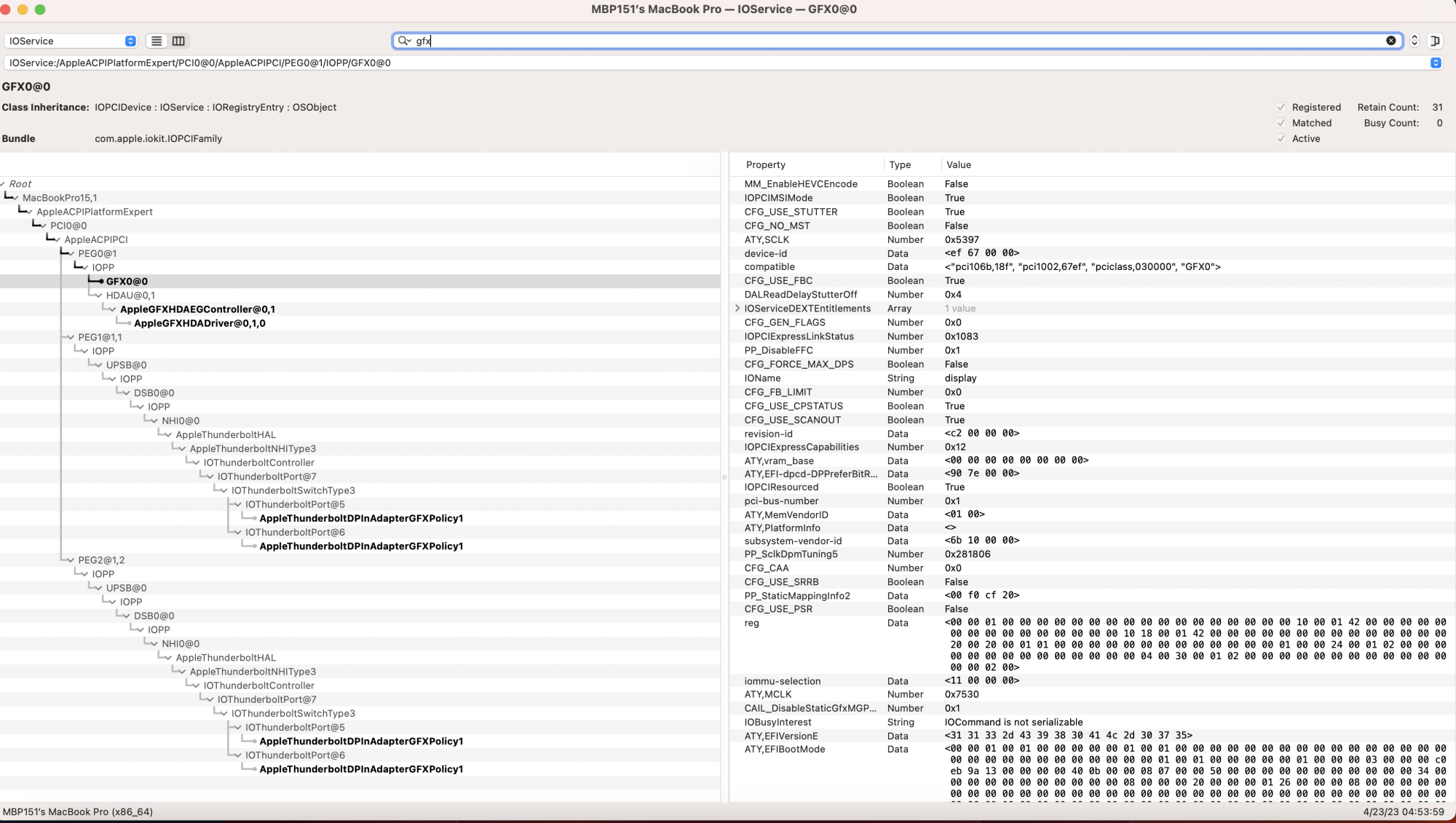

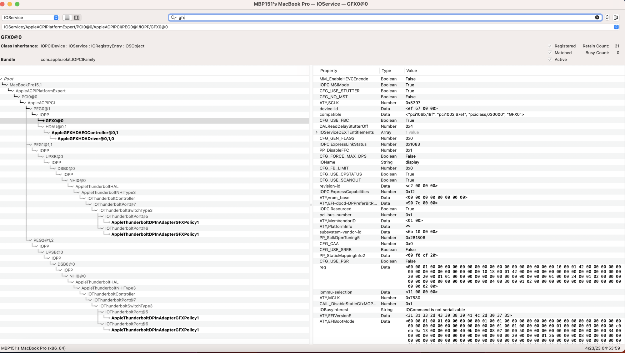

So, just to be clear 0xBF gives you reboot loop? And what about 0xAE? The backup registry attached is different from the screenshot you provided:
device-id here is 0xEF not 0xAE.

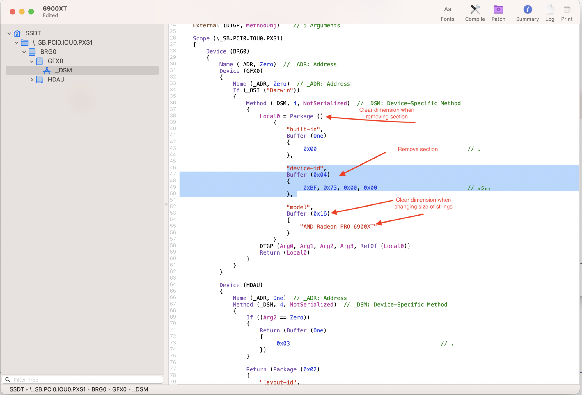

You can delete altogether the device-id section in the SSDT:
macOS will try to match the driver automatically.

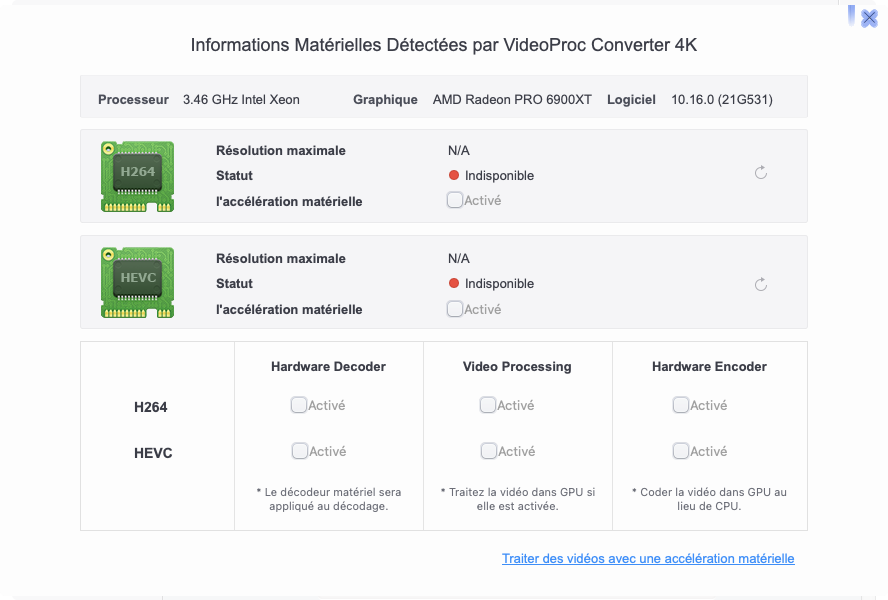

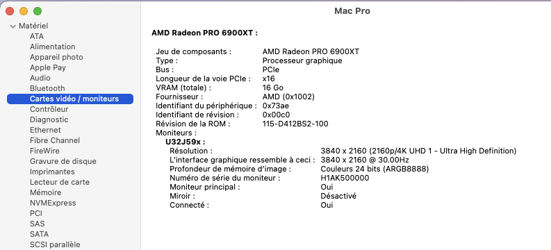

0xAE give me normal boot but very slow display and no acceleration
0xBF give me reloop boot
The backup registry you show is yours ;)
I tried now to change the SSDT
Still sleeping :). Ok, so the SSDT worked, but it does not like so much 0xAE and 0xBF does not let it boot. How about removing the device-id from the SSDT? You need to find a device-id match which will load the driver. Try this SSDT
  • 6900XT.zip
I try now with SSDT without device-id...

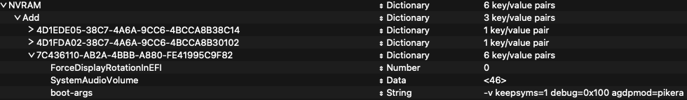

  • Under NVRAM -> Add -> 7C436110-AB2A-4BBB-A880-FE41995C9F82 -> boot-args, append the boot arg agdpmod=pikera -radcodec
    • -radcodec: Used for allowing officially unsupported AMD GPUs (spoofed) to use the Hardware Video Encoder
    • NVRAM Section
  • Save the file

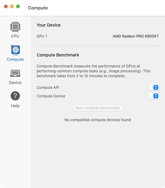

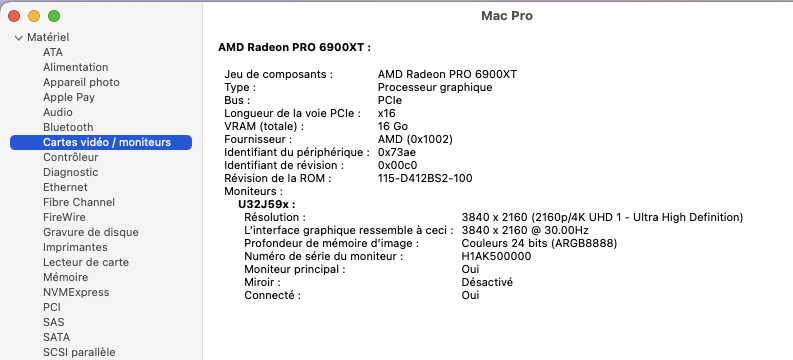

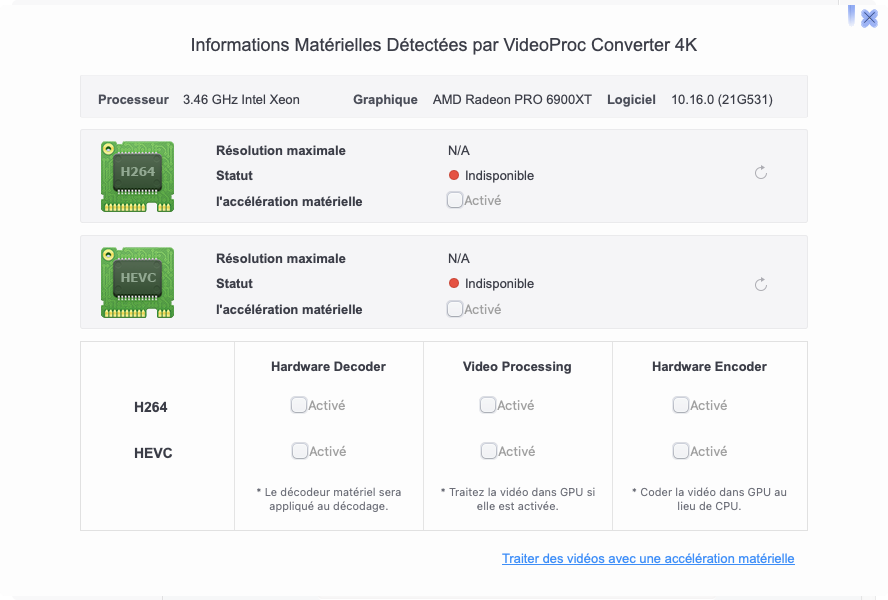

Good morning Startergo,

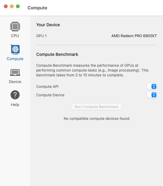

I do all the change but always no results...sorry
Please find attached :
  • Last config.plist used
  • Last IO Registry backup
  • 4 screen captures

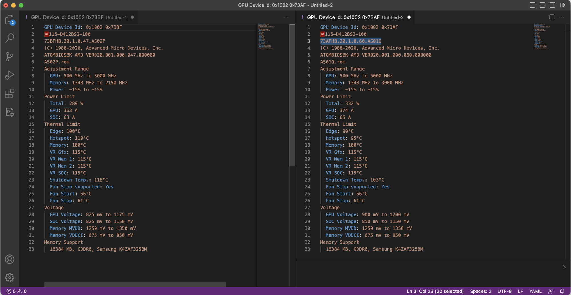

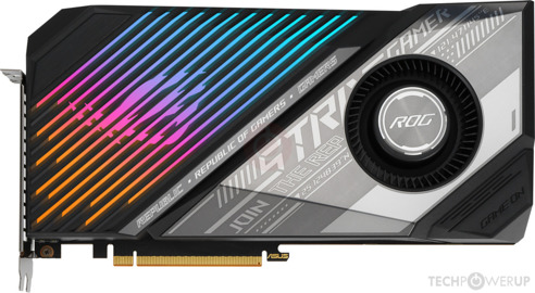

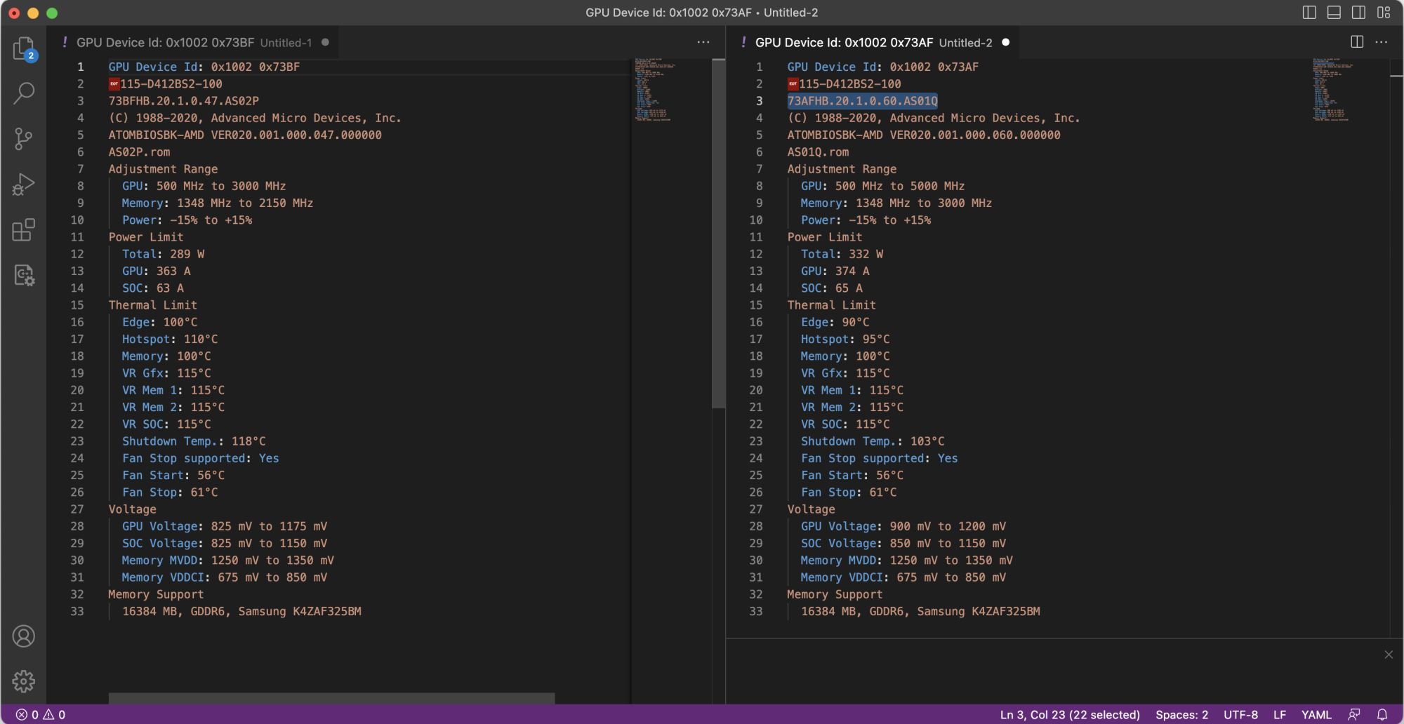

@olixsm it is weird, but the same part number comes with 2 different vBioses:
73BF is the supported vBios and 73AF is the unsupported one. Essentially it is a modded vBios and theoretically the 73BF vBios should work for your card. The biggest differences are the top end of the memory frequency, some thermal limits and the memory clock. You can try flashing this vBios (obviously after applying the fixROM):
Your vBios is here:
Your vBios is here:
