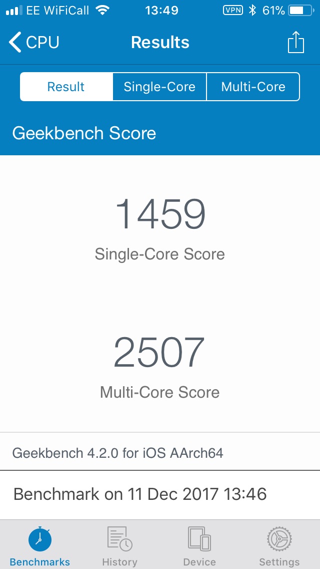

My iPhone 6S has been slow for some time and according to Geekbench, it now has about the same performance as my iPhone 6. I bought the 6S for its faster processor.

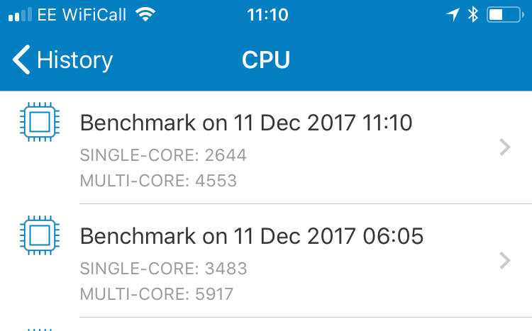

I believe I have discovered an issue, possible since iOS 11.2 that the CPU is throttled when the battery % level drops below a certain level, such as 50%.
Benchmark shows the score at 100%(bottom) and at 43% top.
Would be interesting to see other scores from a variety of iPhones. This is pretty shocking of Apple if proved true.

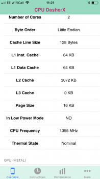

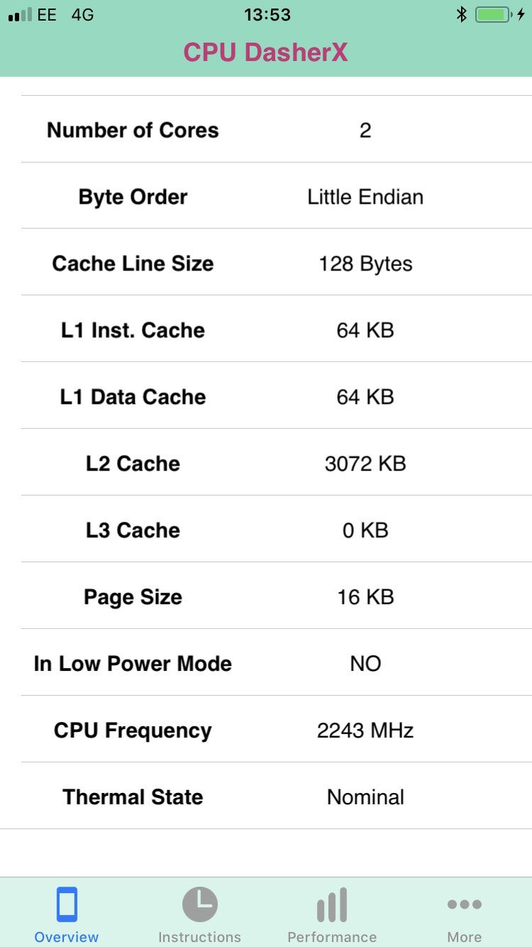

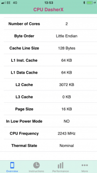

[doublepost=1513000575][/doublepost]More proof. Look at the cpu frequency when battery level is low.

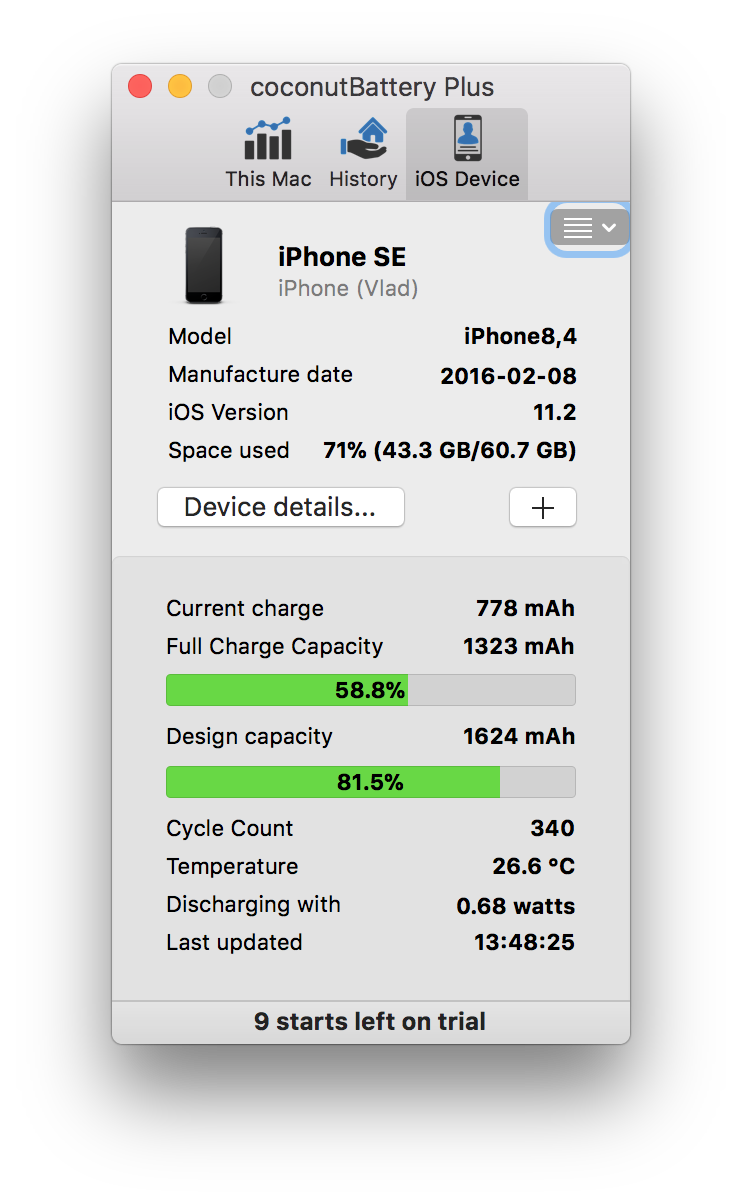

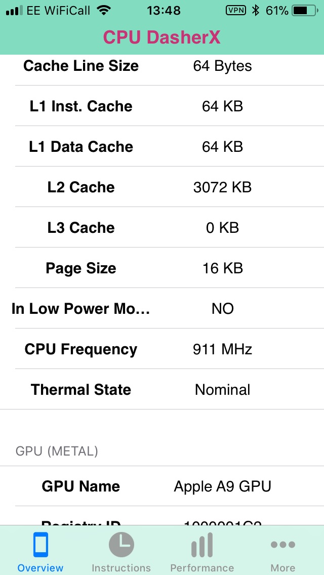

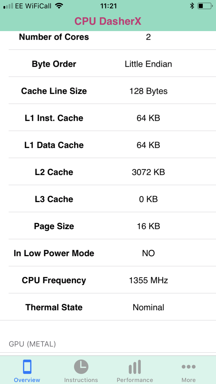

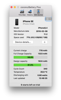

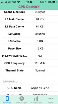

iPhone SE. Recently I began to wonder why my iPhone SE is as slow as iPhone 6 on running the same iOS 11.2. Now I know why! Will be replacing my battery ASAP! Thanks everyone!
Screen Shot 2017-12-11 at 13.48.47.pngUNADJUSTEDNONRAW_thumb_d23.jpgUNADJUSTEDNONRAW_thumb_d24.jpg
