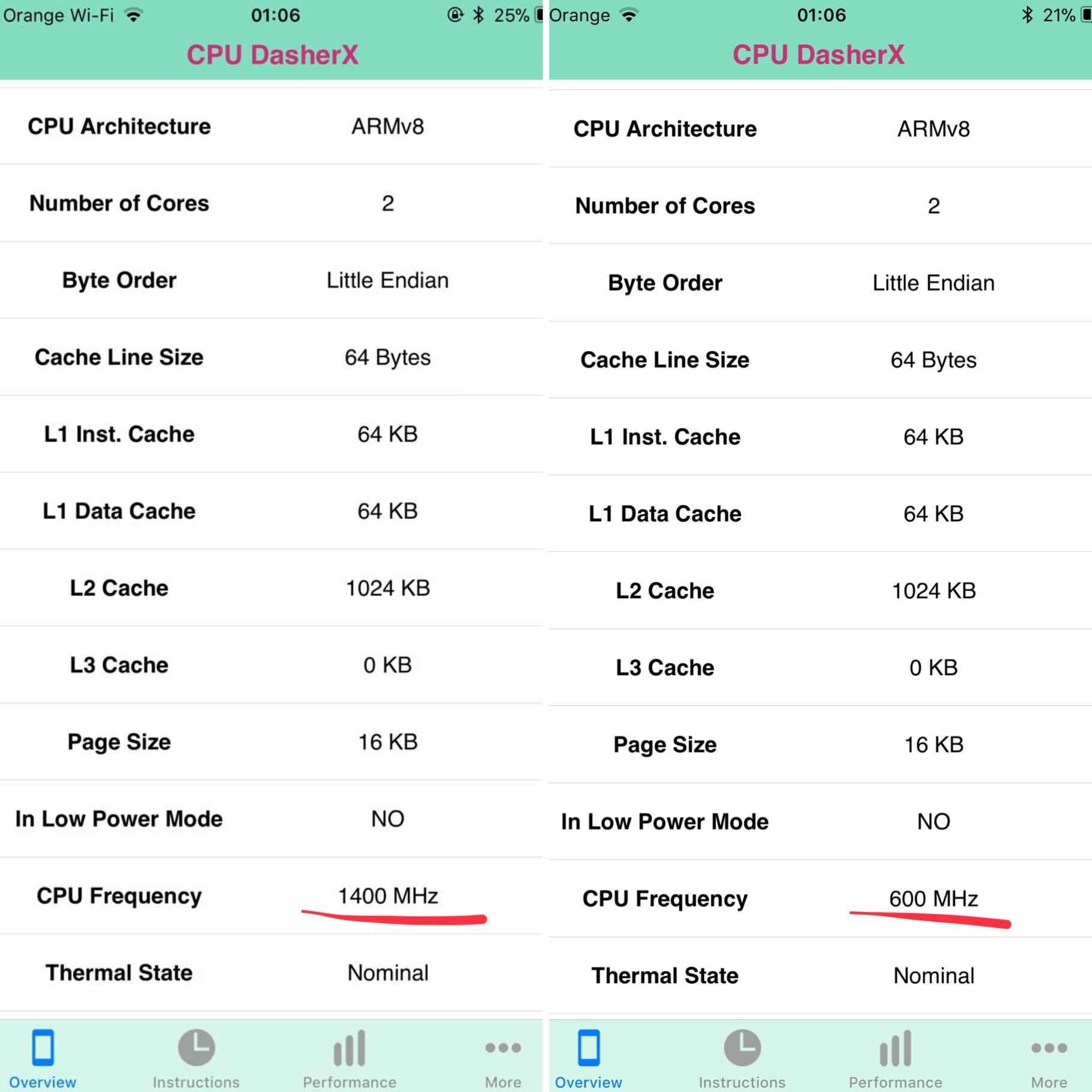

I believe I have discovered an issue, possible since iOS 11.2 that the CPU is throttled when the battery % level drops below a certain level, such as 50%.
Benchmark shows the score at 100%(bottom) and at 43% top.
Would be interesting to see other scores from a variety of iPhones. This is pretty shocking of Apple if proved true.

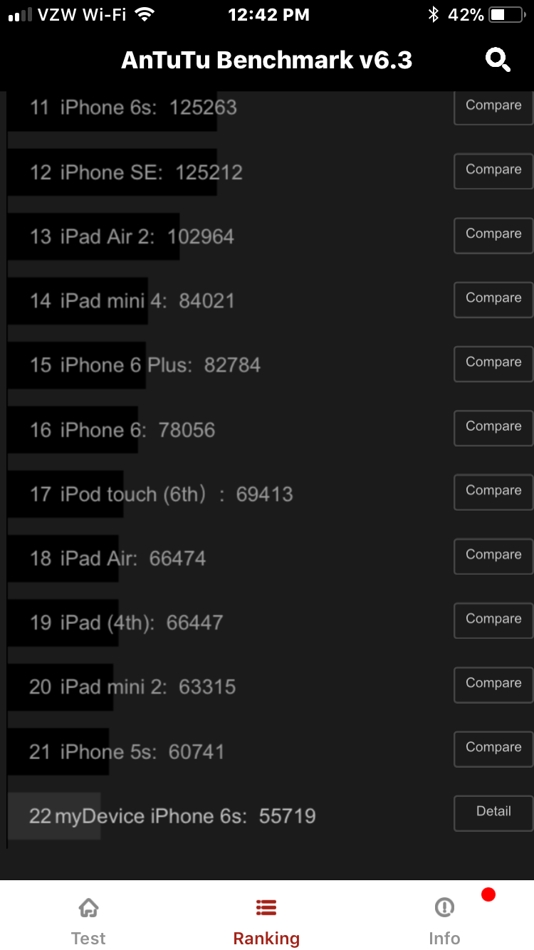

Geekbench reports a much lower score for my 6S than for my 6:
iPhone 6 (about 2 year old battery)
Single: 1557
Multi: 2682
iPhone 6S (about 1 year old battery)
Single: 1047
Multi: 1755

Just to be sure, my about 1 year old iPhone 6S is about half as fast as it should be (according to Geekbench) and is even slower than my two year old iPhone 6. There were no warning messages or anything like that.
