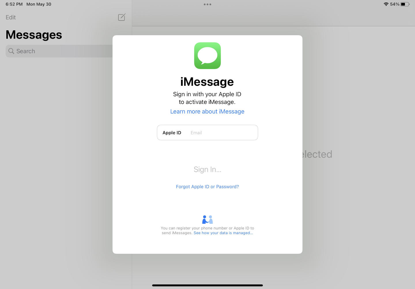

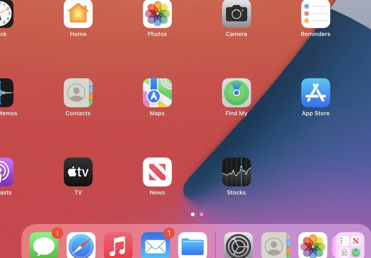

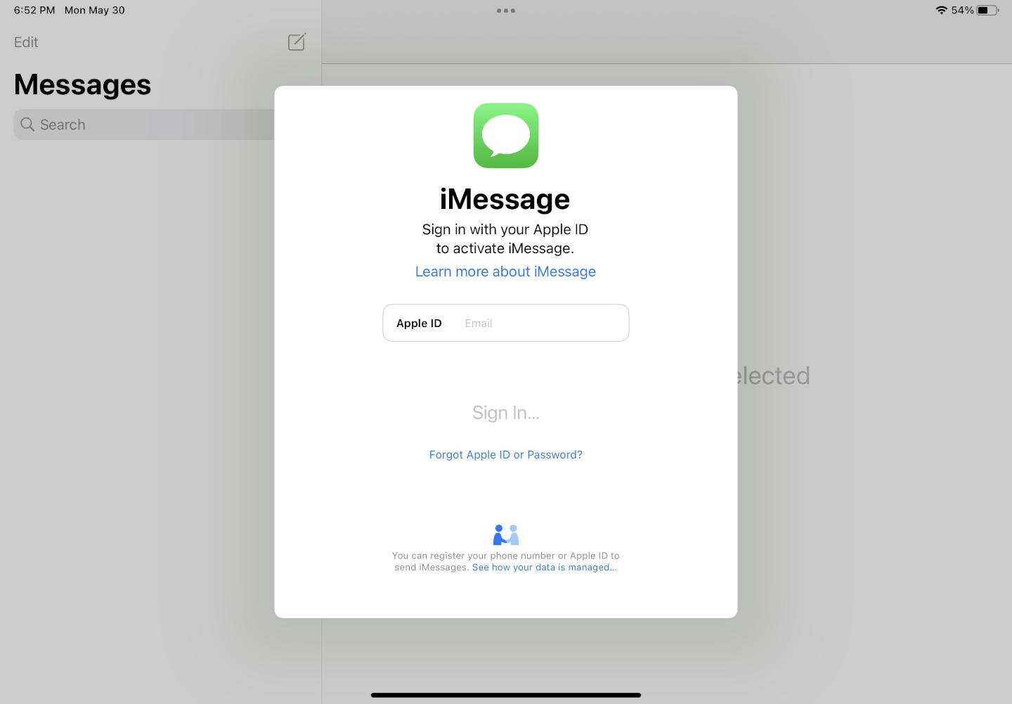

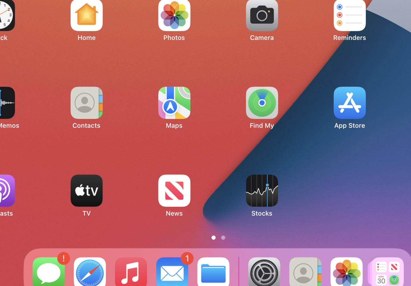

While not specifically macOS this is a screen capture from my iPad Air 4. As you can see iMessages is alerting me for some action. That action is to log in with my Apple ID. I don't use iMessages and therefore I don't want to log in to iMessages. Yet the alert sits there.
All companies need to stop trying to force cloud connectivity on us. Microsoft is the worst offender with Windows 11 Home.
All companies need to stop trying to force cloud connectivity on us. Microsoft is the worst offender with Windows 11 Home.View attachment 2011474

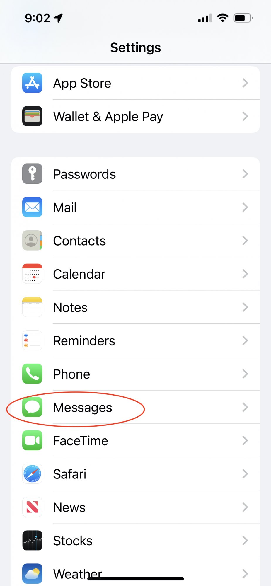

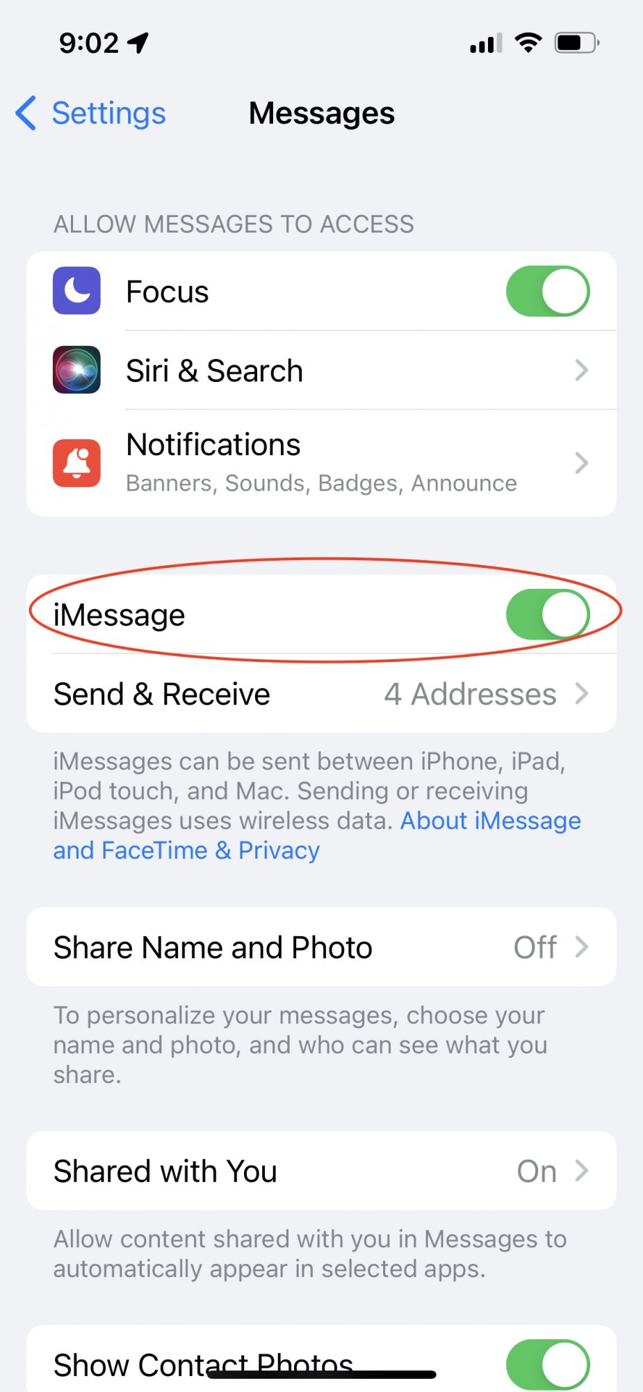

That goes away if you click on it and choose not to do that. You can also turn off iMessages entirely if you don't want to use it. They're not forcing anything on you. If for some bizarre reason you want to use the inferior SMS only, that's entirely up to you.
Great! Where?
