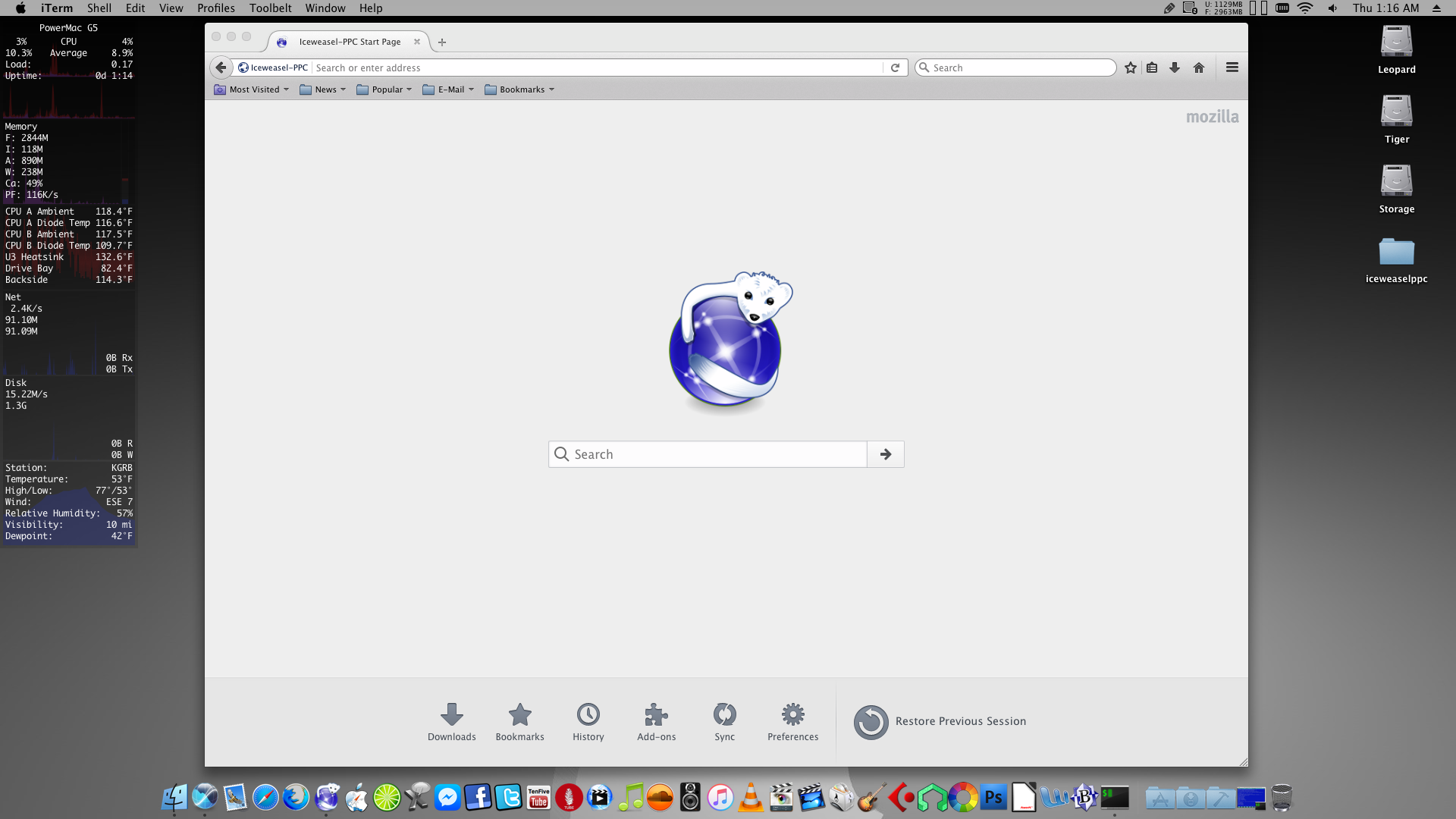

And: <uninitiated> what are IceWeasel-PPC and foxPEP 1.8.2 </uninitiated> ?
A stripped, lighterweight, and faster TenFourFox...
...And a universal Firefox patch script that does all the work of advanced tweaking and optimization for you - on any machine, OS, or Firefox-like browser it's thrown at. Revision 1.8.2 is the current development version.
