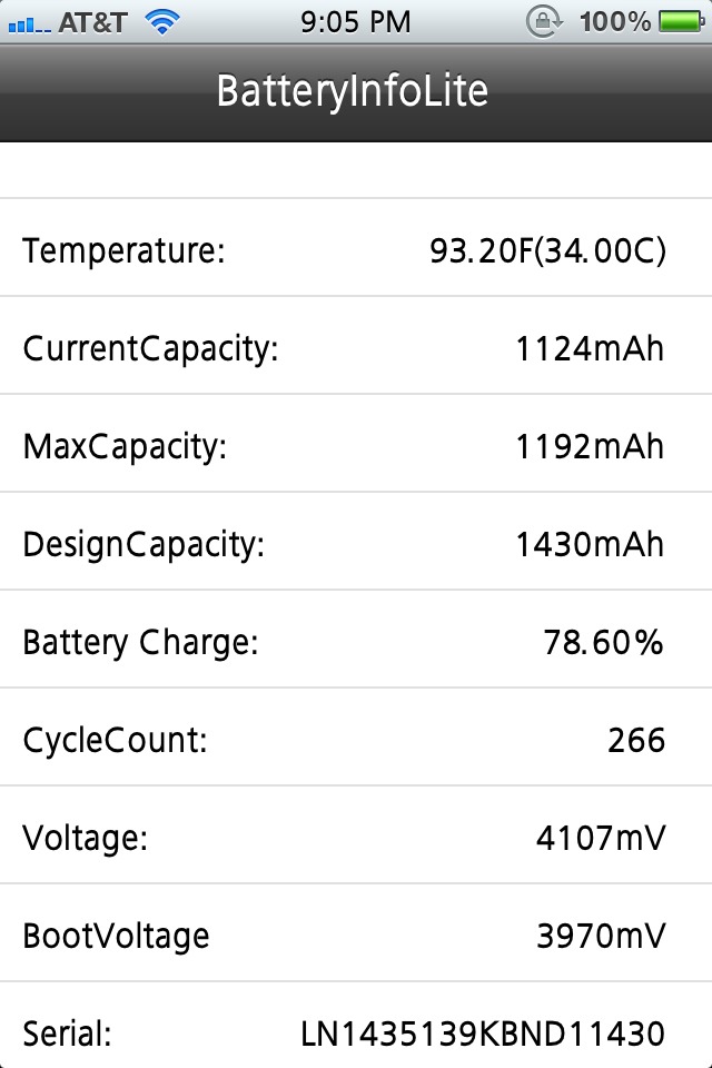

I get pretty great battery life and I'm a heavy user. On average I get about a day/day in a half without charging and I think if I had a bad battery I wouldn't be getting that kind of life out of it. I also don't believe that I have 266 charge cycles, just doesn't seem possible to me.
Lol I'm confused. Why did you ask if you should get it replaced if you are getting great battery life? I wouldnt take it in if I were you. You would have to restore your phone as new just to take it in to apple genius. You're in good shape! I am a really heavy user and I don't usually get a full day so you should be happy about that. Thats really good! I usually plug mine in at some point during the day but when I don't use the phone at all, my battery barely drains in standby mode.
If your really questioning it, then restore it and take it back. I personally wouldn't be happy if mine reported that.
But I also know, that over time you can retrain it, just likely isn't worth it unless your willing to be OCD about it for a while. >__<
I mainly say to take it back, because the fact your still under warranty.
