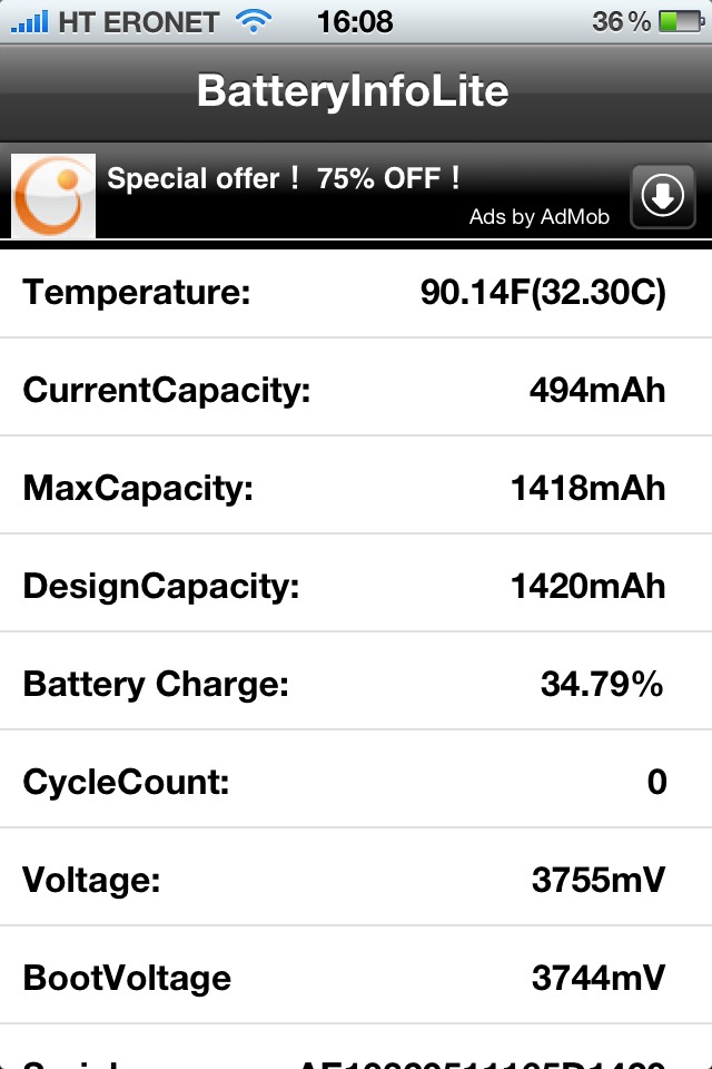

Current capacity 1319
Design capacity 1420
Load cycles 86

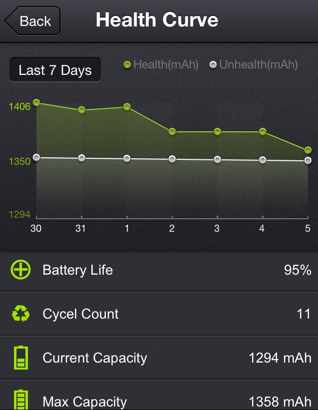

My capacity has dropped to 1363mAh after just 11 charges and I have no idea what I'm doing wrong. I did one full cycle when I replaced the battery (as I read that's recommended to do) and ever since I charge my phone daily when it drops to 25%-35% and I leave it on until trickle charging is done. I use battery doctor pro and I get a beep when the charging is done but somehow the capacity keeps dropping rapidly. Can anyone tell me what I'm doing wrong?

Now the max capacity dropped to 1358mAh, before the charge I was at 23% and the capacity was 1363mAh and I imagine it will drop even further more. Still don't have a clue what's going on.
Here's a screenshot of battery doctor pro:

Interesting thing happened. I got rid of the "battery doctor pro" tweak I installed through cydia, let me phone fully drain and turned it off manually. After that I recharged it to 100% and turned it on.
Two days later and 2 charges (3rd one in progress as I write my post) and my max capacity went up to 1353mAh from the previous 1345mAh. Also my battery life is better as well after I did all this, I got like 8 hours of usage and still had like 20% left before this current charge I'm doing.
If the max capacity keeps on improving guess I solved the problem. Will keep you up to date.
So my battery capacity is still dropping, now it's down to 1343mAh. I've decided to order a new battery because this here is pissing me off. I still do get great battery life, but I don't want a battery where almost 10% of it can't be charged for some reason that I don't know.
