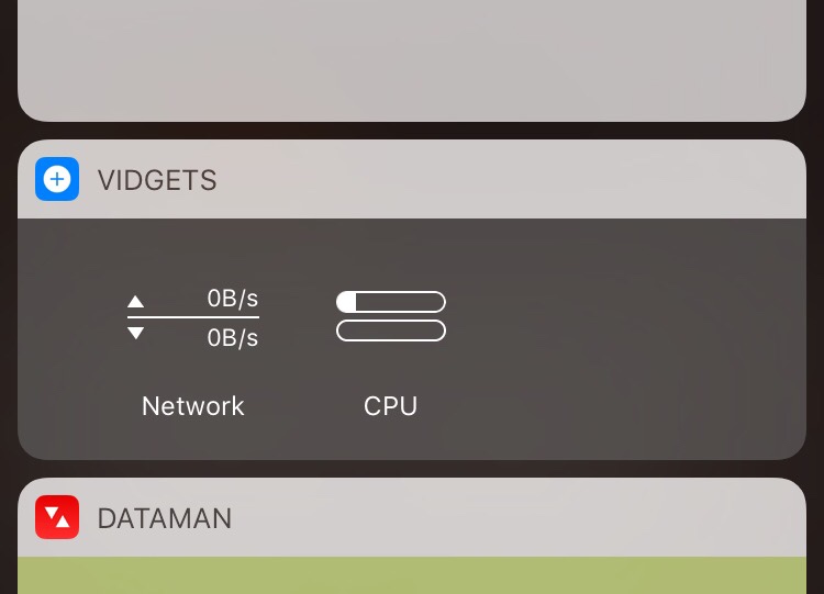

Download Vidgets app to see if something uses CPU. Idle usage should look something like this.

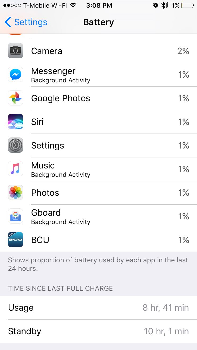

Good to know. My 7 is mediocre at best. Here is after what I'm looking like after three days of full usage and full charges.
