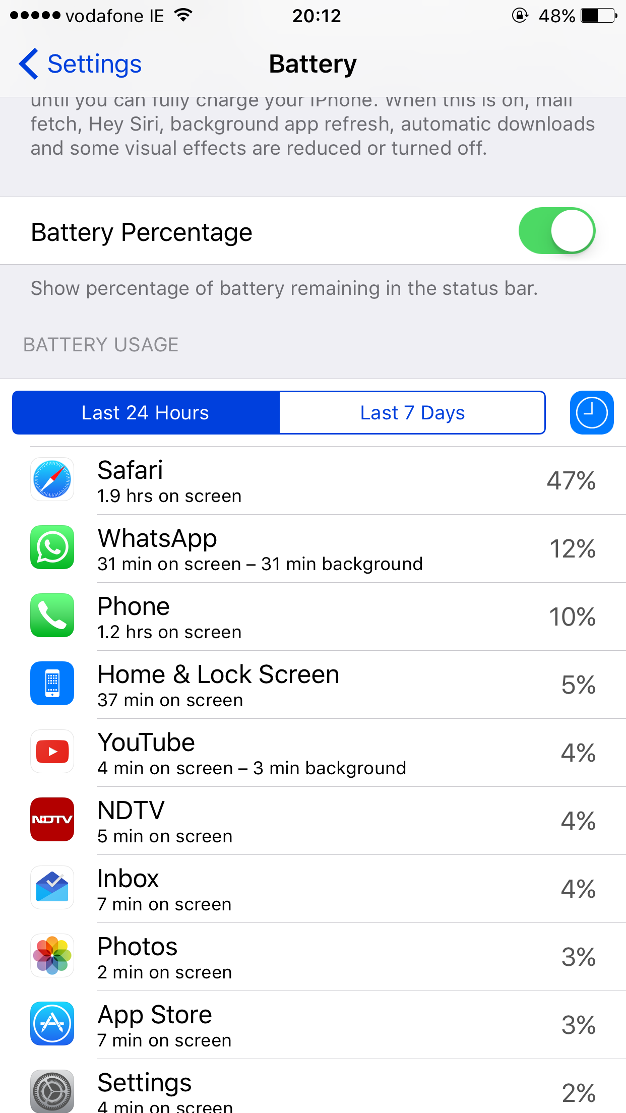

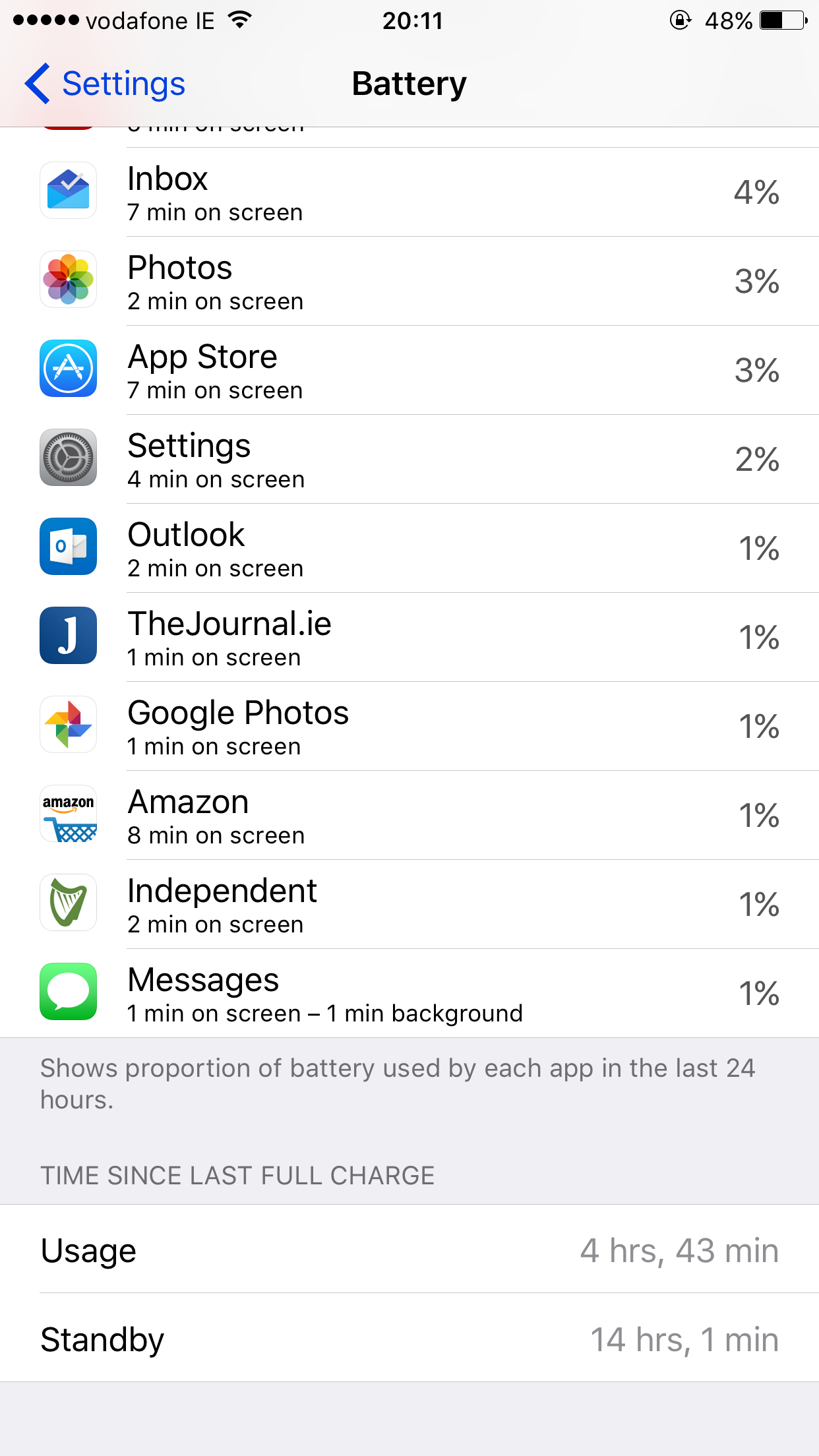

So just to give update on my battery since i updated to 10.1 beta 1 and calibrated my battery, getting great battery life from last few days!
No music involved, heavy usage!
You might want to let us know what phone you're using. It's kind of helpful in these types of discussions.

Actually I calibrated battery before updating, as with me and other users find out that battery percentage was way off, eg it took me nearly 1hr 30 min to kill last 10% of battery, once drained and charged to 100% over night, my battery was back to normal and since updating to 10.1 it is more improvement so highly recommend to calibrate battery first and see what you get!
