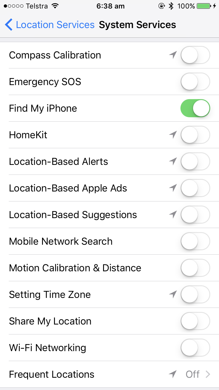

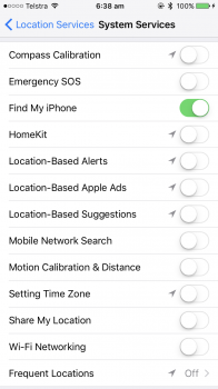

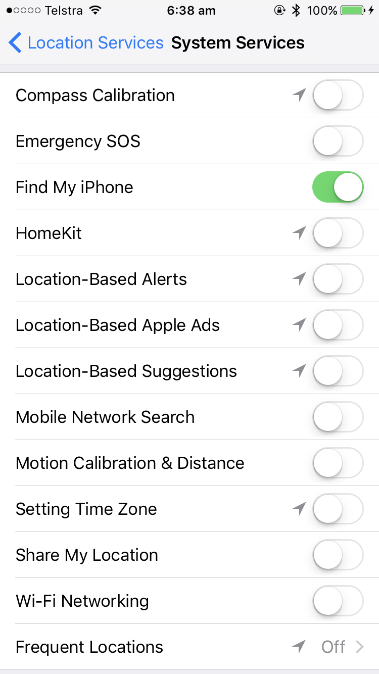

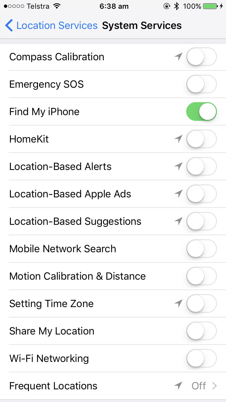

My location services settings for today (the only thing turned on underneath is routing & traffic)
Lets see if my standby times will improve..
Otherwise the app locations services are all set to "While Using" and the About to Leave function in calendar is also turned off.
